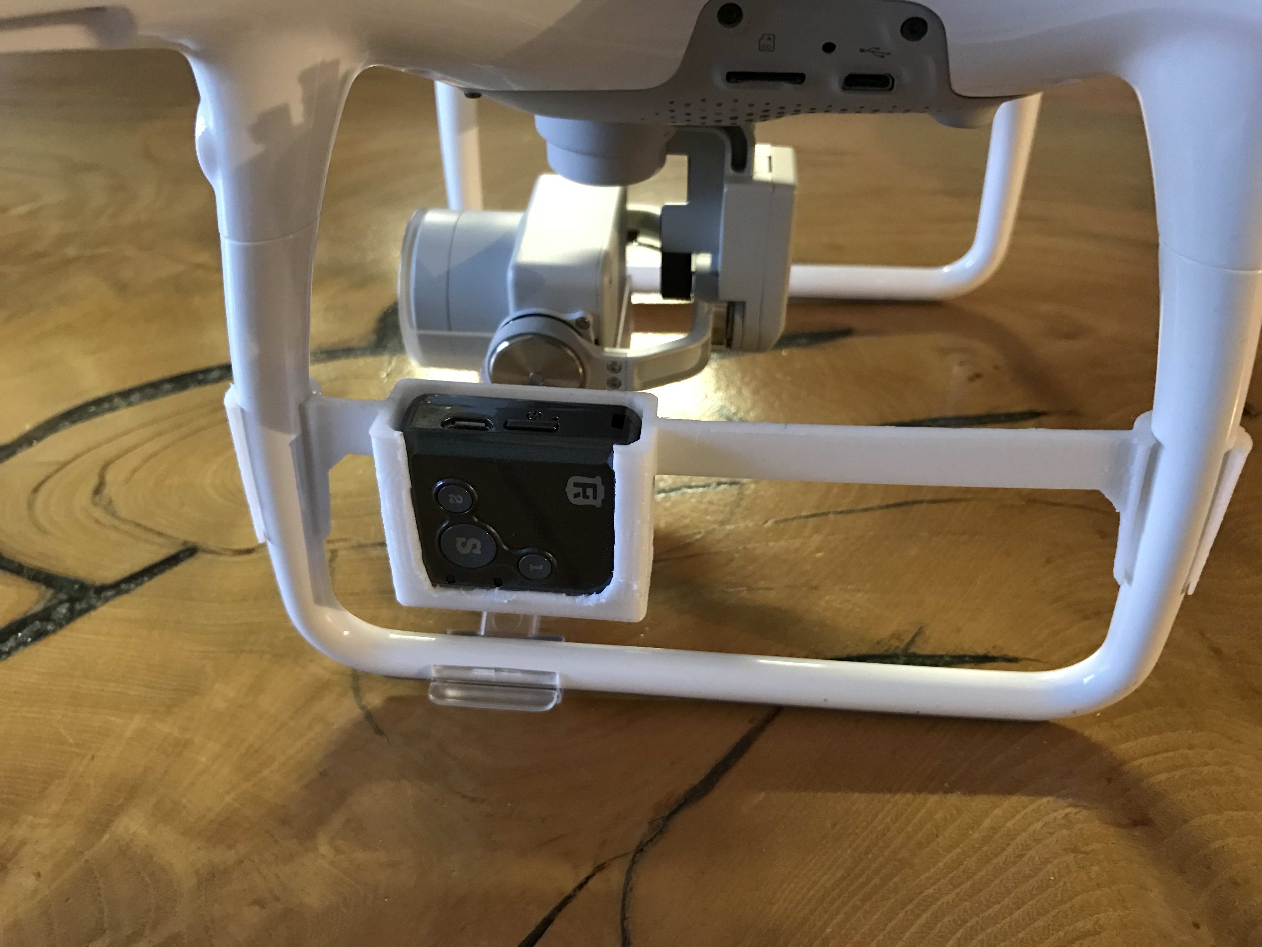

I will try it tomorrow, dark here now, one other thing I have not mentioned, it was my first flight with a RF-V16 tracker attached to the drone, I didn't mention that before as I would guess loads of other people would have flown with them before ?

Actually putting a tracker on the Phantom can change the local magnetic influence around the Phantom depending on where it is relative to the compass.
This may or may not have affected your compass.

I gave him the analysis from his DAT file but he hasn't done the tx file to phantomhelp yet. There was quite clearly something interfering with compass. But there were a lot of other failures in the logs too, making me think either tremendous interference, maybe from his tracker, or a hardware issue.
