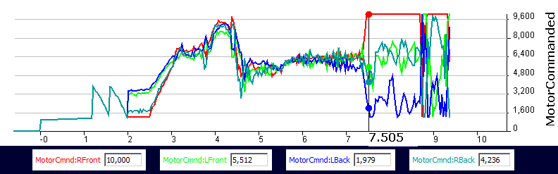

@Spappy I looked at this .DAT. Contrary to DJI's findings the most that can be said is that there was a loss of propulsion on the rightFront. It can't be concluded that the cause was a missing or broken prop. Since this is a P3 Standard there is no motorSpeed or motorCurrent which would be required to determine if the rightFront prop was missing or broken.
My analysis was based on the same data that DJ looked which can be seen on this DJI Forum post.
Worst customer service ever
IMHO the DJI analyst either knew, or should have known, that the data could not support the conclusion that the incident was caused by a broken or missing prop. All that can really be seen is that the rightFront motor was commanded 100% which would happen if either the prop broke, was missing, or there was an ESC failure.

The .DAT on the AC probably has all the data there is. But, CsvView/DatCon isn't smart enough to extract all of the .DAT data.
The .txt has less data than the AC .DAT but, depending on the .txt-to-.csv converter, can potentially yield info that CsvView/DatCon doesn't know about. E.g., gimbal orientation. The most comprehensive .txt-to-.csv converter is TXTlogtoCSVtool which is used by CsvView internally. Depending on the incident it's sometimes better use either the .txt, the .DAT or both.This particular incident requires the .DAT
About 6 months ago DJI added the .DAT on the tablet which is a subset of the AC .DAT. This has limited usage because it has a lower sampling rate. And, it often times has gaps because the data has to be transmitted to the RC and then forwarded to the tablet for recording.

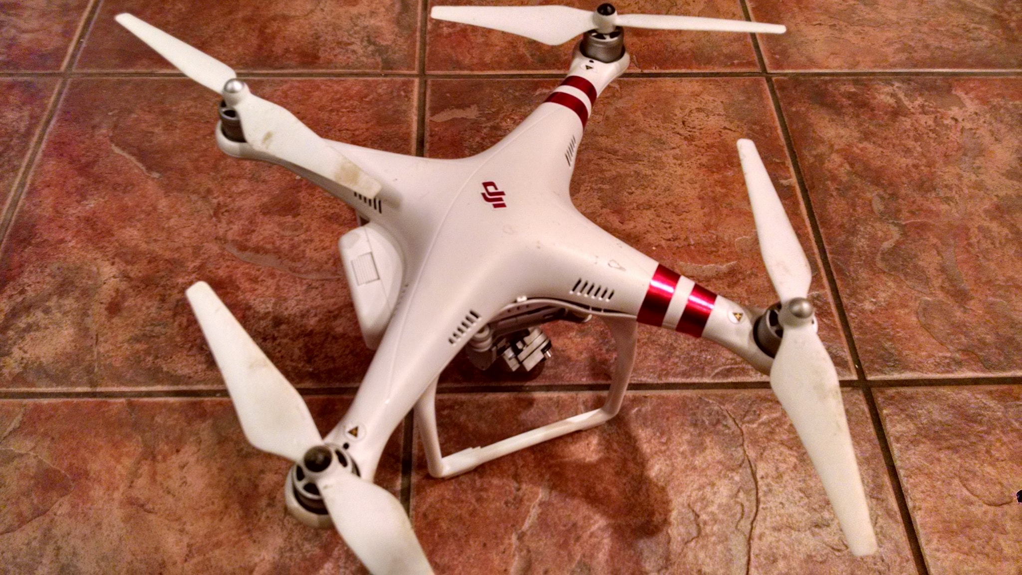

The props are fine, a little dirty, but perfectly intact. I can post pictures later when I get home.
