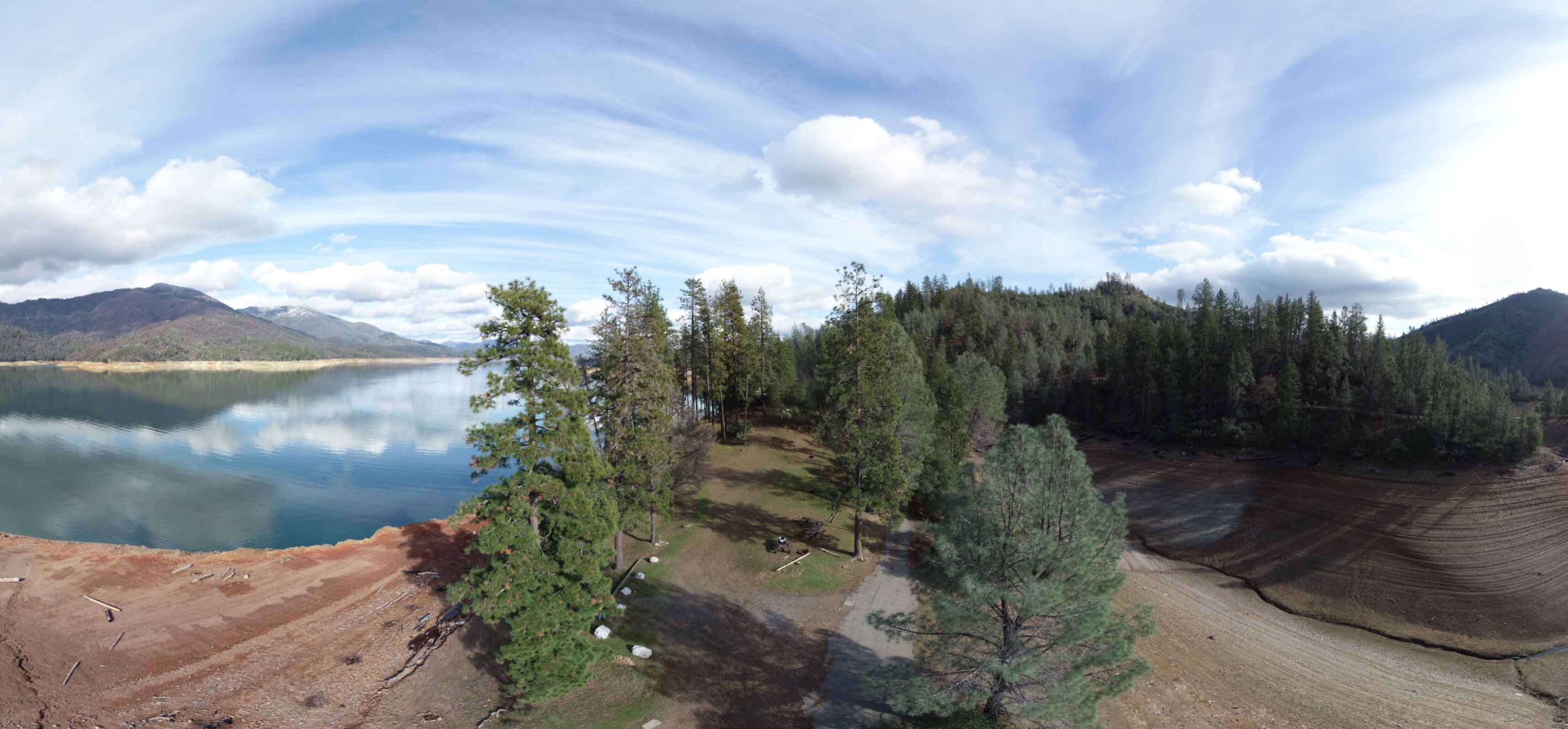

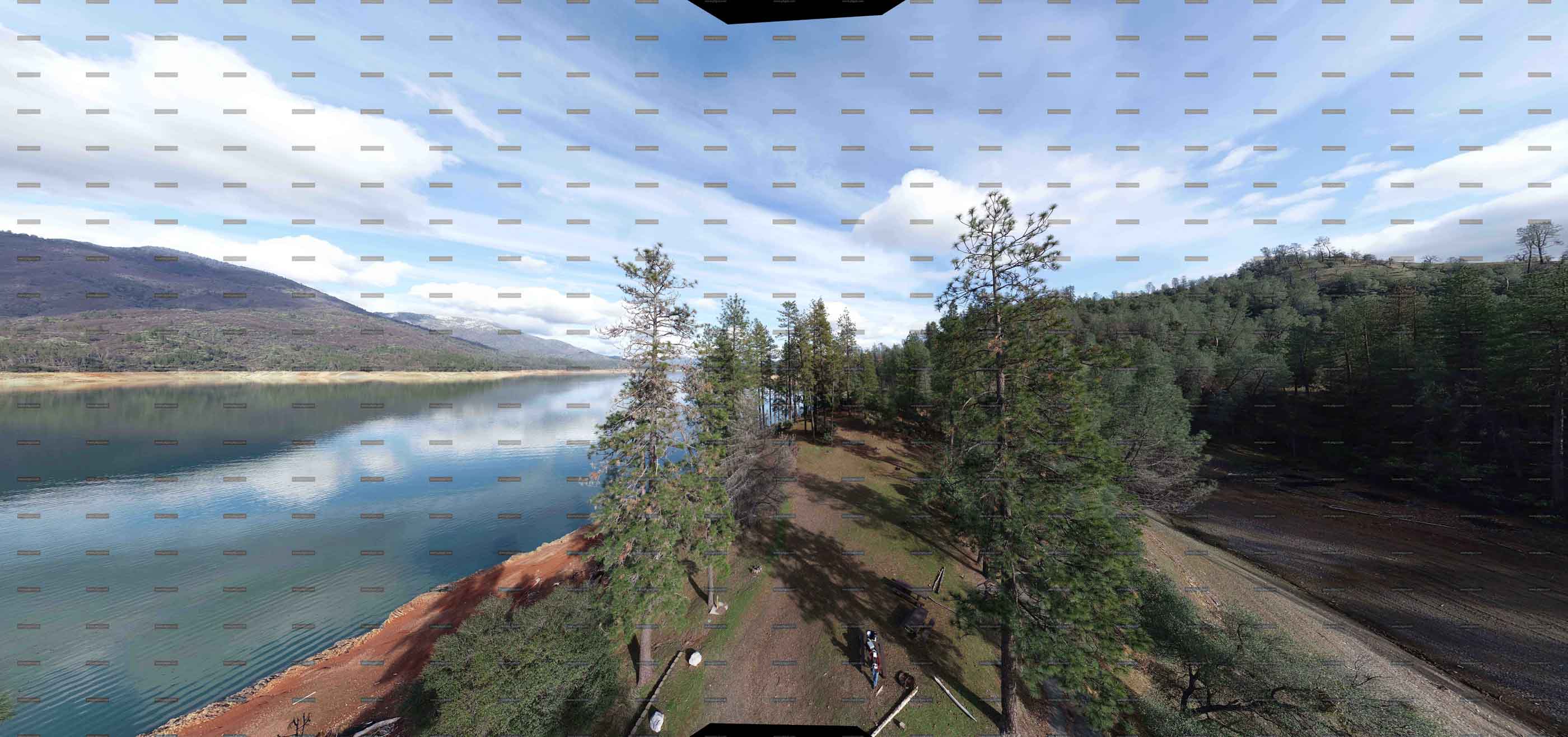

Just a follow-up. Here are two pix from Shasta Lake earlier in the year. The first is one stitched by the P4P and the second is the demo version of PTGui pro. I will probably buy the program(PTgui pro). When I get a new program, I like to see what I can do without reading the manual. It tells me if the program makes sense to me. I will read the manual and/or watch the videos.
I also fooled around with the stitching mode in Photoshop Elements. I think I could make that program work, but PTgui pro looks like something with a wider latitude of features. I do like the still shot features of Photoshop Elements. I used the full version of Photoshop for many years, and the early versions of Lightroom. They are both great programs. I have been working on getting my stills correctly shot in the camera reducing the need for post editing thereby needing a less sophisticated photo program. Big goal - some success. Anyway here are the photos.
Edit - actually as I look at the photos, I am not sure they were taken from the same batch. Oh well still a comparison.
Does the ptgui demo version show those marks on all of your pics stiched together?
The version I downloaded has the watermarks. It fine; I will probably buy the program. I not convinced I need the features of the pro version. I will have to take a closer look at the comparison chart.
