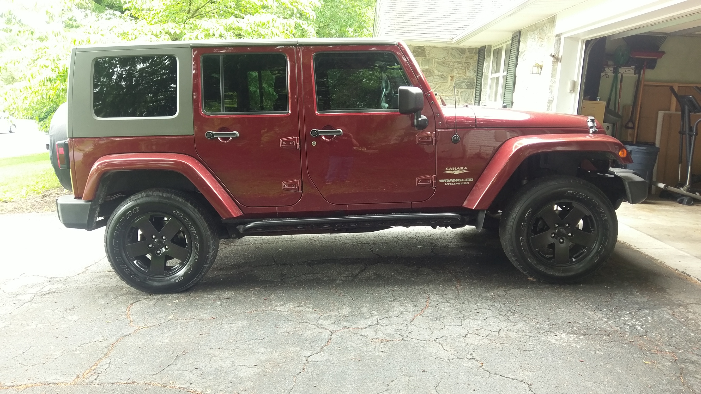

Here's my other passion, not as cool as yours.
just put some dents and rust on it, throw away the top and get a cat to pee on the inside.
easy-peasy
The best part about Jeeps is that the worse they look, the better they look
oh yeah, and I have a Jeep in addition to the bikes so my wife puts up with a lot but that's why I married her...she is very understanding

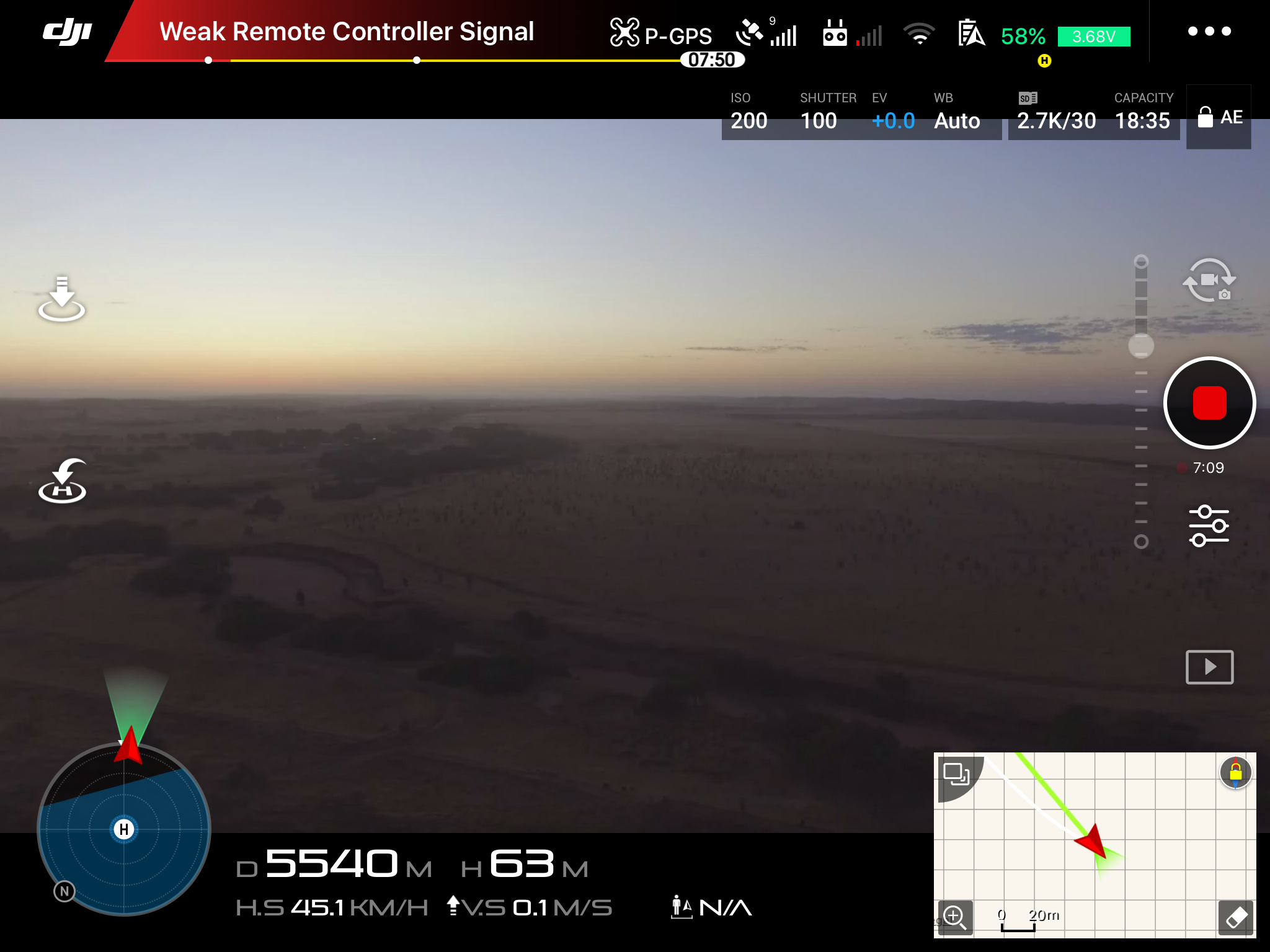

image.png I was flying my P3S this morning over farmland and I got out to 18,175 ft. All I have on the RC is a dbs range extender antenna (no boosters) so I think DBS Are awesome for more range!

yep video good most of the way got laggy towards the end...to get that distance condiions have to be ideal...like dead calm and of course no interference and sometimes if there is a bit of light cloud the signal is really good. Cheers
