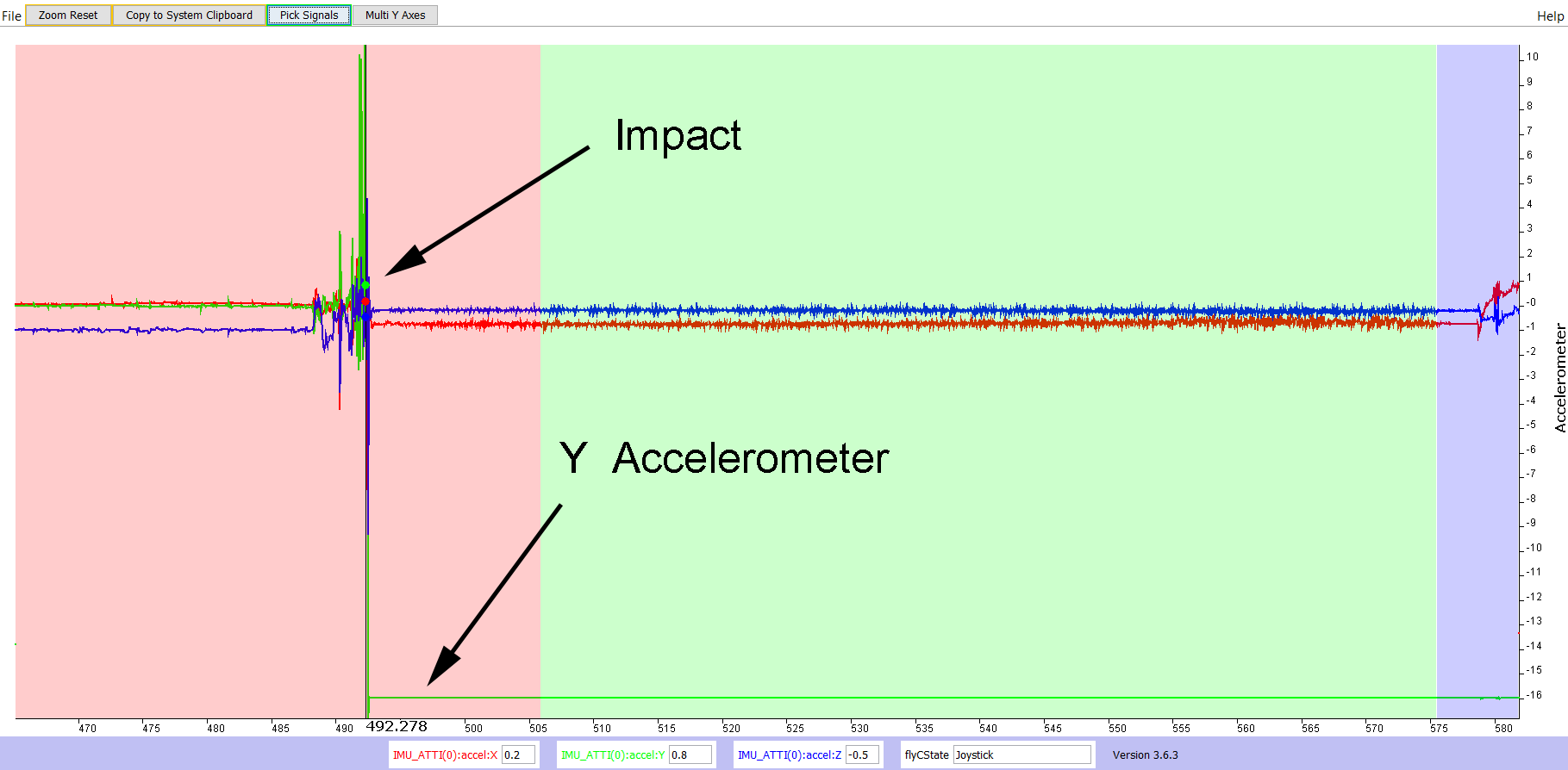

If you are curious as to what you did by the tapping, I went back and looked at the accelerometer data. The impact caused the Y accelerometer to stop working. I did not look previously because the impact was so noticeable via the attitude signals.
Thanks, that graph really illustrates the impact. Curious: What software did you use to plot the graph?
