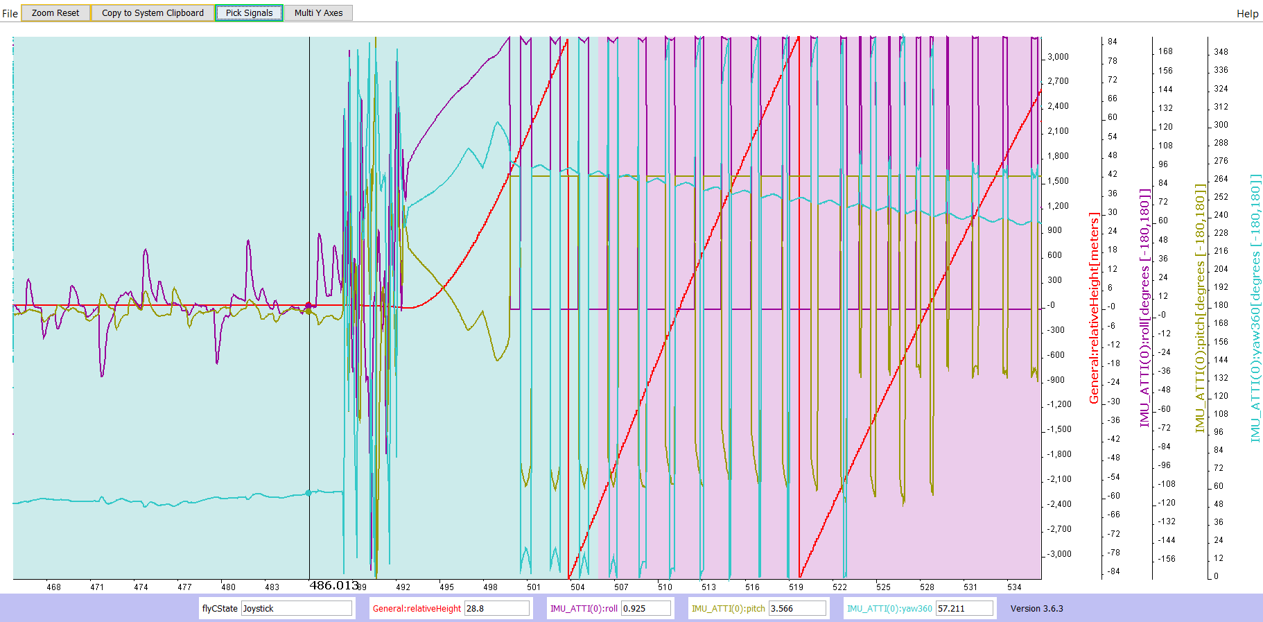

AirData is indicating that I was up at 3268m which is not correct and that the AC was auto landing. The AC was set to be at an altitude of 30m and distance of 17m. I think I got the correct DAT file off the AC, but when I ran it through DatCon and uploaded the csv file to DJI Flight Log viewer, I got an error message.

That was at the end of the flight after impact with the trees. Your altitude was 28 meters until impact. Basically an IMU concussion.

I suspect that the IMU was damaged upon impact. The post impact data is quite bizarre. That is most likely why the calibration is failing.
