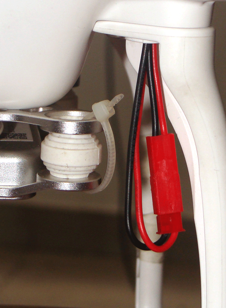

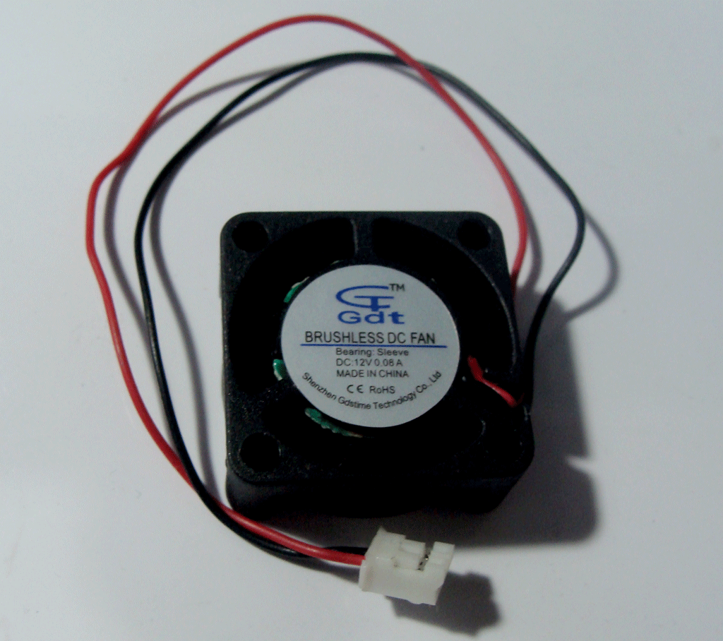

I installed a very little 12 VDC brushless blower in PV2+ (25X25X10 mm), along with a connector outside the PV2+ that allows me to connect or not the blower.
Powering it directly from voltage feed at nearest ESC.

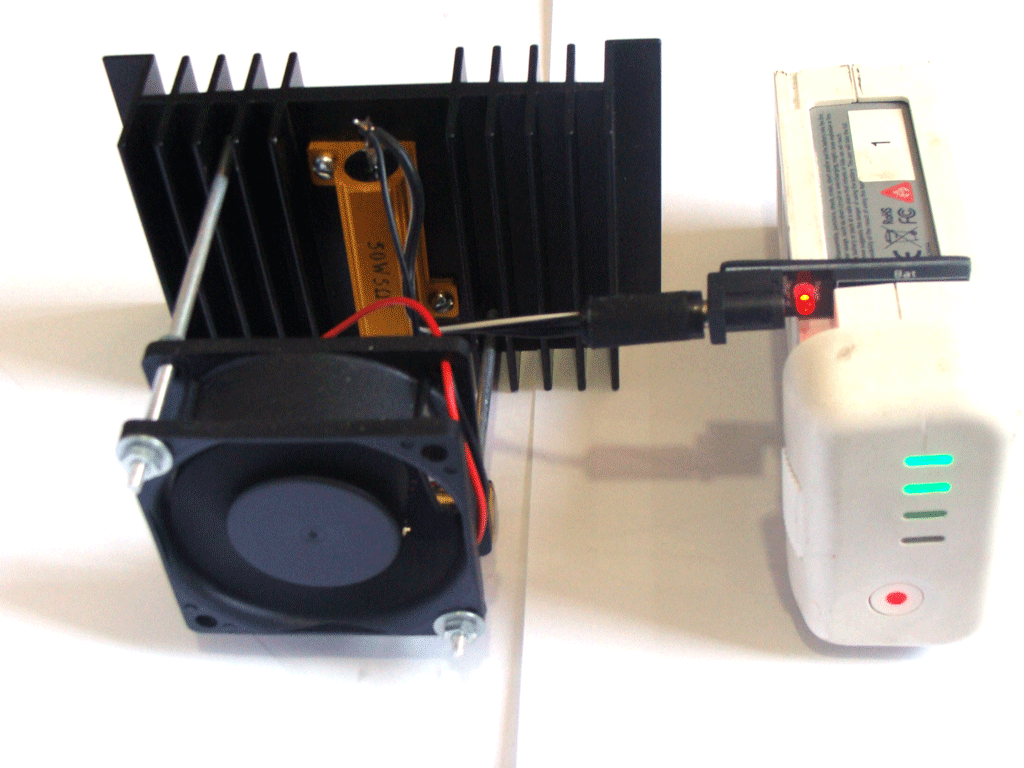

Also, to achieve the full (near) battery discharge between 20 charges ... i thought it is not a good idea to let the Phantom powered up until battery discharges....
So i constructed this "battery discharger" with a 5 OHMS 50 Watts resistor, a heatshinc and a blower to perform battery discharging.
It takes about 1 and half hour to discharge the battery.
