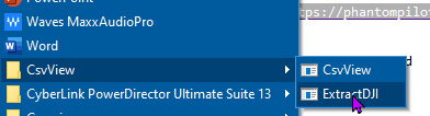

ExtractDJI will do this. It comes bundled with CsvView or DatCon. Down load and install CsvView from this site
CsvView Downloads
ExtractDJI will be available on the system menu
In ExtractDJI set the mode to Extract DATs
CsvView Downloads
Update from 2023.
The ExtractDJI file is part of the DatCon.zip (at least DatCon version 4.3.0) file and can be run from the folder where the .zip files were extracted to.
It still requires JAVA to run.
It was successful in splitting a file I had from 2019 taking a huge amount of space (1.7GB) on my disk. DJI_ASSISTANT_EXPORT_FILE_2019-06-26_23-25-12.DAT
