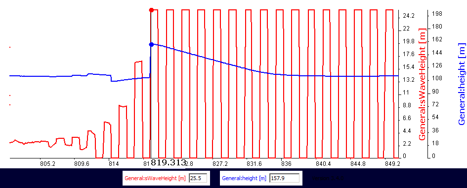

Yeah, it's hard to tell if the ultrasonic sensor spike coincided with height spike as would be the case if there was an underlying cause to both. Or, if height is computed from the barometer and the ultrasonic height.

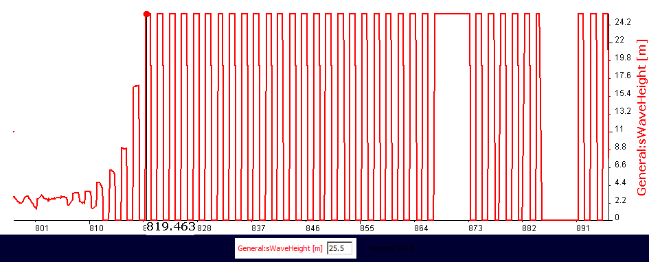

I had a related idea, but it didn't really make sense when looked at closely. The ultrasonic sensor glitches occur at exactly 0.5 HZ. 1 second on followed by 1 second off. I was supposing this was due to a radar rotating once every 2 seconds. But, then you wouldn't expect the on and off durations to be the same. Also, the onset of the glitches occurred with gradually increasing values

I took a look at this flight. In summary I agree that the problem is some kind of hardware problem, but I think it's more than just a bad GPS. There was also a SmartBattery RTH that didn't contribute any real problems, except making it more difficult to determine what happened. Kind of a perfect storm thing I think.
Looking at the ultrasonic height there was a glitch at 425 secs which by itself is not so unusual. The glitch noted by @Fly Dawg at 819 secs was just the first of many.
The regularity of these glitches indicates, to me at least, some kind of HW issue.
It's difficult to tell if the gpsHealth drop was due an actual increase in dilution of precision or some other issue. If you could retrieve the .DAT we may be able to determine this. Look here to see how to do that.

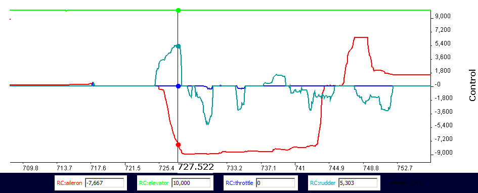

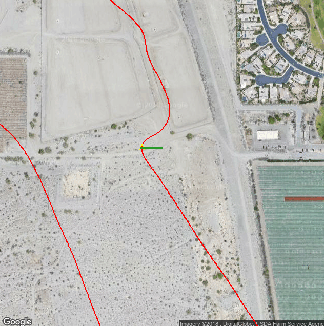

That right turn at 13:06 corresponds to this
Which was commanded by right rudder input.
How about at about 13 min 18 sec when it veers to the right, goes way over the dyke and over the country club, but, that's not reflected in the path from the kml file is it ? That was the turn that wasn't commanded. Also, I'm referring to the time stamp on the video, I'm not certain how that matches up to the flight record.
I was also referring to the video time stamp. I think it just appears that the P3 went over the country club. The video is showing what's out front of the P3 and not straight down.

The question remains whether the issue was confined to the GPS or was this caused by something that caused other problems. At time 819 secs there was the altitude anomaly. It's not the raw barometer that jumped. Rather it was the smoothed barometer value.
As I understand it the smoothed value is computed from the raw value and this would have to be some kind of processing glitch. @sar104 might want to take a look at this.
Finally, there were the ultrasonic height glitches that I described previously. By running DatCon at the highest sampling rate it can be seen that distinctive pattern is just an artifact. But, it still remains that the ultrasonic sensor was invalid for most of the flight.
