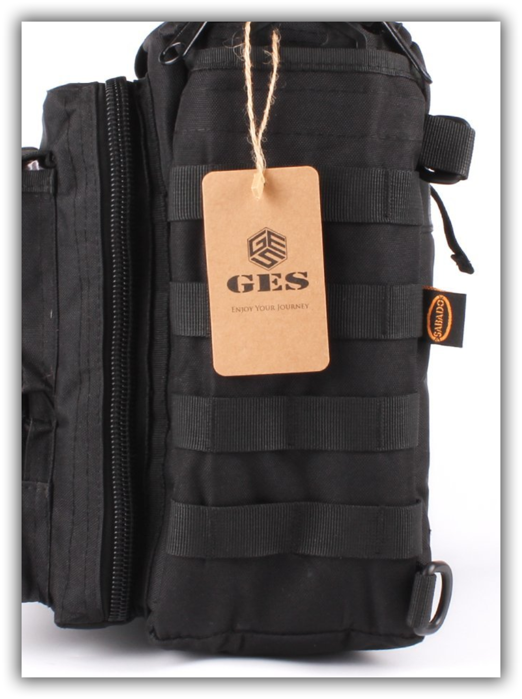

I have the V1 also, and love the bag. I've had it for 2yrs now and it still looks like new, and I do a lot of travel and local drone flying. The only problem I have found with the V1 is the battery compartments are in the top of the bag, and they cannot be moved, as the reconfigurable Velcro walls only work in the top half of the bag. Heavy items need to be in the bottom of the bag so the bag is better balanced. V1 is top heavy if you carry 4 or more batteries, IMO. You will notice this mostly when carrying the bag with one strap over the shoulder, which is what I do 90% of the time when I'm carrying it less than 1/2mi, such as through the airport, or short hikes from the car. The V2 (which I haven't bought yet) is nice, I checked it out at the NAB show last April. It has the battery location problem fixed, putting the batteries in the bottom where they belong. They also made the outer lid compartment of the V2 easier to access with no zipper, just a Velcro flap. I think the Velcro flap offers more integrity and safety because sometimes I won't notice my V1 outer compartment lid zipper is unzipped, and my iPad Air2 could potentially fall out. Thankfully that hasn't happened, noticing it unzipped before catastrophe, but I have left the zipper unzipped. The Velcro flap automatically flips shut and adheres with Velcro. The V1 also has two handles, one on the side, which the V2 removed. At first I was disappointed they remove that second handle on the V2, but I noticed that I rarely use the side handle. They said the handle removal was to save weight, but both bags weigh the same if you believe the specs, 4.6lbs. The only improvement I'd like to see is adding Mole straps, sewn to both sides of the bag for expansion compartments if I get in a pinch to need more storage, or special compartments for small stuff with quick access that I don't want inside the bag.
The Mole strips onthe side of this bag is what I'd like to see in a V3 Helipak.
