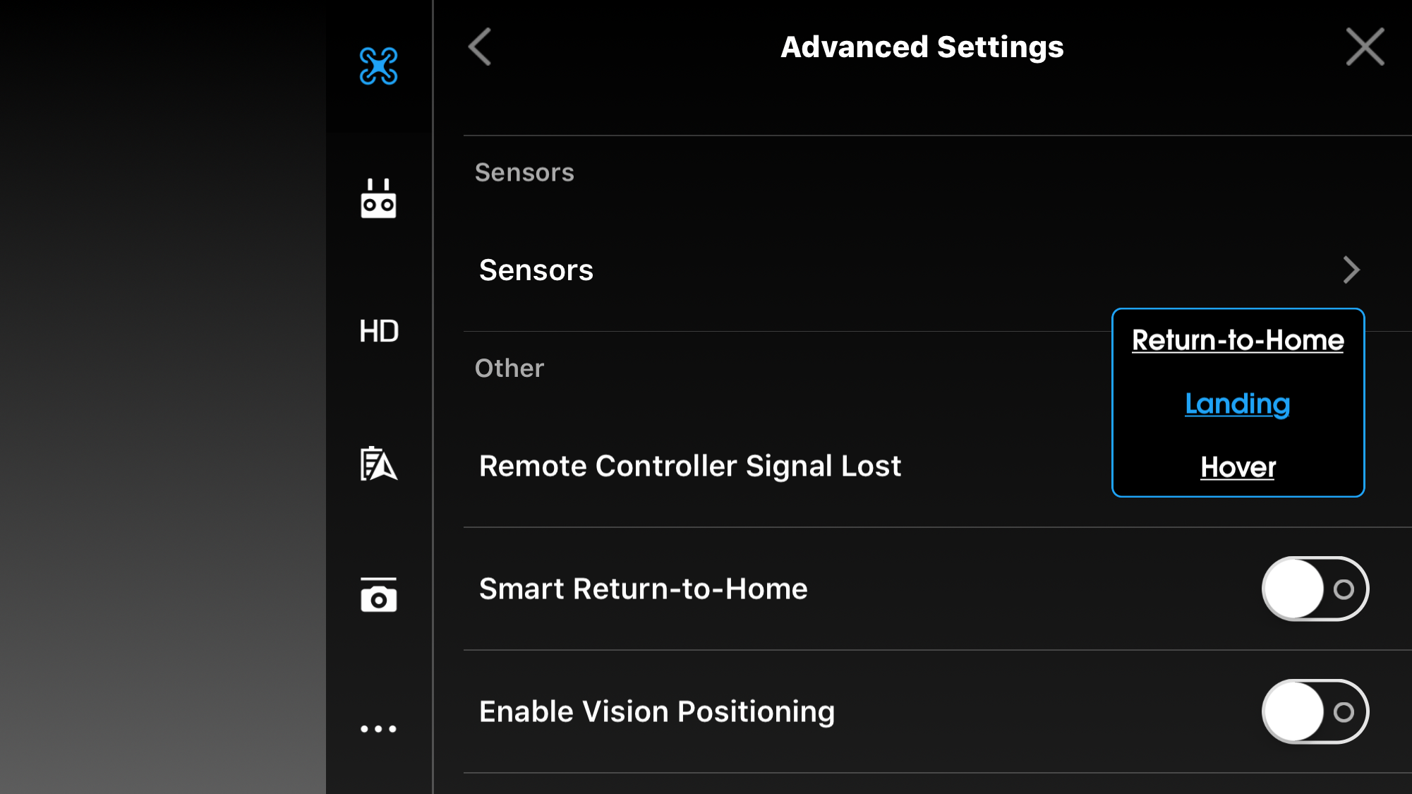

If I had a guess I would say your RTH incorrectly set maybe nothing wrong with unit itself?

have any thing to do with this setting?

It was set to RTH...
After reviewing the playback, it did acquire a home point... The bird was unavoidable, my loss..
