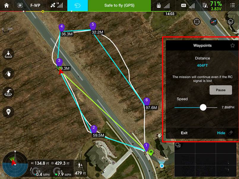

The screen that pops up when you accept the mission tells you how RTH is initiated and it's not by loss of controller signal. It's low battery return to home. If you've got that set so you have enough power to get home there shouldn't be a problem
In this screen that pops up when you start a waypoint mission. It explicitly states, "The mission will continue even if the RC signal is lost". I take both these to mean that auto RTH due to loss of controller signal is disabled.
It's possible to plan missions in waypoints and POI where the bird is out of LOS of the controller. If that's what you want then you wouldn't want the mission interrupted by the triggering of auto RTH due to loss of controller signal. Autonomous means that the bird can fly the mission without any input from you through the controller.

This. In autonomous flight mode you should be able to turn the rc off and have the p3 complete the mission.
There is some question, though, about rth at low battery. Some have suggested it doesn't, but just lands at the critical battery level. This is the functionality with Litchi, but I've not seen it confirmed in DJI Go.
