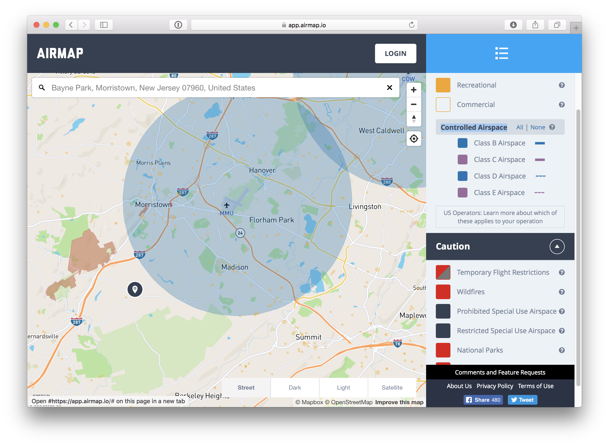

edit: Adding - I realize the log says I'm in a Class D warning zone; I checked with AirMap before I flew (which I trust more than DJI's database) - and ... ...
