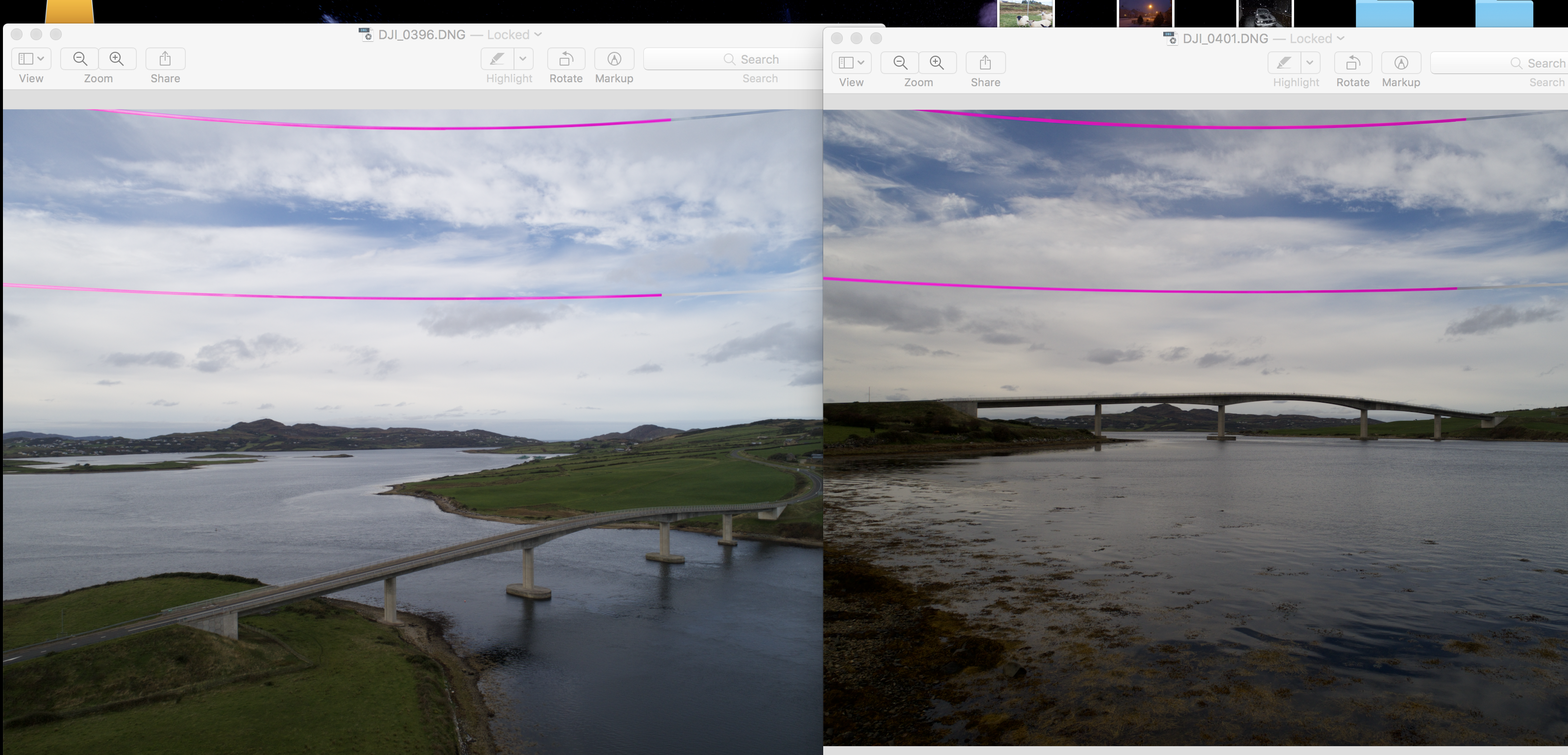

Last two times I flew my P4P I've had problems with the photos.
I've attached a couple of screenshots.

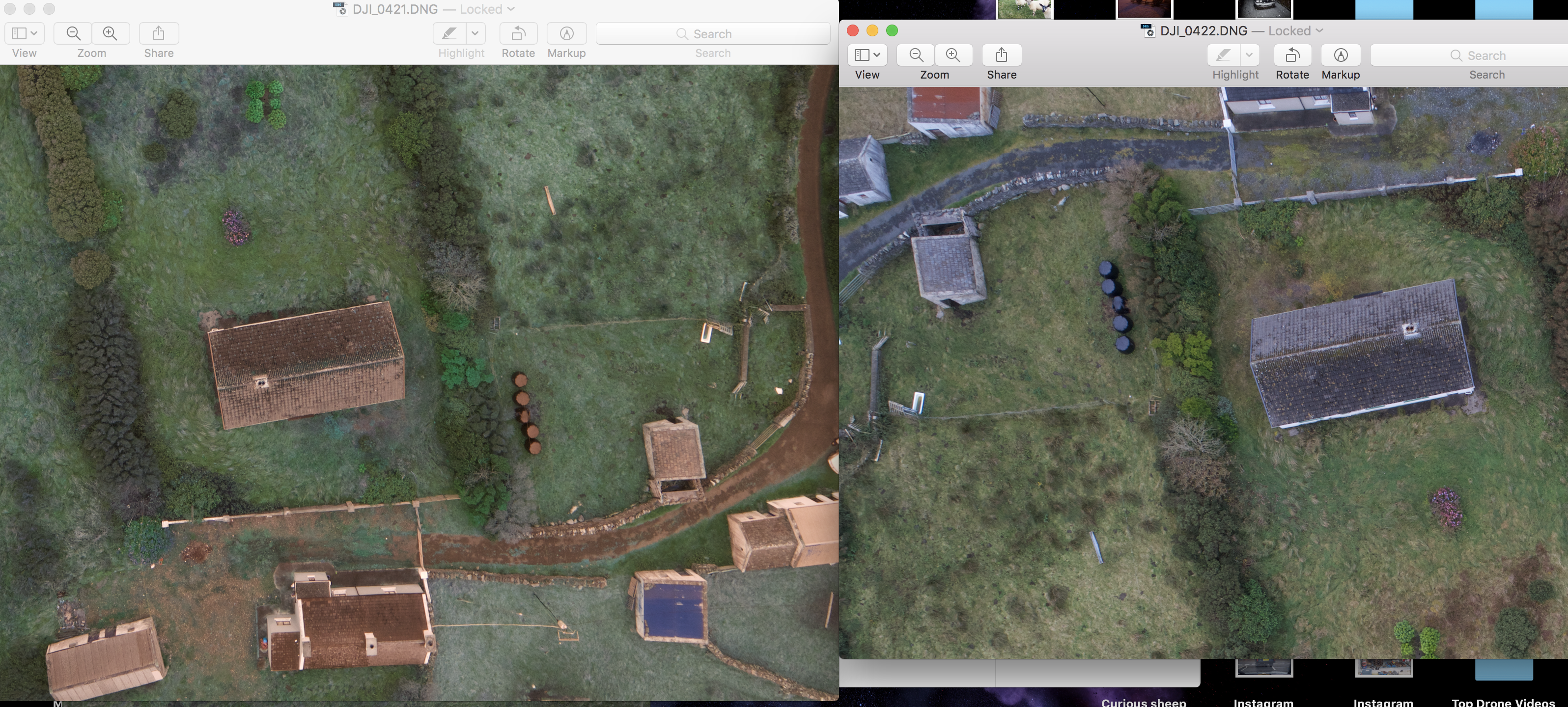

I'm shooting in Raw format and haven't had any problems until now. The 1st screenshot shows the purple/pink lines going all the way across the photos and this happened to every picture. Next time I took pictures the colours looked very strange with blacks coming up cream colour and grey looking brownish? Out of the 6 photos I took only one came out the correct colour and during that flight, the view on my iPad flipped the opposite way to which I was flying?
I contacted DJI online chat who said to calibrate the gimble (haven't done it yet, don't see how that will help)...Has anyone else had the same similar problems? The videos came out ok...
Images with pink lines...

Normal colours on the right, flipped and strange colouring on the left of the screenshot?
The lines could be write errors but the flipping of colors is strange.
Only things I can think of to try would be to reset the camera under the main camera setting tab and reformat the card in the drone. And try a different card.
