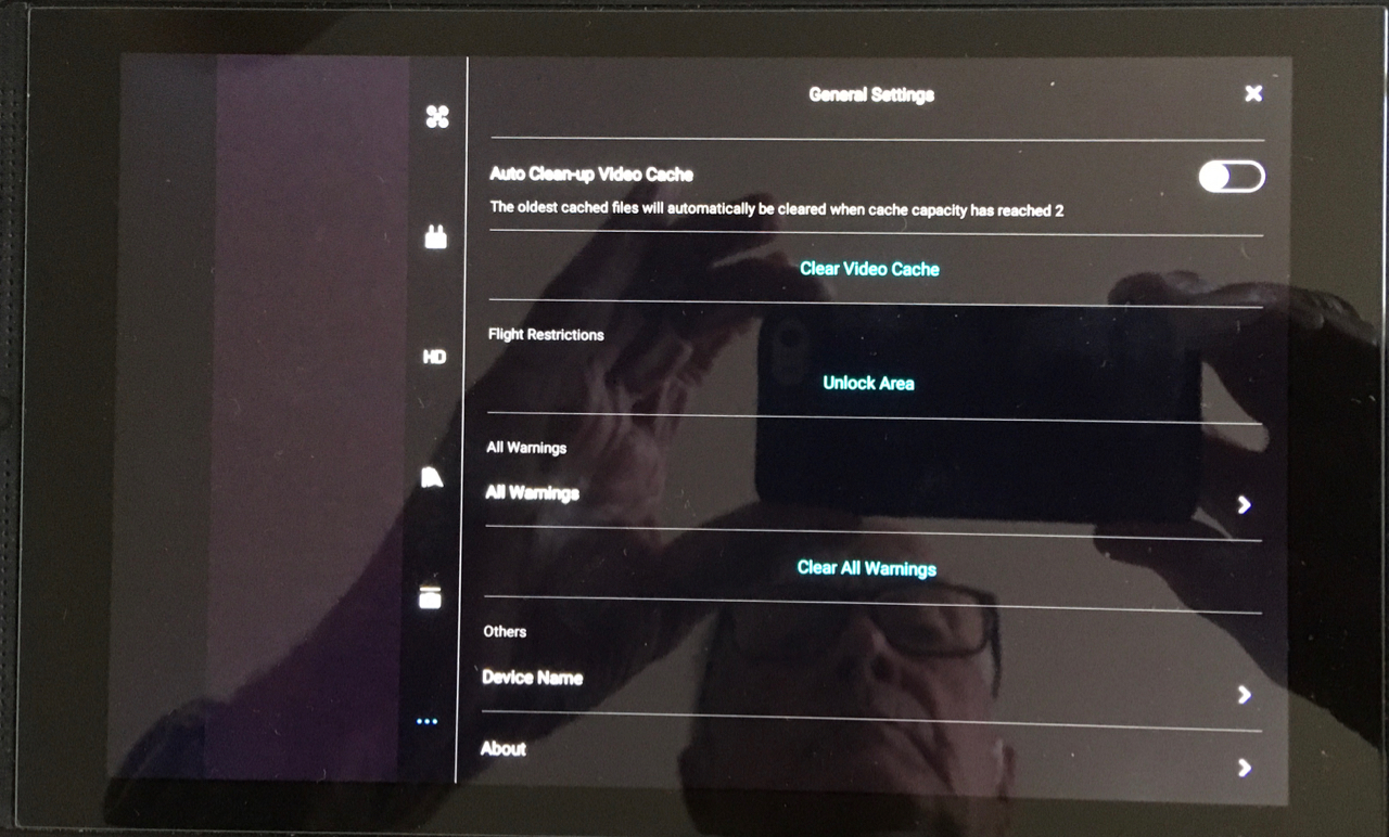

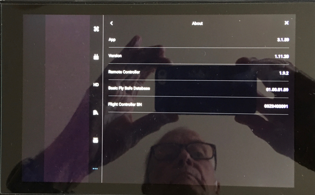

So when you turn on the RC and plug in your iPad, can you run the Go App? If you can you should be able to go into the menu and see what firmware you're running on the RC.
Frome home screen, tap the three bars at the top right of screen..............
Scroll down to last option - "About" and tap that.............
Then you should see the firmware version for the RC and the App version......

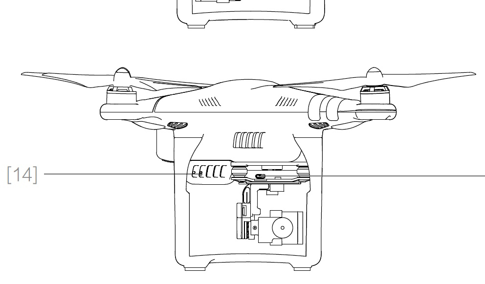

Now you need to relink the RC to the AC..........
Turn RC and AC ON
Press the link button (14) on the AC - it will blink RED when AC is ready to link
Press C1 and C2 and the RED record button on the RC - the RC should BEEP.
Let go C1 & C2 and press the RH side wheel - the first (LH) light on the RC will turn BLUE and the RC will constantly BEEP _ . . _ . . _ . . (D in morse)
The RC will stop b beeping and the link light will turn GREEN if linking is successful.

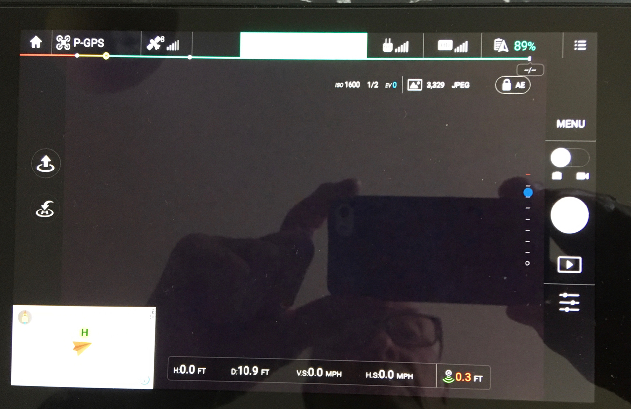

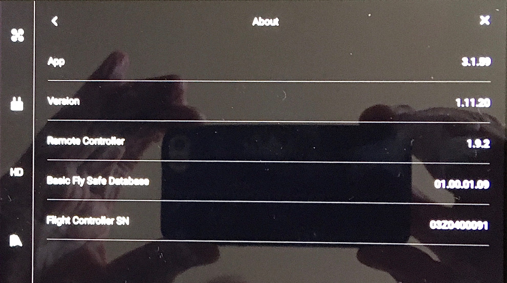

Funnily enough I thought I'd had a problem with the latest AC firmware, 1.11.20 and had downgraded to an earlier version, so was surprised to find that I am in fact running it and, touch wood, everything has been very stable.
