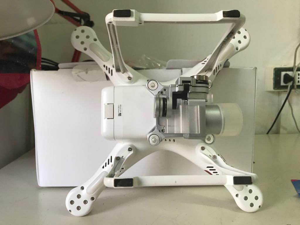

on the packaging there is written standard phantom 3Ok um does your drone have vs module underneath it,,if so it is a p3se if no unit it's a p3s,,,,,I'm tend to be thinking this is p3se
thank you Ianzoneon the packaging there is written standard phantom 3

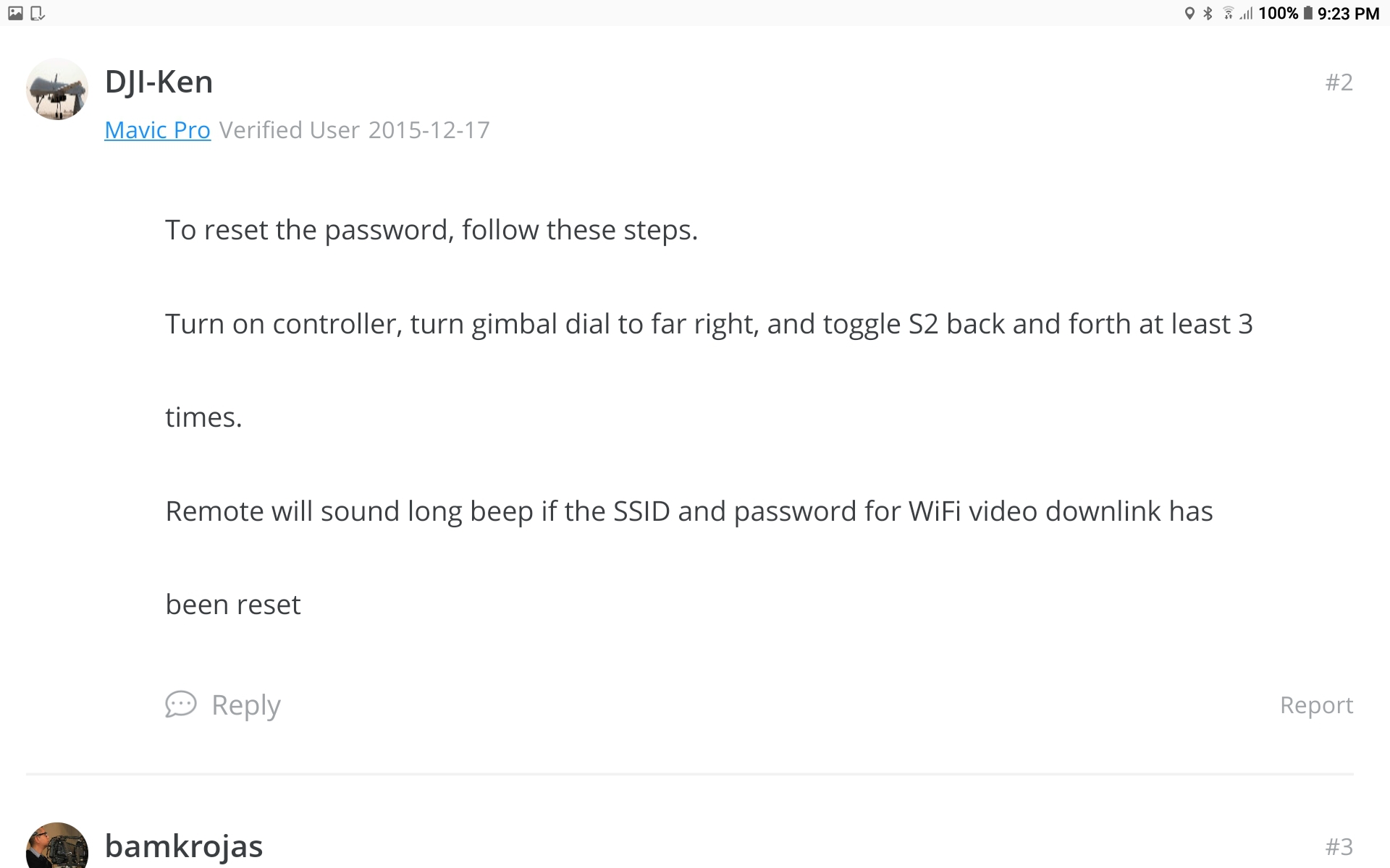

tried but nothing to do: (Here's another thing to try,,,,you can try reinstall app and maybe another device to try to eliminate fault on that part,,,me have to pick up I got stuff everywhere and can't move,,if something comes to my crazy mind I post it,,,sure this is something simple but can't clickView attachment 113216
