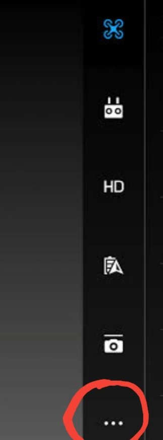

Open app click on general settings and browse down to dots shown in pic ,,that's the ABOUT part and show what versions you have on fly safe,rc and firmware installed
Little while ,long while ,any while drones dont like,,sorry my explanaining not the best,anyway that's where version us found,,
So did you find versions installed
