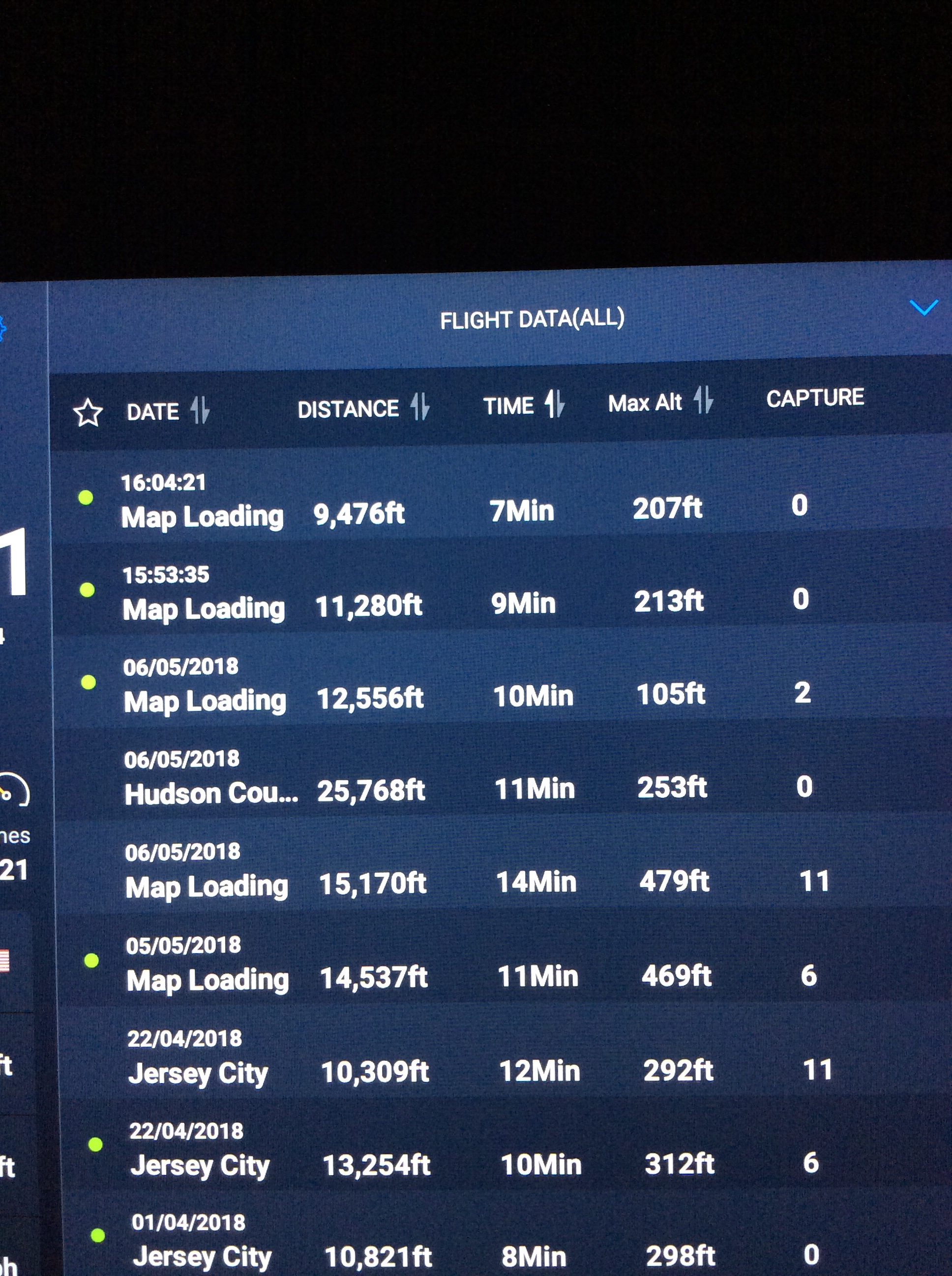

A question though on a different matter in my flight records all previous flights were recorded by "Date" but these last few flights are being recorded by the "Time" I launched is there any way to fix this in the settings...

Look at the top two they’re time stamped and the rest are date stamped , they’re mixed .
The top one are with me using the CS display(Ultra) I had a (High briteness) but I returned it cause after I updated the firmware in it it stopped recording flight records so I’m staying with the firmware that was shipped with the CS but this is the only thing I noticed that’s “not right”

I don't know for sure but check those flight recordings tomorrow and see if they don't switch the date stamp. May be possible your most recent flights in the same day are time-stamped but once you enter the next day on the flight records and may switch to date stamp. Kind of like emails and text messages will do the same thing.

Yes your correct that's how it works, it changed to " Yesterday"this morning and I'm guessing tomorrow it'll be dated..

The top one are with me using the CS display(Ultra) I had a (High briteness) but I returned it cause after I updated the firmware in it it stopped recording flight records so I’m staying with the firmware that was shipped with the CS but this is the only thing I noticed that’s “not right”View attachment 99082
On your screen cap.....Mine used to give the county that i was droning in...Now for quite some time.....i Only See "map loading" like a few upper ones in YOURS...why is it that way now........I loved it when it listed the county and have i done some thing to change that ?
Hmm, on my end that looks like a Droid thing I just checked my flight records on the CS which is the photo above which has the "map loading" location listed which after checking where I launched at was either a City park or a location within the city , and if I launched within a County Park it would be listed as Hudson County
On my IOS flight records things were a little different sometimes County Parks were listed as the town they were located in sometimes just the County but NEVER listed as " Map Loading" that I only see on the CS
Mines been the same for a while now.
I haven't updated for about 18 months so it's not that?
