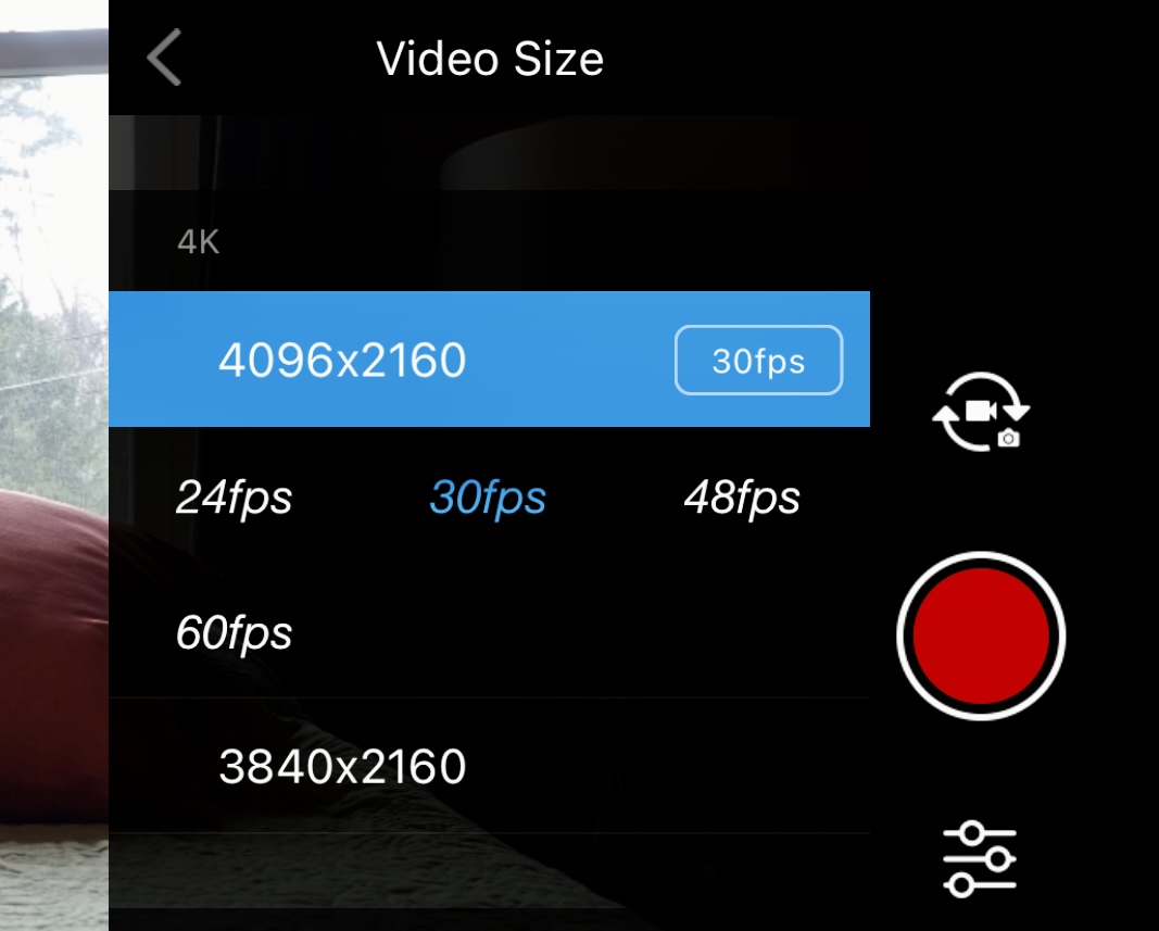

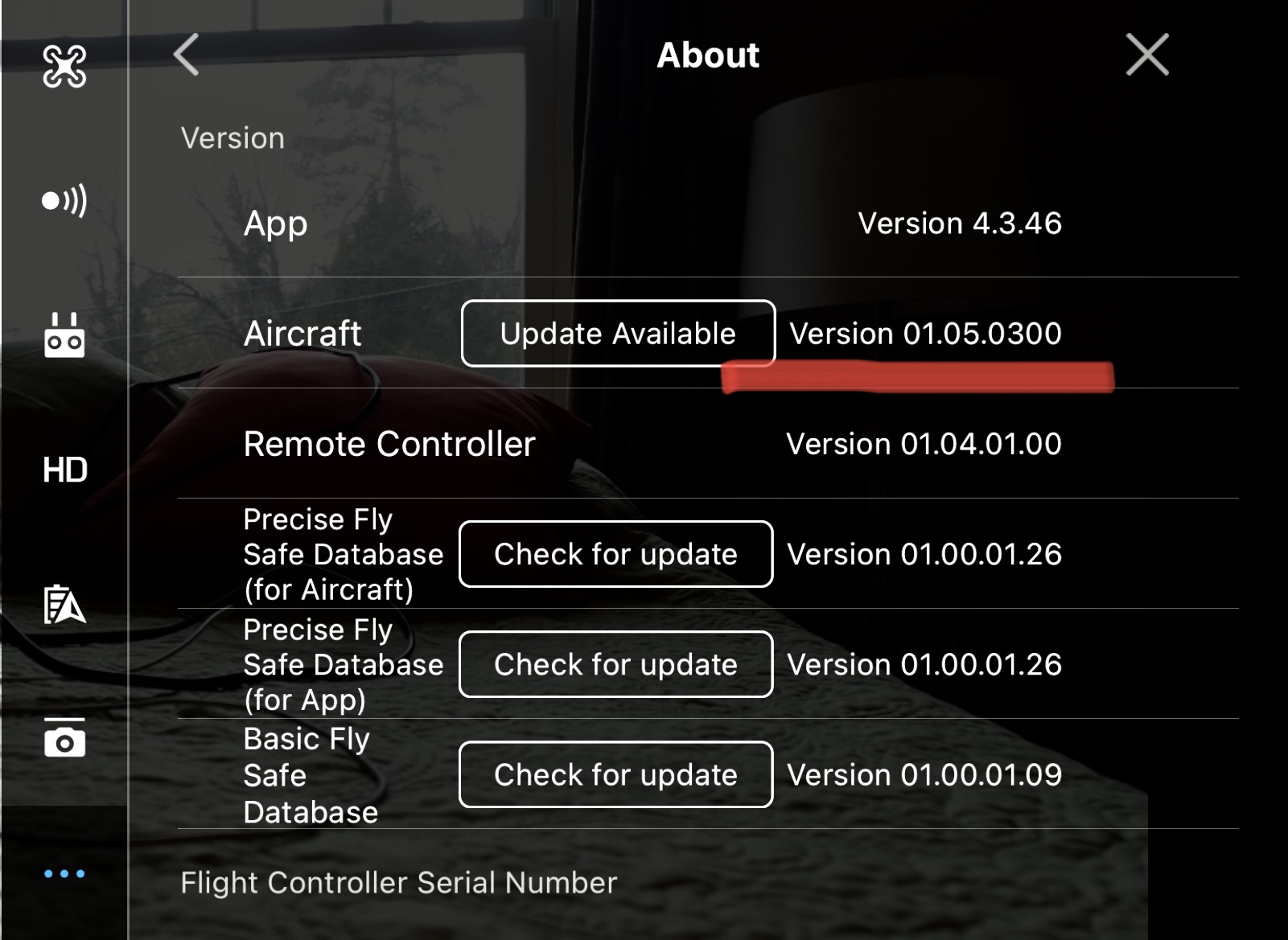

Ended up rolling back firmware and appears to have fixed the problem. Gonna try to flash latest version eventually.
This smelled like a firmware update SNAFU. I was planning on asking if you updated recently. Except I thought someone reported it a year ago.
Have had the issue for several months but just lived with it. I had previously did a factory reset then reinstalled latest firmware which fixed it but after awhile it acted up again. Could not get that process to take again. The rollback worked but would like to use the latest version. If it’s corrupted after flashing current version, I’ll be at a loss.
Just curious, what’s in the new version that you’d like to have?
01.05.0600 or what ever is current. Like to stay updated for bug fixes even though new versions can be buggy as well. Don’t like the update nag either but some people claim they can’t take-off til they do the update.
