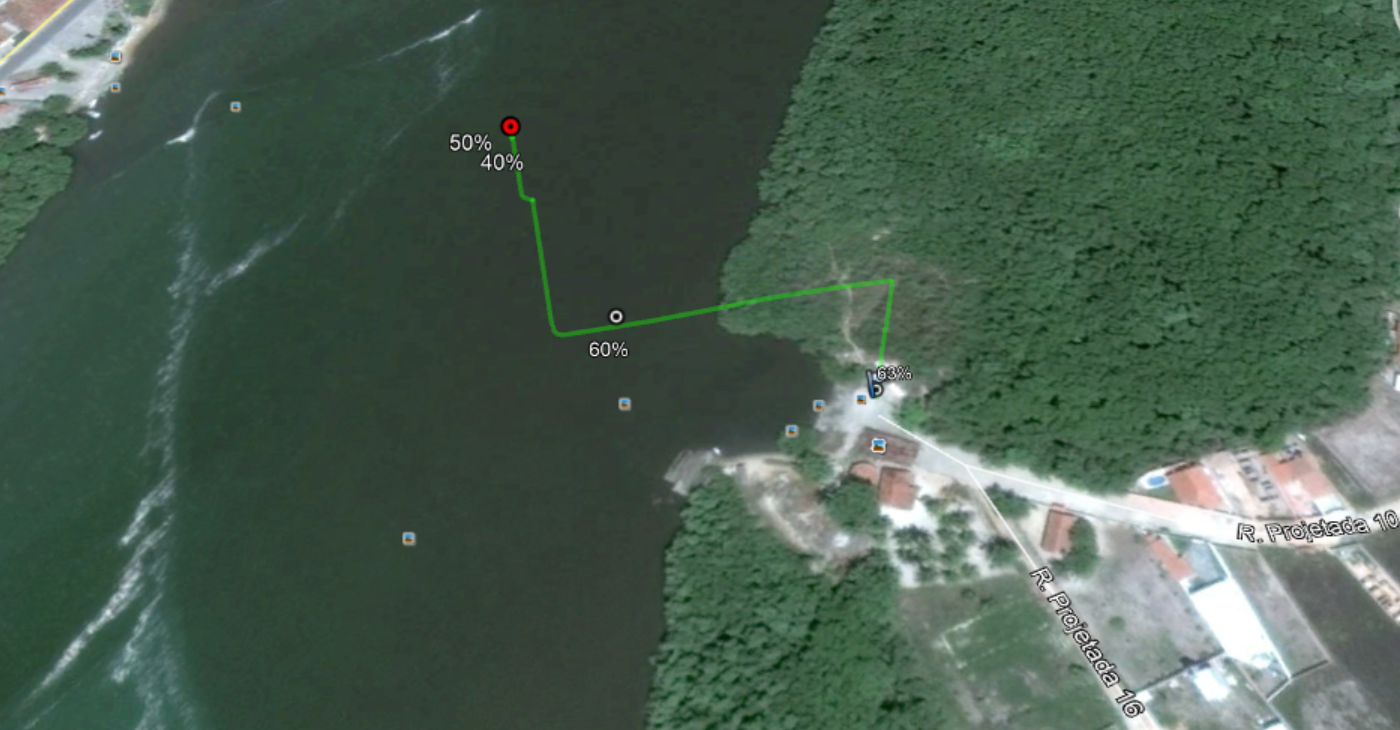

Are you certain this is the correct Log? The maximum distance is no where near 800m, its only 390 f
eet. I see nothing in this log out of the ordinary except for a brief signal loss. Evidently you closed out Litchi and that point and switched. But the distance doesn't match your description.
On a second note, you only lost signal ( Per this log) for 1.4Seconds. That is not long enough for auto RTH to initiate.
Are you certain this is the correct Log? The maximum distance is no where near 800m, its only 390 fView attachment 94075 eet. I see nothing in this log out of the ordinary except for a brief signal loss. Evidently you closed out Litchi and that point and switched. But the distance doesn't match your description.
Yes it is the log. I am sorry, I put a lot more on the distance. Yes you are right. At that point of fly I switch to DJI GO 4 because my iPad screen become black and the phantom did not respond to any command. Weird not?
Not odd at all. You simply lost downlink from the aircraft for 1.4 Seconds. In approximately 2 seconds RTH would have initiated, however you regained signal at apparently the exact time that you closed Litchi. Had you waited for that last 1/2 second or so, you would have regained downlink or RTH would have kicked in. This is just a guess, but from what I am looking at appears to be what happened.
Just to clarify what I said about the downlink. You should have manual control of the aircraft even after downlink loss. As long as the RC uplink is still good. I saw nothing in the log regarding the uplink, so was basing this on a guess. RTH will occur upon complete signal loss of 2 seconds.
