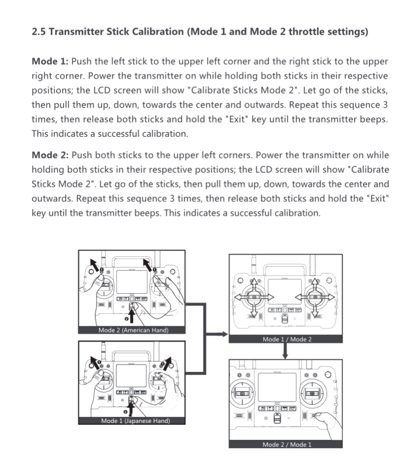

Have you got the "GPS hold mode" turned on ?
It the switch on the left side of the controller, nearest the top of the screen
also have you tried a control stick calibration

Thanks, that's kind a why I went with the learn to crawl before you walk drone. it's logged as 100% pilot error, lack of understanding "normal"
