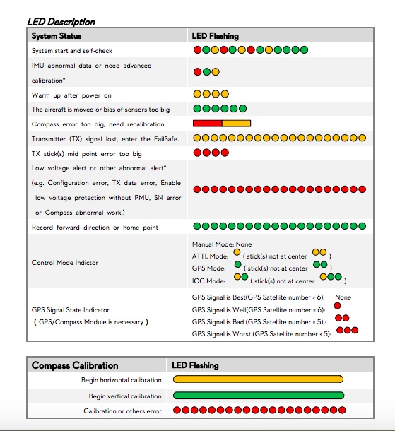

so just plugging in a battery and booting it up, had a normal boot up time and beeps, rear lights during warm up flash red-green-yellow, then after warm up have a long red light and several yellow flashes. i know there are error codes displayed by the lights but i cant find what each one means for the P4. any help on this? it may be noted that i live in the big nono zone right next to an airport so it may be that im just grounded.
Reactions: Dr_VonDuck
This is awesome! thanks for the link.
