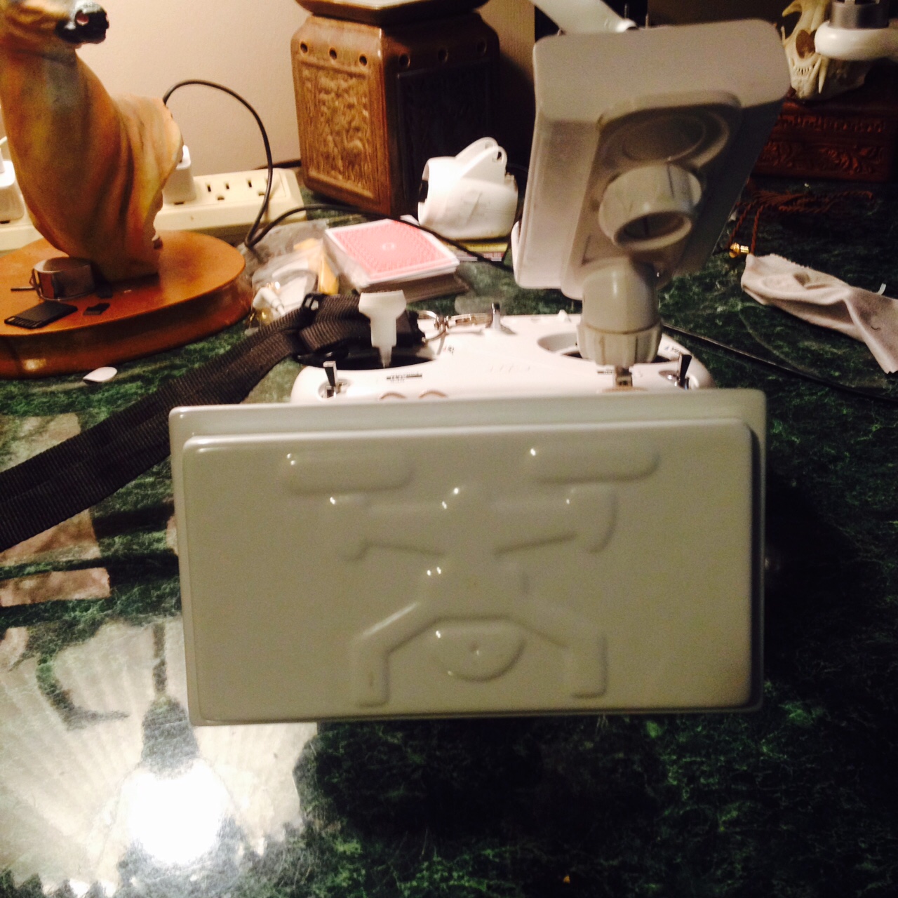

Good antenna for the money porky but the only issue I'm having and you will too is that the 2.4 ghz antennas are in the sides of the camera and you have just now covered one up with the RPG. Still for the money I am staying with this one . ;)

Reading your post regarding your new antenna, is it worth me getting one then? Didn't think about the camera antennas being covered by the RP... Bit of a bummer! In your opinion is it still worth getting?
