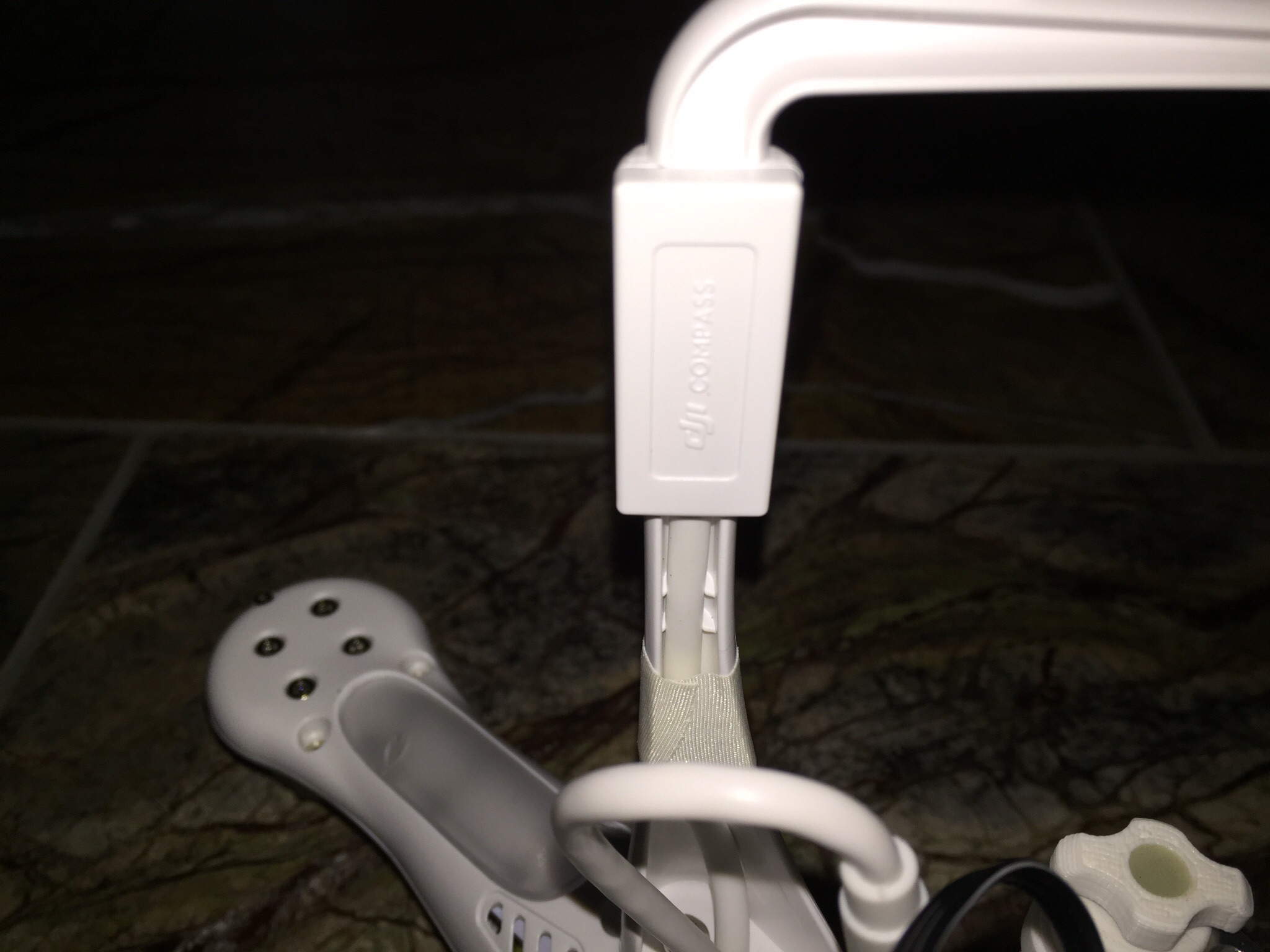

Have you got the new type compass or the old type? The new type is in a housing that's attached to the landing leg, see attached pic. That's what I've got.;)
well mine doesnt look like that so im assuming mine is the old one, think that would make a difference?
actually just went out and tried it right now, guess the new software is more touchy, never really thought about it before but was trying it in the driveway, lots of rebar in the concrete maybe, took it to the back yard no more red lights lol yahoooooo
