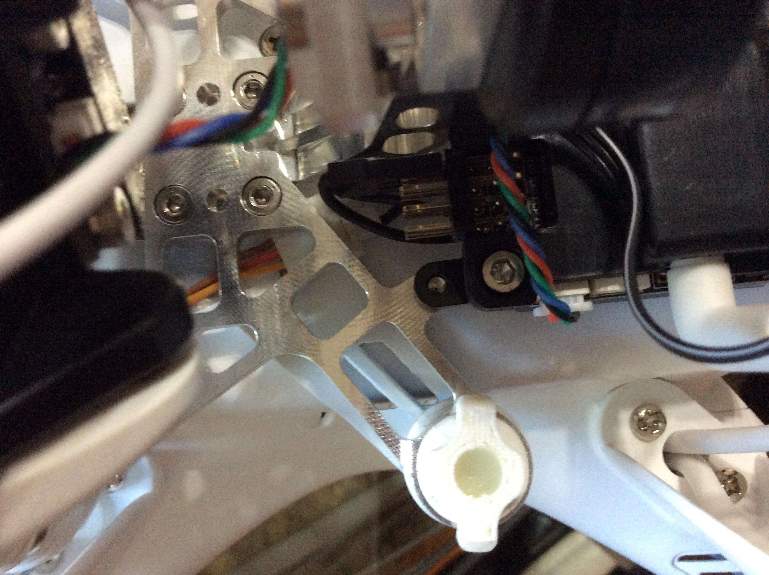

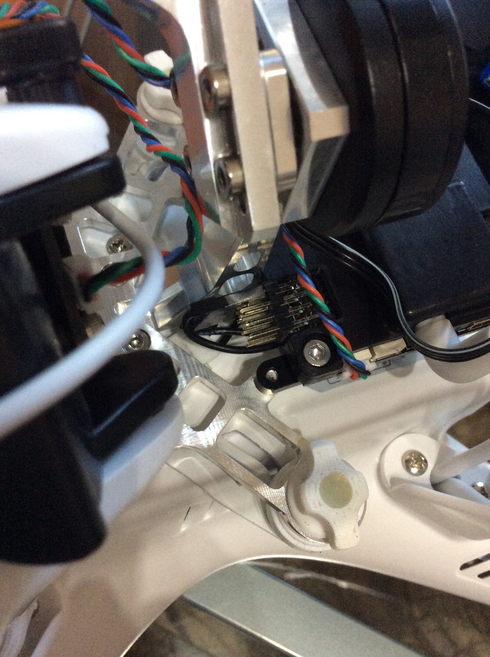

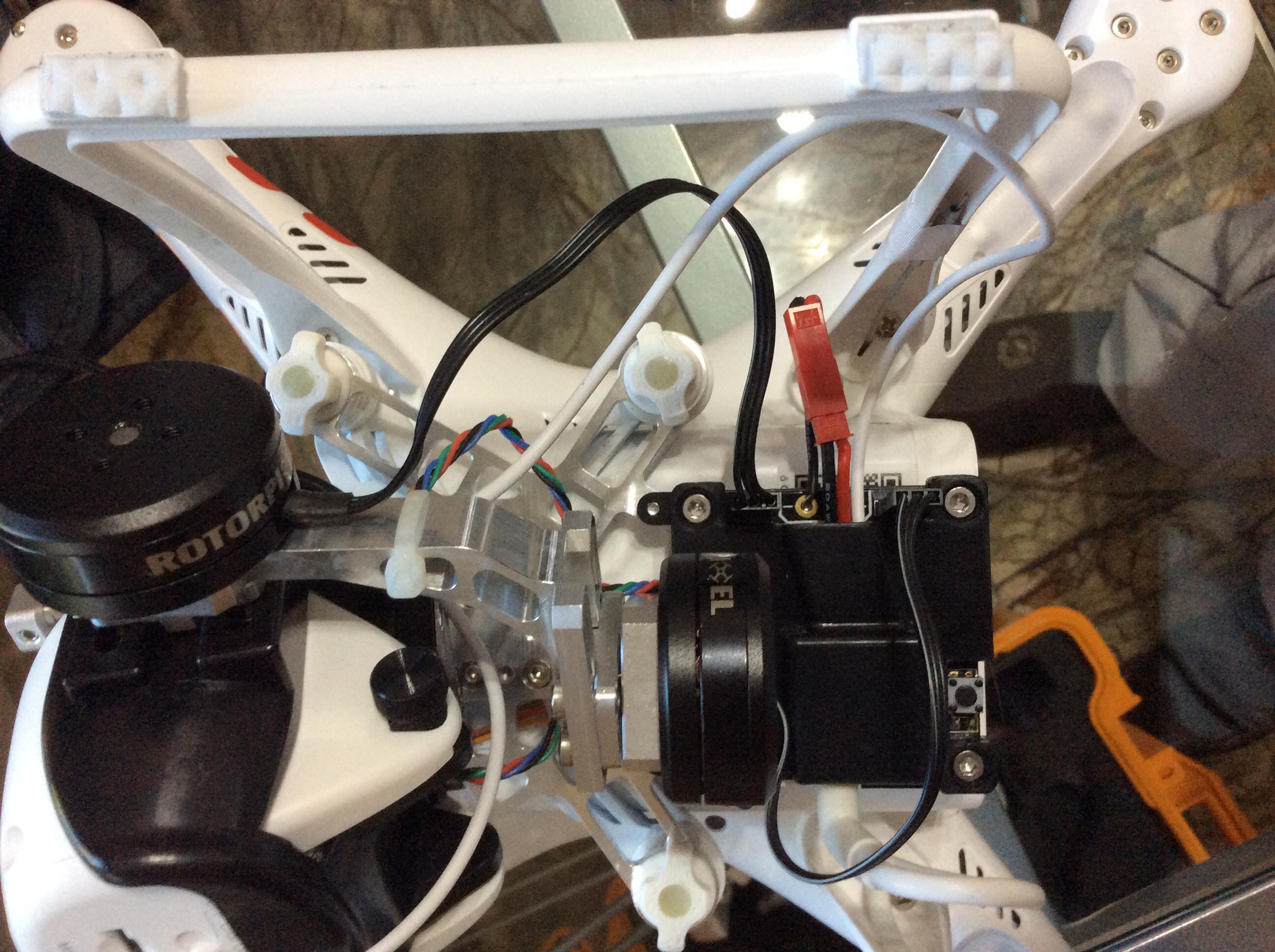

Can anyone send me pics of the cables connected properly? I had to disassemble my Rotorpixel Gimbal, and concerned I am not connect the motor mounts, etc. into the correct pins!
Also, when I view picture in App, the tilt control is reversed, causing horitzonal control instead of vertical control.
thanks!
PS - Using the Vision 2+ with Rotor Pixel Gimbal

Check these pics out, hope this is what your after?
View attachment 19108 View attachment 19109 View attachment 19110

Thanks "Porky"...photos helped!! I had the cable on the board attached to the wrong pins, causing the vertical & horizontal controls to flip. NOW, if I could only get my GPS calibrated!! The hortizonal will calibrate, but NOT the Vertical... :(
