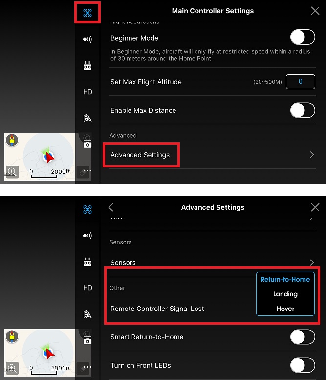

If you're using a mobile device that has a GPS receiver, you can manually reset the home point to your current location at any time mid-flight. DJI GO cannot automatically reset the home point and/or tell the Phantom to return to the remote controller's current position.
You might want to consider setting the "Remote Controller Signal Lost" setting to "Hover" just in case the signal is lost mid-flight. You can find that setting in the following section of DJI GO:

please excuse my ignorance......how do you do this? I have an Ipad Air with cellular and wifi.
Hi i on samsung tablet but just open dj app,general settings go down to signal lost and click ,,it gives u hover,,,rth,and landing option just click hover:)
