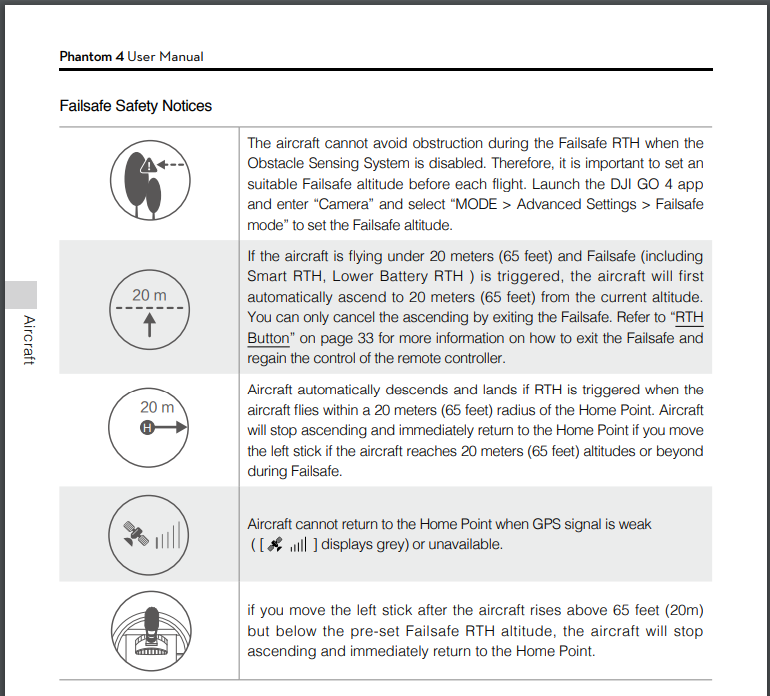

Is the Phantom more than 20 metres from the homepoint?
If it is closer than 20 metres, it will just descend.

Hi Oso, bingo, I was not aware about restrictions on distance from set home point which is (I believe) 20m. Thank you for advice.
Janusz
You can find more details in the Phantom 4 manual.
