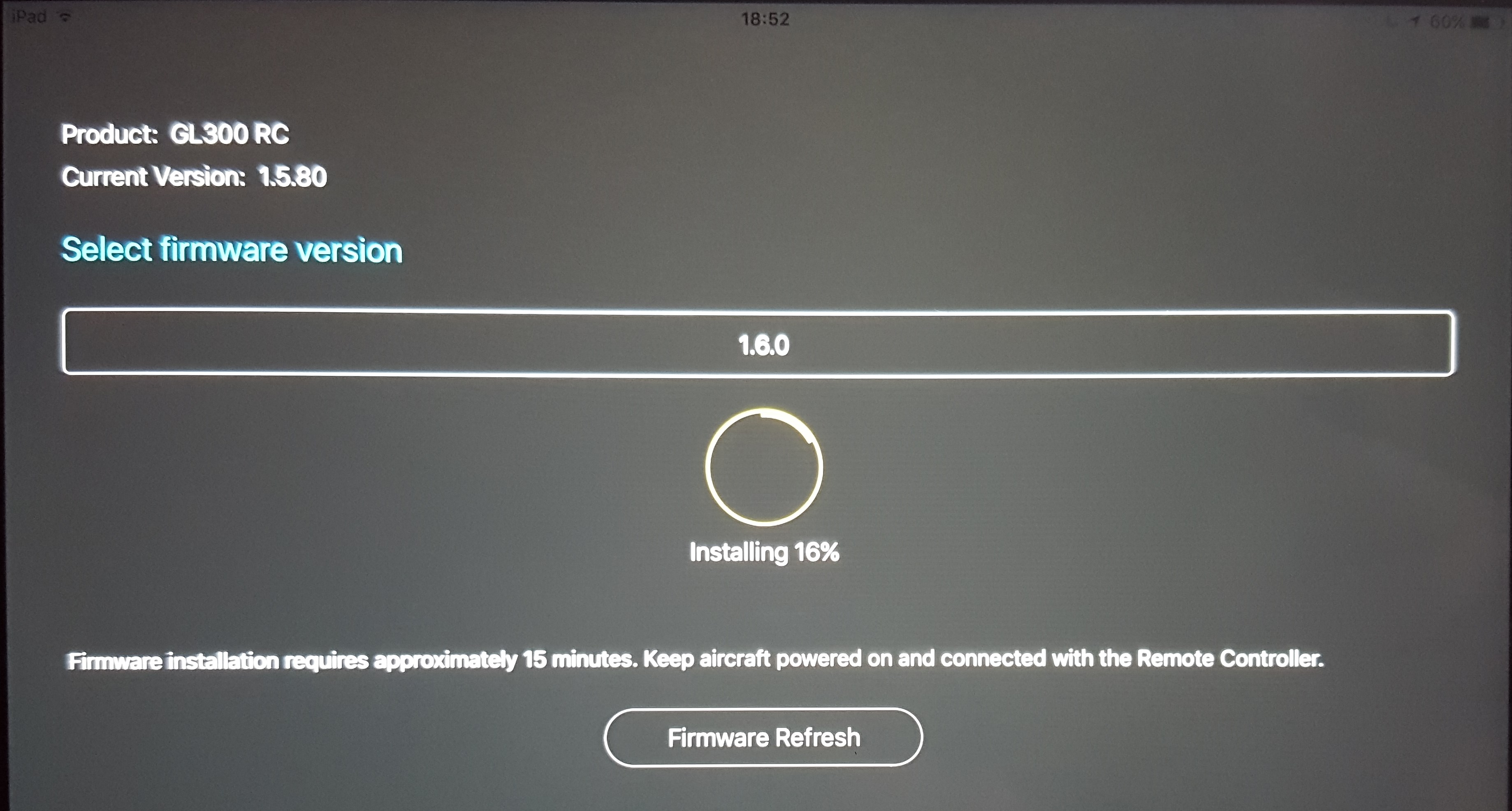

Omg I finally find the solution, thanks to the support they have asked me to do this:
- Press and hold the C1 button and the shutter, then press the ignition button
- Repeat this step a second time - When the status LED on the remote control will blink white, install your device (smartphone or compatible tablet) on the remote control, and then update the firmware of the radio control again
- After the update is complete, restart the radio control. If the charge level of the battery is insufficient, we advise you to charge it beforehand. Be sure to disconnect the radio control as soon as it is fully charged

  • Swapping the HDMI module to the standard USB module, was only changing the version reported to GO app. But any up/down grade always failed.
  • Finally progress started when I do the same but with an iPad mini 4. Menus are almost the same but the downgrade menu was showing refresh for the current version it shows. Before the refresh, It says refresh 1.6 but during the update, I saw Current version 1.5.80
  • This failed after 35% as before, but the RC was able to be powered on/off from the power button.
  • Then I tried many combination of keys (C1, C2, RECORD, SHUTTER and ISO wheel button), before powering ON, when it was ON and just before shutting OFF, I am not 100% sure of what was really successful. There was never a confirmation beep. At least one time, the status LED started to turn ON in BLUE :) and beeping like during an upgrade. There was still many trial of upgrade / downgrade using the GO app. When turning off and on, then it comes to be RED then cyan, so still ok.
  • But at some point, it started to update with BLUE status, slowly and only went to small % but said success and yes, it was ok :). Relink and all good. So much time lost !
I am sorry not being able to capture the full story to compile the correct path to follow. I thought in the middle that it was a loss and it will go for spare parts.
But my message is don't give up if you can't or don't want to sent it to DJI for repair.
