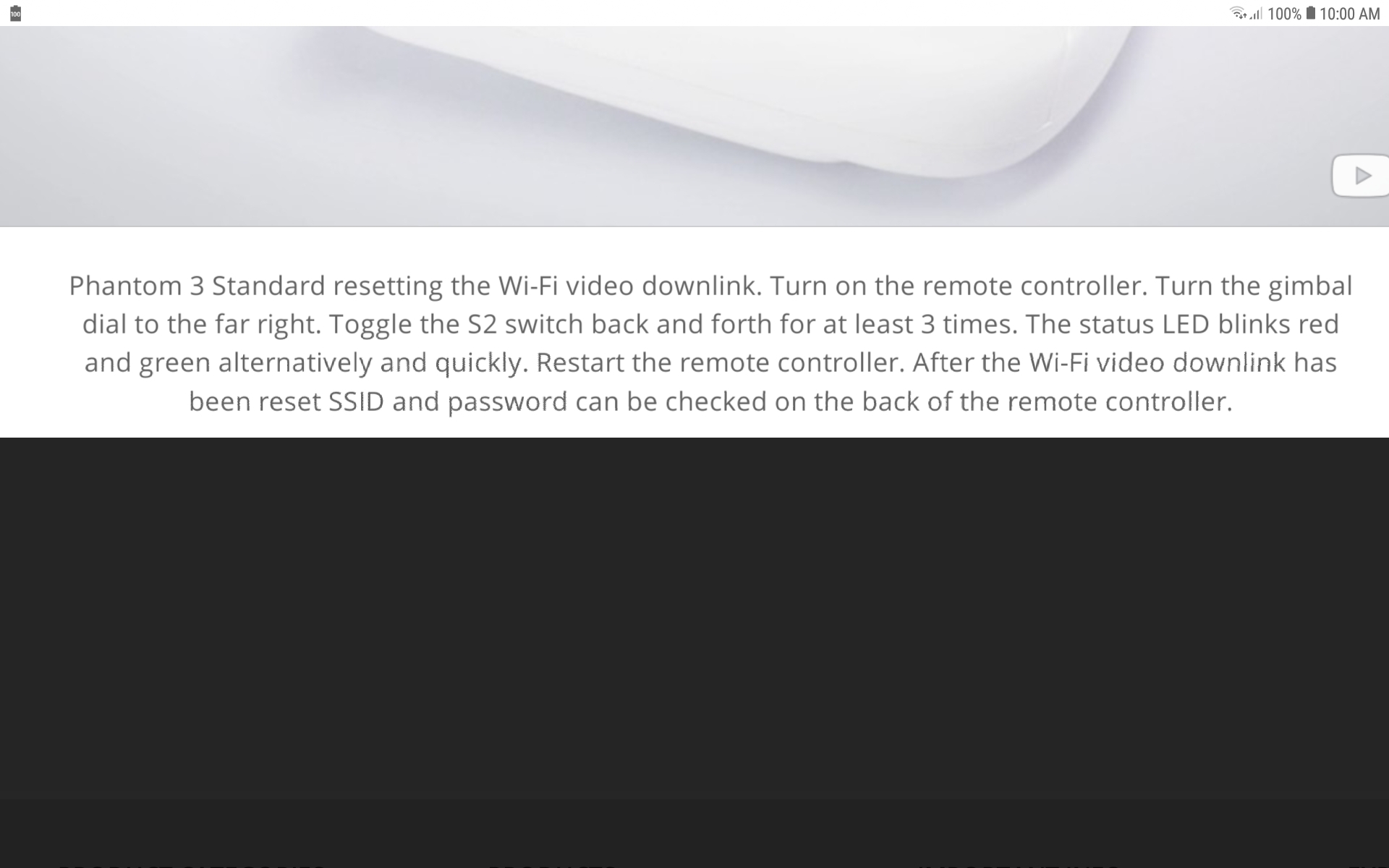

Try remote reset ,when got app open does it display disconnect at the top,
WiFi PW Reset works well. What i am trying actually is this procedure:
