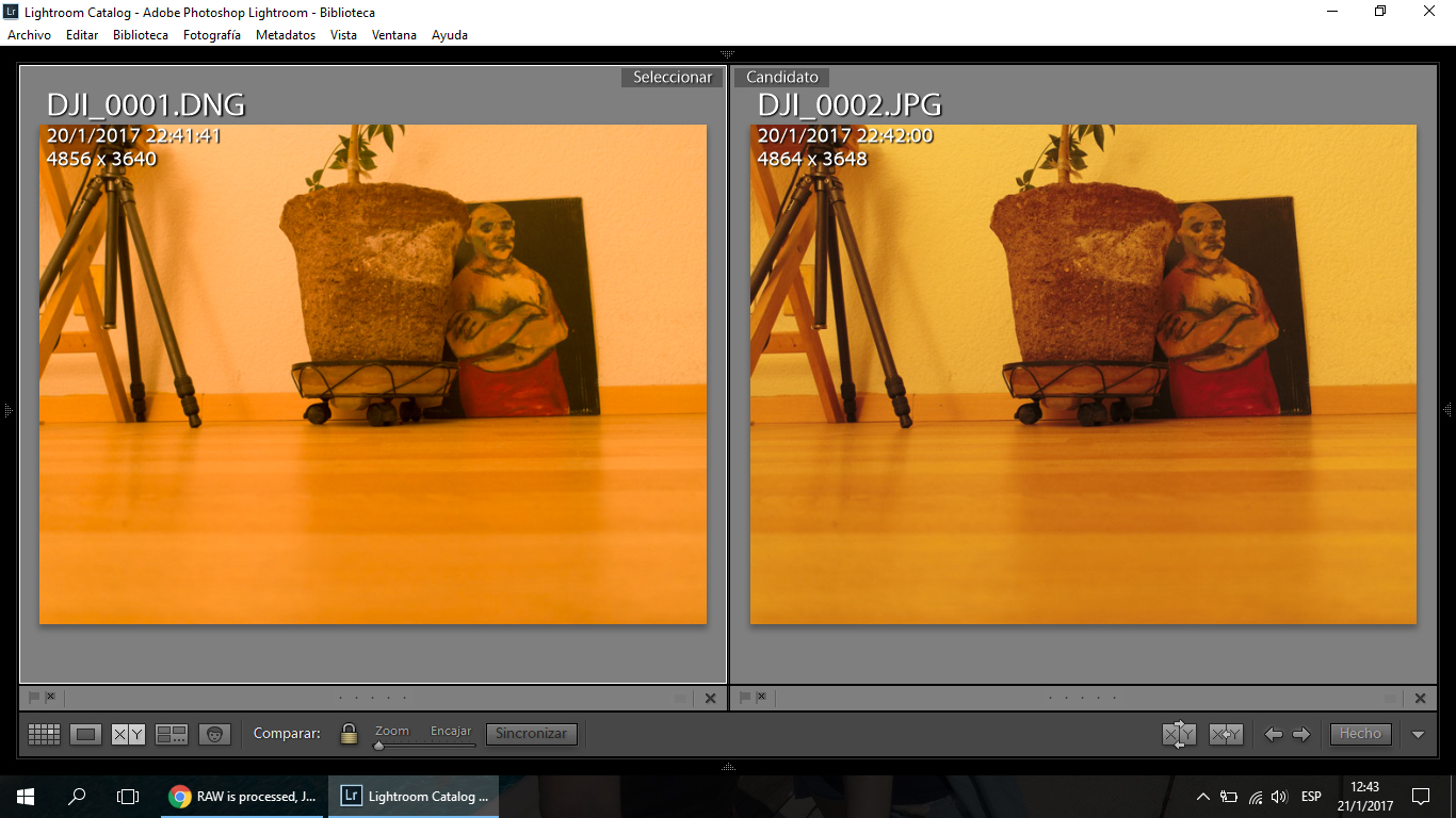

This is how they are coming out. The right one as you can see is JPG, and the left is DNG. It was taken as a test on another color profile. If someone tells me that that´s the way they are supposed to look I will myself hehehe

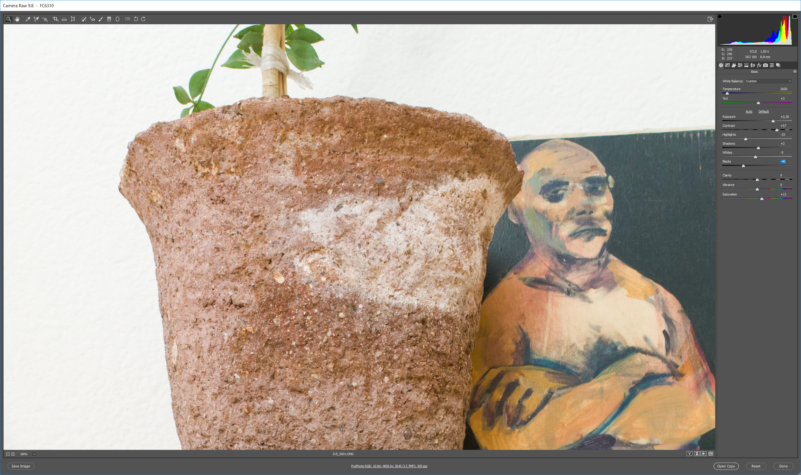

This is what a 100% crop of your raw image looks like after it has been toned; you cannot skip this step with raw as I and others have mentioned several times.
By lifting exposure with more than two stops, I have effectively increased noise by at least 200% and it still retains full detail, definition and tone in all parts of the image.
Please clarify what is literary wrong with this picture.
you really dont get it right Thomas? I lnow hot to edit a photo! My god! It´s not about if I can fix or edit a photo! It´s about the starting point should not look that contrasted and saturated.
It´s like buying a Ferrari and they tell you you can go 0 to 100 miles per hours in 5 seconds, and when you try that, is not so. But someone tell you, don´t worry, you can get to 100miles in 10 seconds. I know I can go that F.... fast, but is not they way it has to be. Makes sense?
I don´t need a retouching class! I know hot to do color process, editing, composites etc.... it´s the starting point and the processed it´s being applied to the image from camera what is wrong.
Do you understand the point now? Or you will keep saying it´perfect because moving some sliders can give that same look?

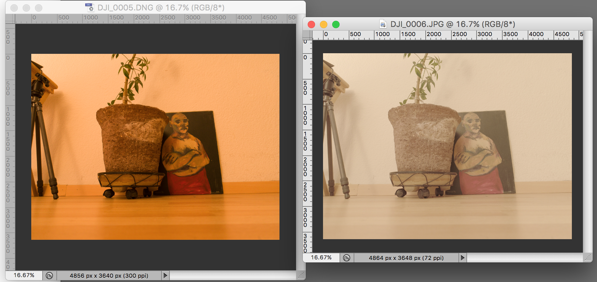

Here are the files as you requested. They are straight from the P4P and hasn´t been opened.

Thanks Ricardo.
1) I see that the two pictures are not the same. When you shoot RAW+JPG, the name of files it's the same, and here you have two different pictures, taken with a difference of 20 seconds if you see metadata embedded.
2) Regardless of the point 1, please see how I see your set RAW+JPG:
I don't see your problem here. I see a standard DNG and a compressed and adjusted JPG. I only loaded the two files in library and clic in compare. Nothing more, nothing else. I didn't touch anything.

This is what I see in Lightroom as well.
@RicardoUK
Something tells me your software is doing something to your images.
I also posted your files on rcg, and everyone said the only thing wrong with your sample was you had the white balance/color temp wrong when you took the image. Once that was corrected it looked great.
To quote them:
"It wasnt taken with the right white balance setting. Once I corrected that in photoshop it looked fine. It was a 1 second exposure. I work as an advertising photographer and on my calibrated screens with the white balance adjusted correctly it looks fine. Histogram is good and the exposure is fine."
"Only thing I found was the color temperature was off .... turned it from 4350 to 3150 & it looks great!"
