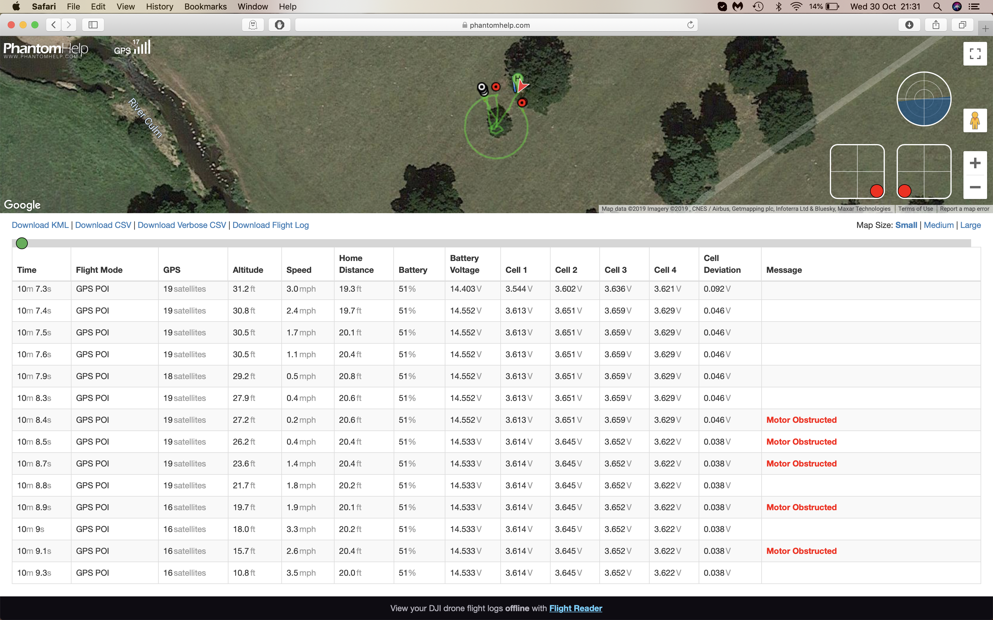

On the morning of September 8th I was doing a POI around an old Oak tree when my P3A came into contact with a small branch on an adjacent tree and crashed.

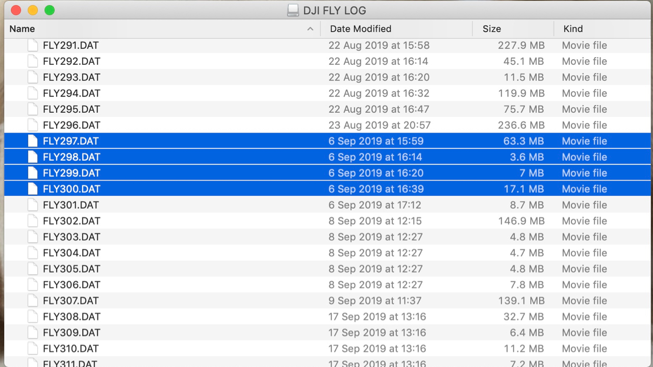

However, when I downloaded the .DAT files from the AC I couldn't find the file, or so I think

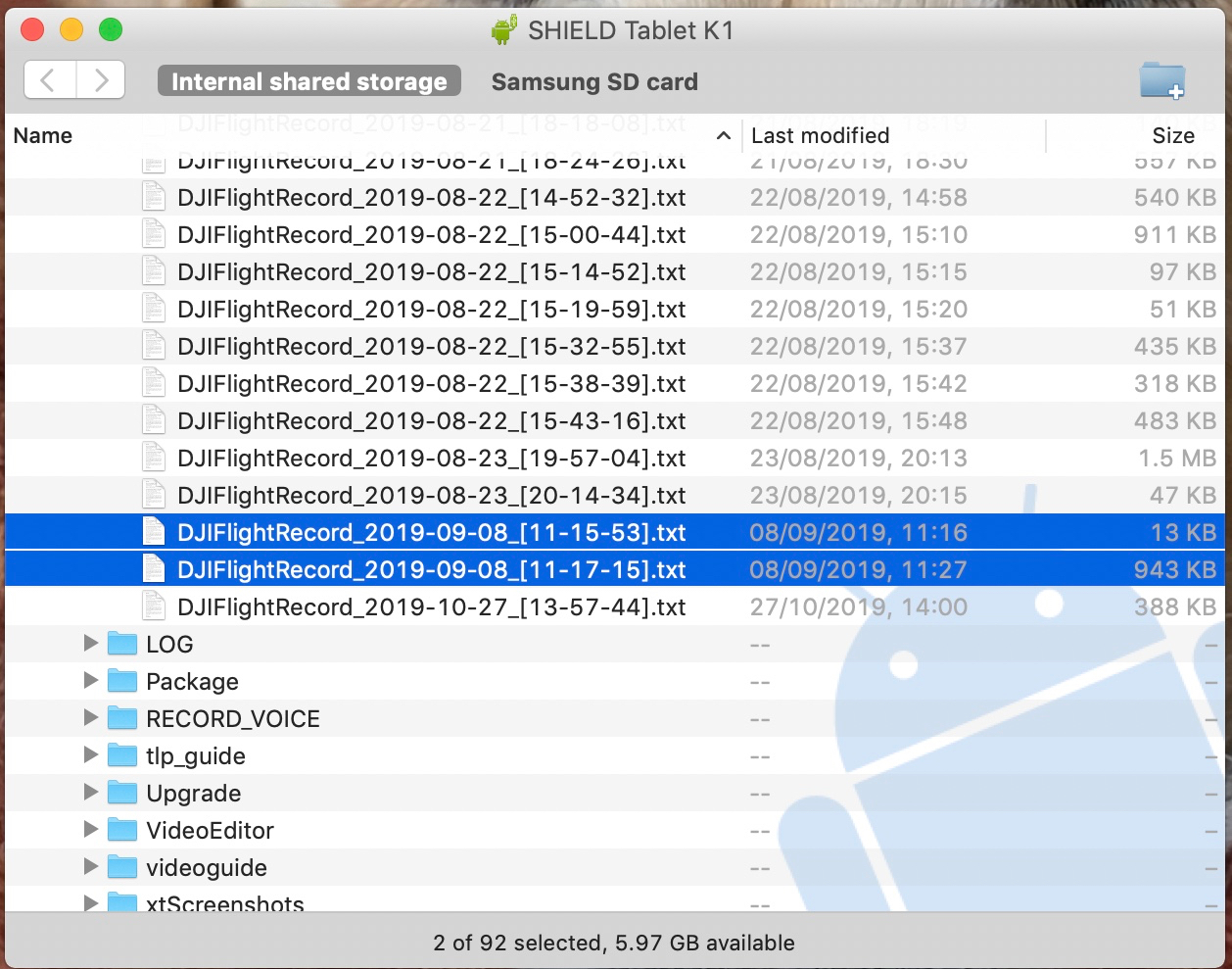

I downloaded the .txt file from my Nvidia Shield, which is dedicated to the drone and the file is there so why isn't it on the drone? Or is it possible that the time is wrong on the drone?
The larger of the two .txt files are the one where it crashed, I can plot it all right but there are no files on the drone for that time but I believe the 15.59 one is the one?

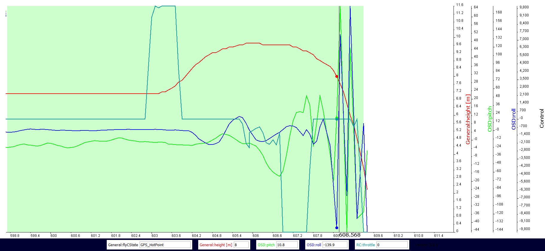

This is the .txt plot which is correct..............

Share that .txt file again and I can tell you which .dat file it is, unless you already know.
I suspect it's the 63Mb one?

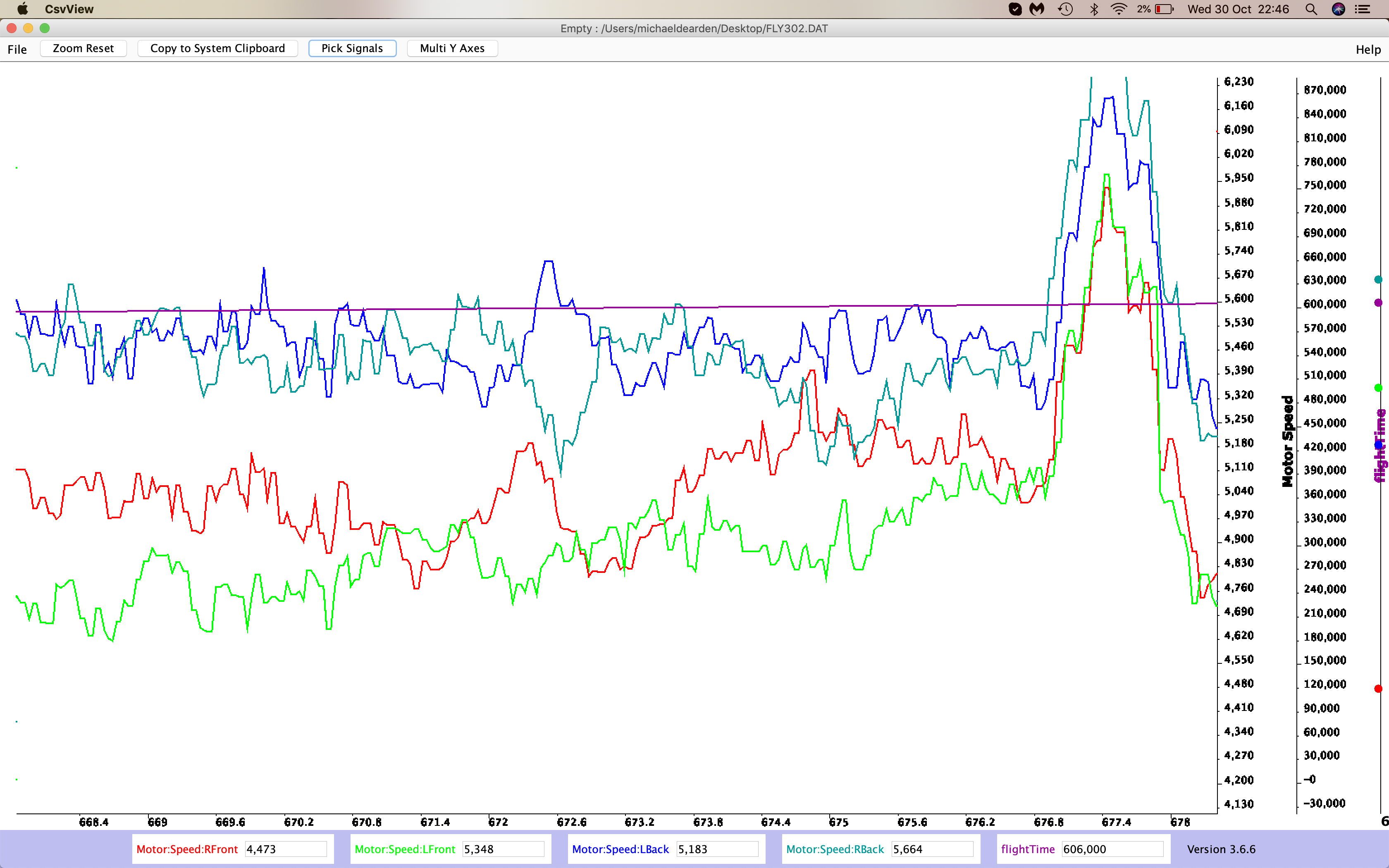

So, looking the .DAT motor speeds I don't see anywhere at the end where one or more hit the tree - stopped, and then the drone fell to the ground.

@cheddarman .....From your .txt log. Impact at ~608.5 sec....After you gave full throttle up then full throttle down.

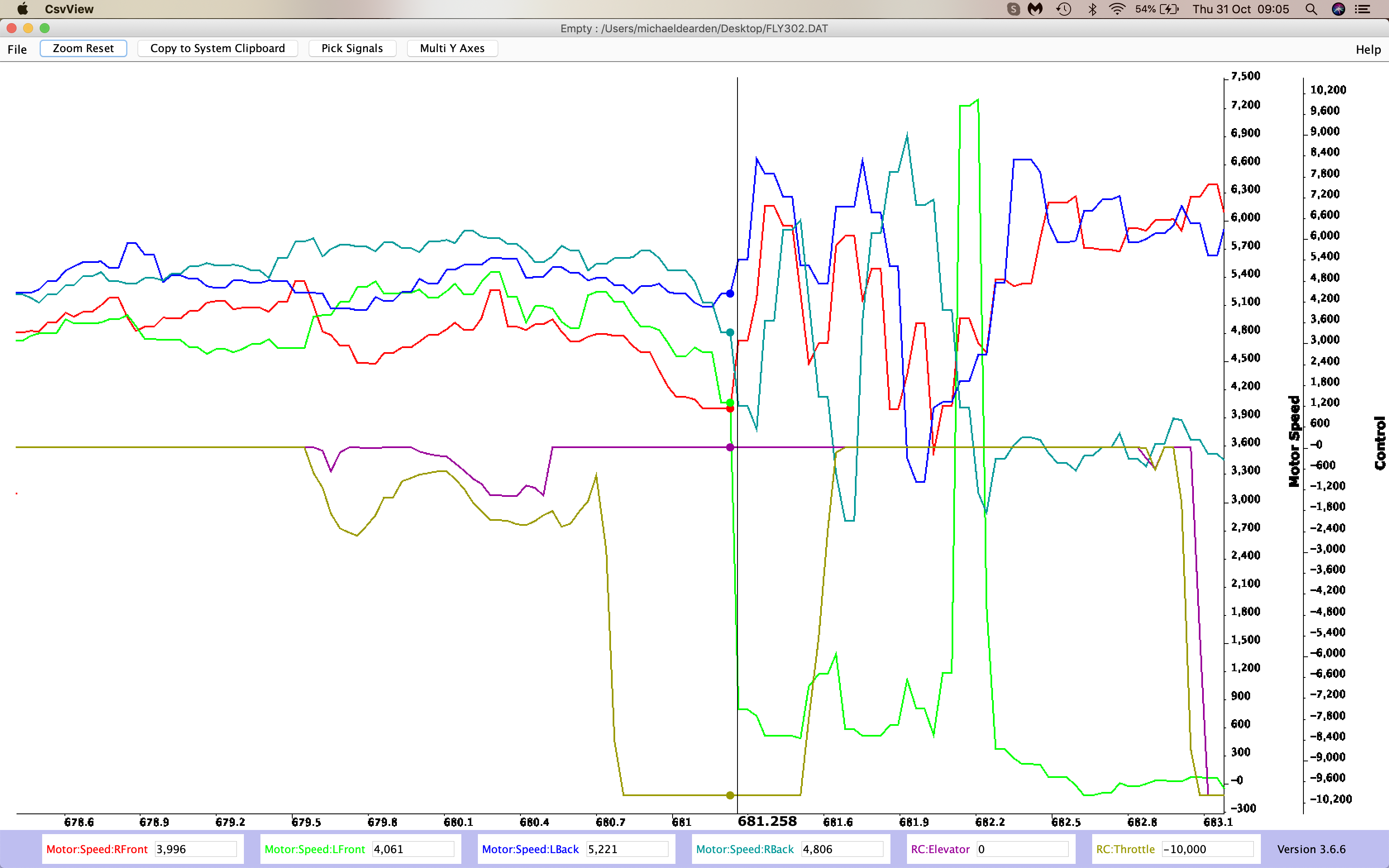

Fantastic FD, I have got the hang of that now - convert the .txt file time to the .DAT time.
Impact with the left front prop at 681.258 which initially jammed and the prop broke off (looking at the motor speed) at which point I tried to extract the AC from the tree hence the heavy RC inputs.
I LIKE this tool. Hope I don't need it too often though!:D
