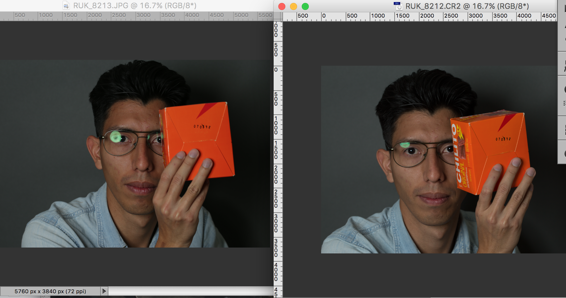

This is a RAW file and a JPG out form Canon 5D MIII. Under camera profile of ACR It has several options. SO as some people mentioned before it most be a problem of the ACR profiles which is applying it to the RAW. I will try updating it or hope DJI in a Firmware goes back to the P4 profile or something more general that ACR can read.
Thanks
