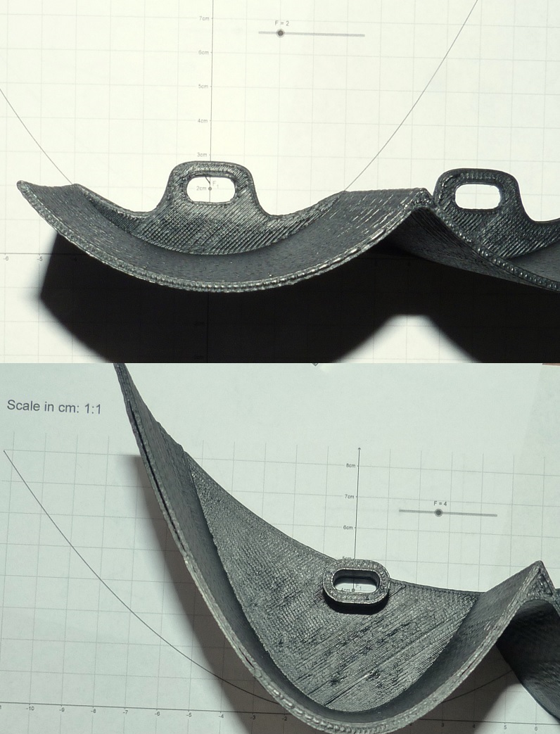

From what I read, the theory of the windsurfer boosters is that they should to be parabolic to the focal point - focal point is the distance between antenna and base of the parabola.
I printed two different types found on differet sites (one with a focal of 2cm the other with 4cm) and checked whether their parabolic shape were correct.
The first one is spot on. The second one is way off.
But theory also has it that focal point should be one or half a wave length (12.5cm or 6.25cm) away which would not fit on the transmitter.
So none of these designs are optimal.

Please explain your findings in laymen's terms. The printed boosters are not optimal, but if they increase distance by 100% it gets the job done right? 20k distance is already scary to think about.
Distance might not be an issue with most of them if you aim the P3 well, (batteries will) but in theory the better the design, the stronger your signal will be. i.e video quality as well as frame rate should remain higher, you'll be able to fly further closer to the ground or trees or whatever. A good design will be more forgiving if your aim is not as good etc.
You could make boosters that are wider than the transmitter - that will allow aiming to be less important. Its not just about flying the furthest you can in a straight line up until you just about lose signal in my opinion.
