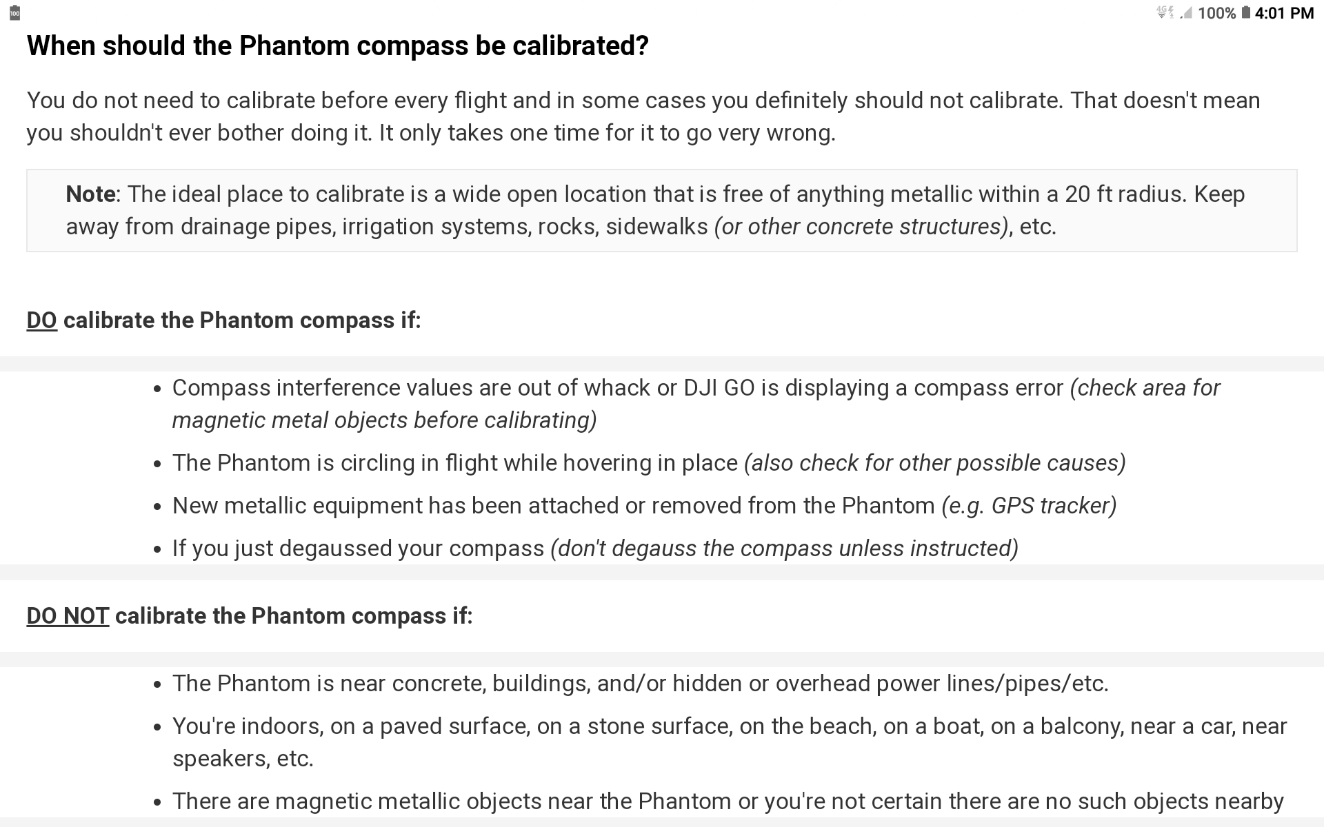

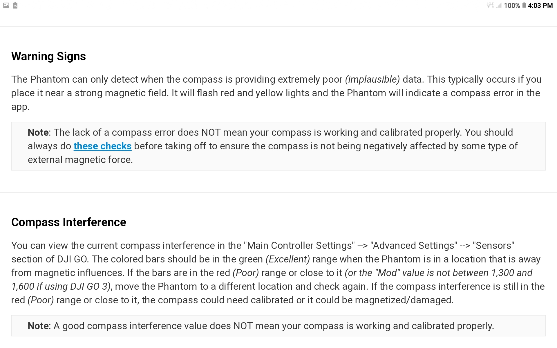

This from phantom help about compass,now we should all know
