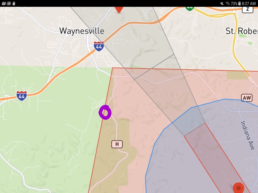

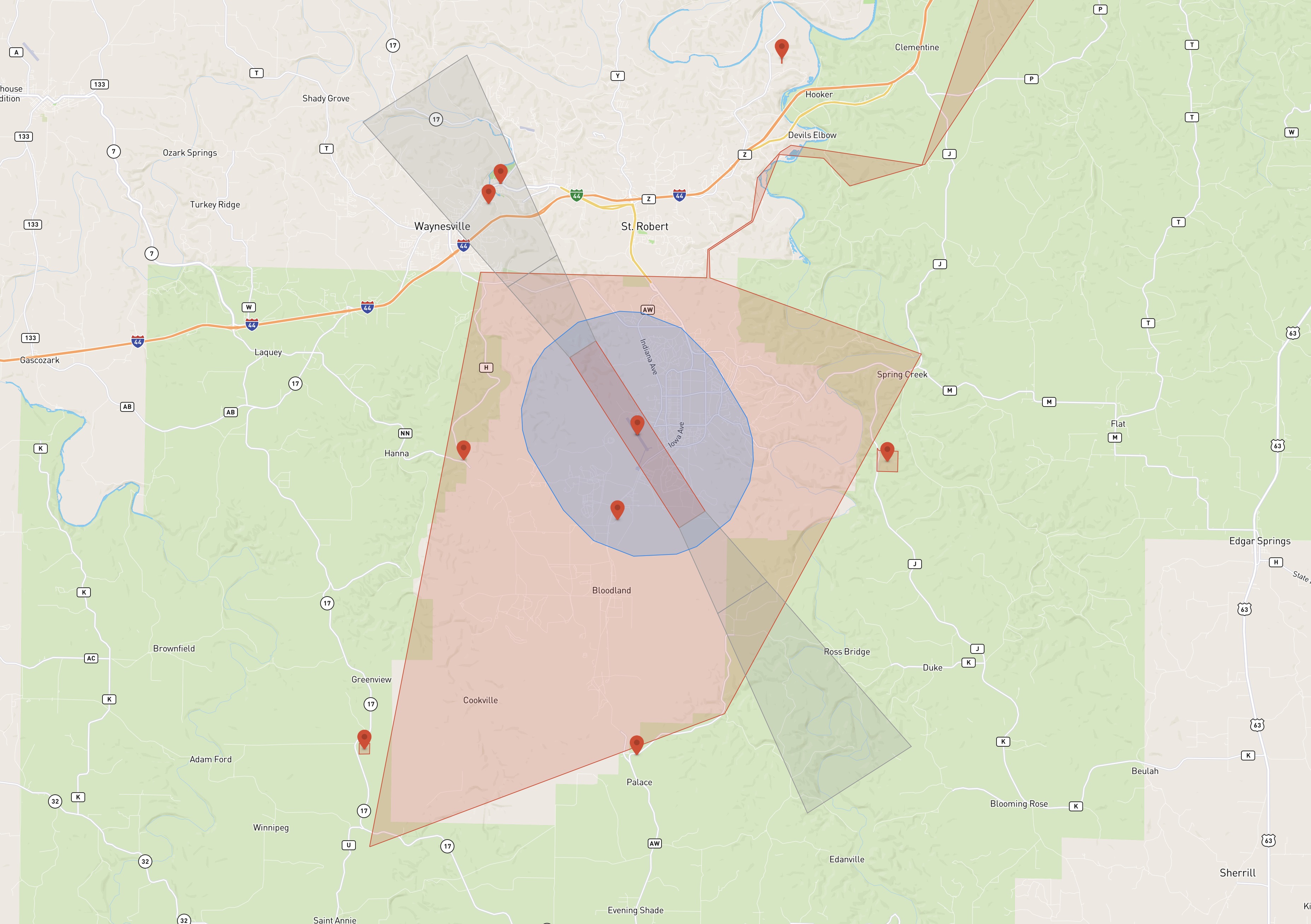

Ok, along this same line, what about if you're inside a red circle? Have a farm rented near Ft Leonard Wood, Missouri that I can't even make my bird spin a prop in. Are those off limits completely? I wouldn't think ATC could release the hold on my drone, could they?

You should be able to find out the reason for the restriction, you could be close to a government facility of some kind (there are also many reports of DJI georestrictions being unnecessarily broad in some cases so it's possible that you are not actually within the restricted area, not sure what the resolution for that would be.) In any event, assuming it's possible to get regulatory approval to fly there I don't think there's any connection between the FAA approval process and DJI's geo restrictions, so even if you obtain approval to fly in an area restricted by DJI geofencing I'd expect you'd still have to request a separate temporary authorization from DJI via their web site in order to to unlock their georestriction.

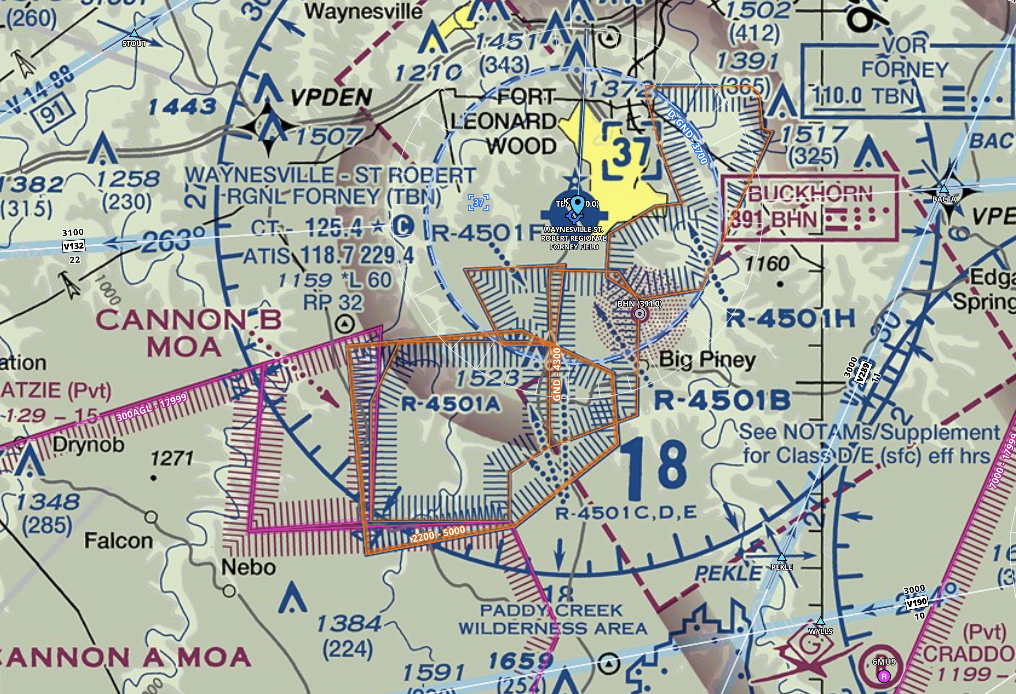

Somewhere in here:
112514
Which is DJI's rather strange implementation of this:
112516
Of which only the non-continuous R-4501A is restricted from the surface up.
However, either way, if you are inside the DJI red restricted zone then that requires custom unlocking. If you are actually inside R-4501A then you probably won't get authorization.

A common issue with DJI's overly agressive geo restrictions.
Actually the new geo system is much better, and generally quite good. I think the complexity of the special use airspace in that particular area may have led them to give up and just draw a big red polygon.

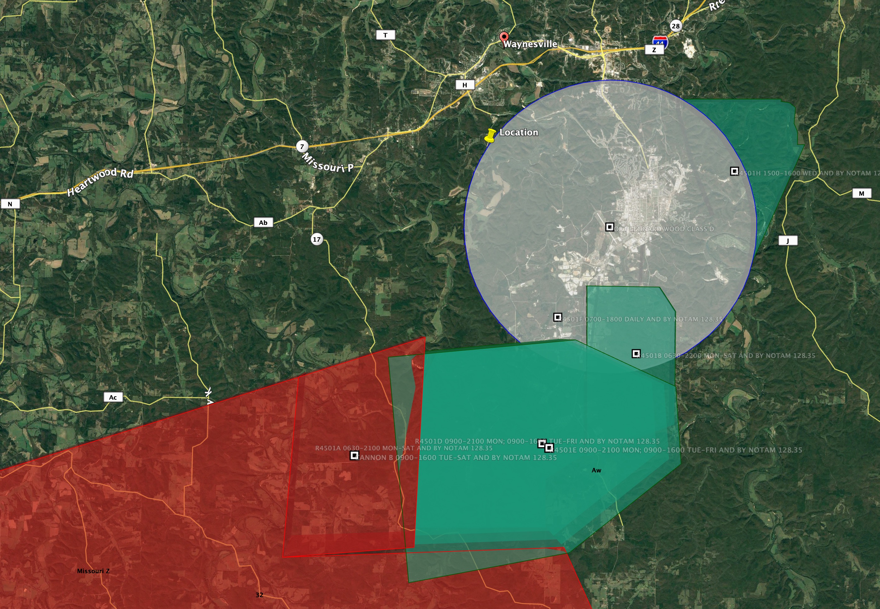

Yup. Just barely inside R-4501A. Just North of Cannon B MOA.

Purple indicates farm location.
