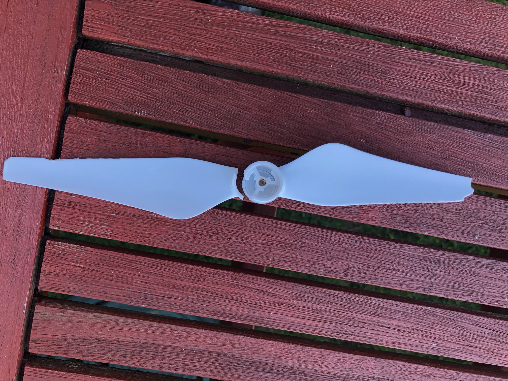

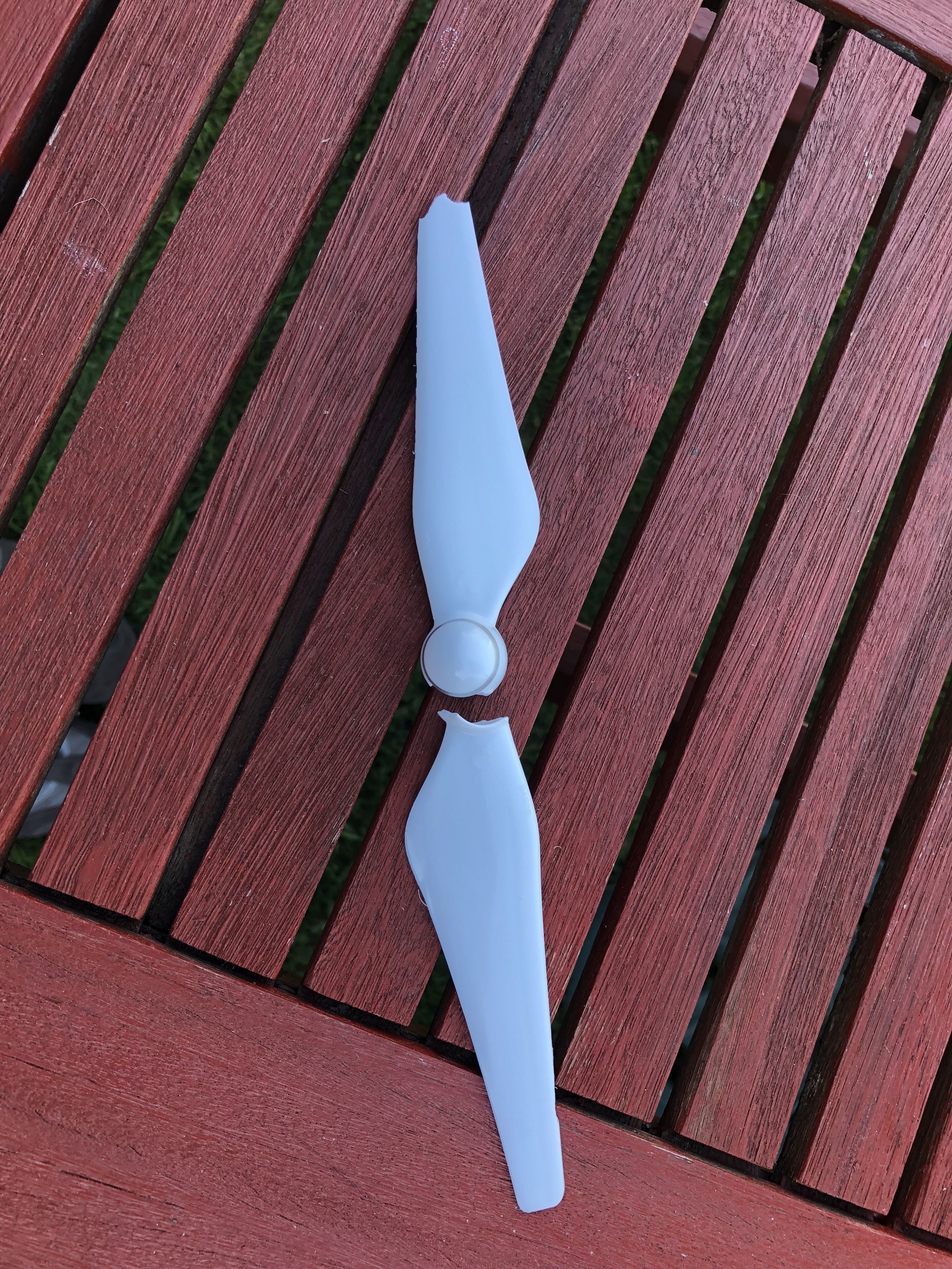

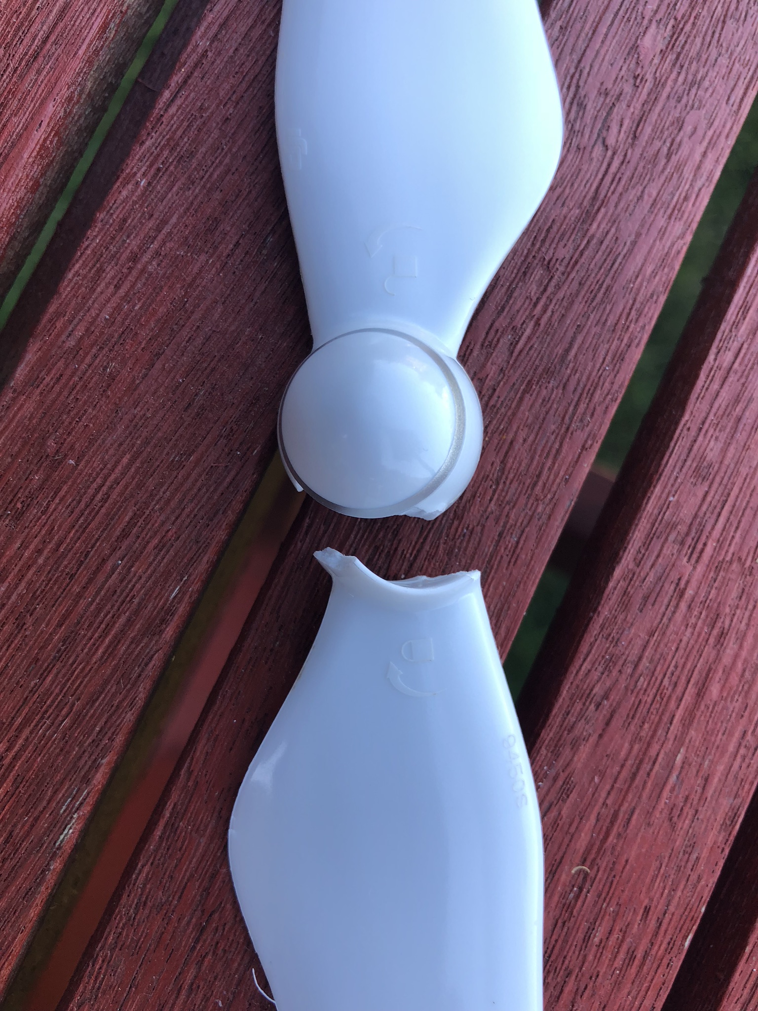

Any ideas about this? The blade separated the prop which remained attached all the way back to the ground.

You mean the blade separated from the prop hub actually, but which motor. It looks like you hit something, just judging from the missing tip on one side ( which may have occured after impact) and the other edge damage on the same side that separated. Is this Front Right/Left or Back Right/Left?....
The drone was in the middle of a sports field hovering at about 8 feet. Nothing around for miles.
As you say separated from the hub. The tip broke when the blade hit the ground having watched it from about 20 feet away. It was the back left. The prop went as I applied power to climb almost at the point that the command was made.

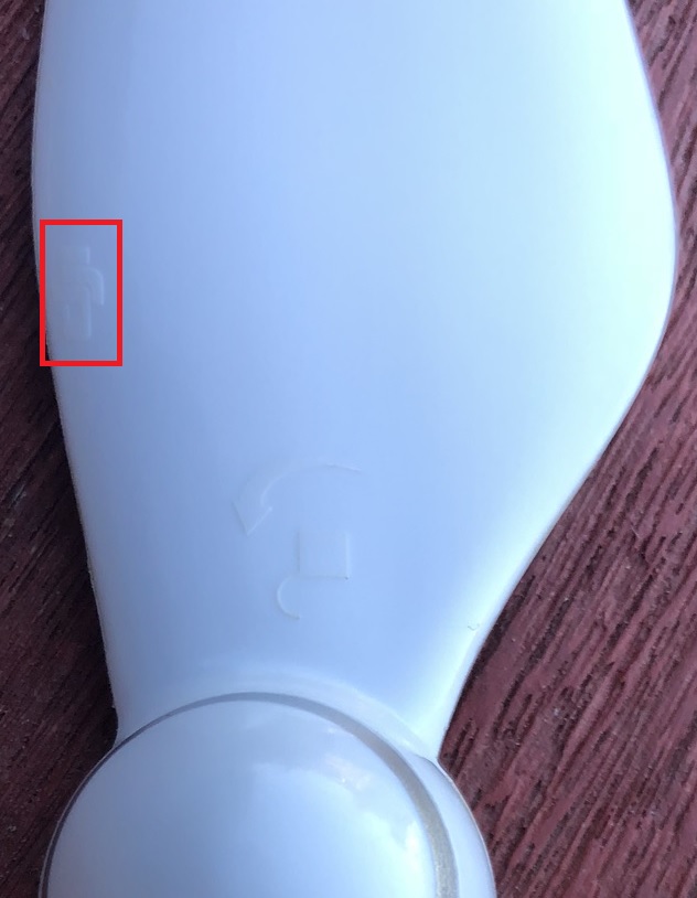

It's hard to tell looking at the photos but, are those genuine DJI props?
Good call, from the photos you can't see the 'DJI' logo stamped into the top - as it would be with all OEM props

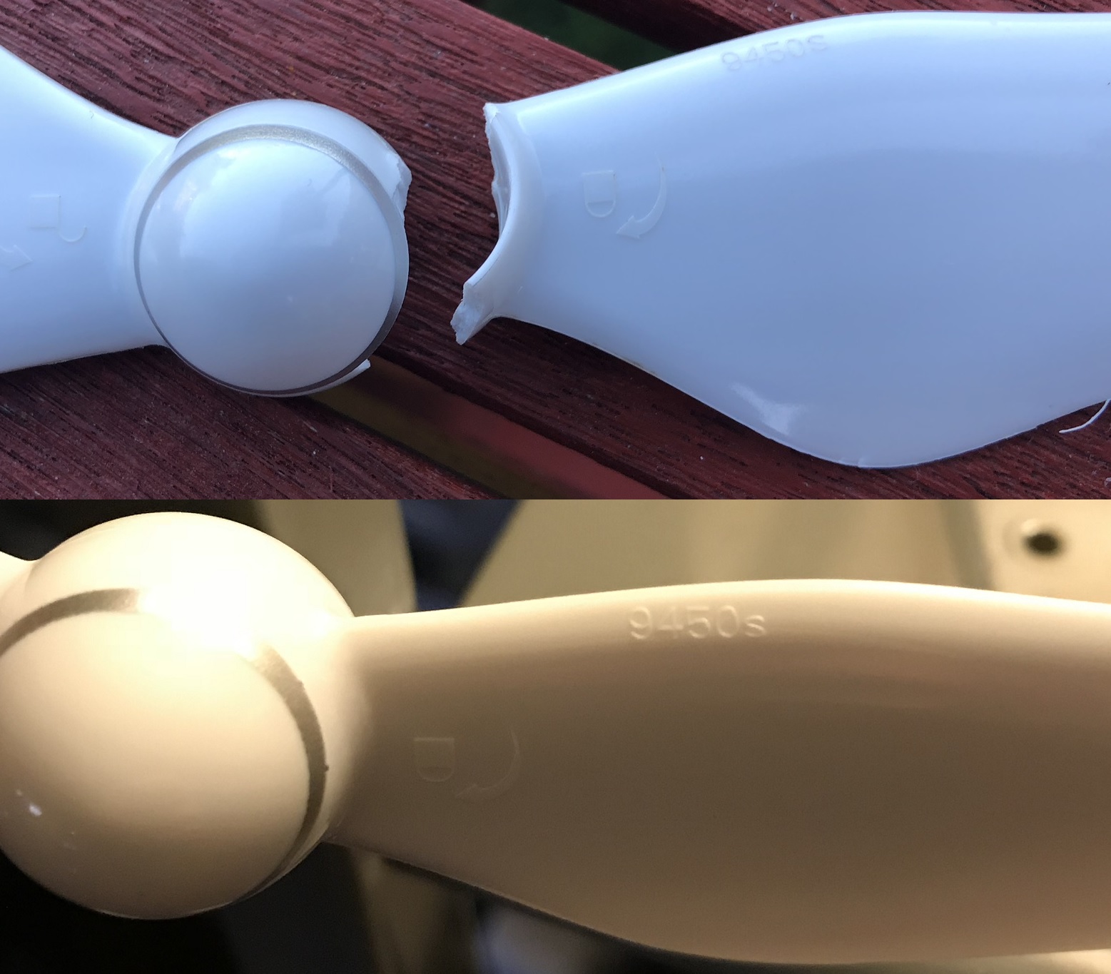

You can see the DJI logo here:
However, the markings on the prop are a little different than all of my P4 props. Compare the "9450s" and lock symbol here:
Well I'll be dipped... not the first time I've been wrong though :oops:
I didn't bother to zoom the photos, and thought the logo would be more prominently visible without having to zoom in. That's what I get for thinking...
