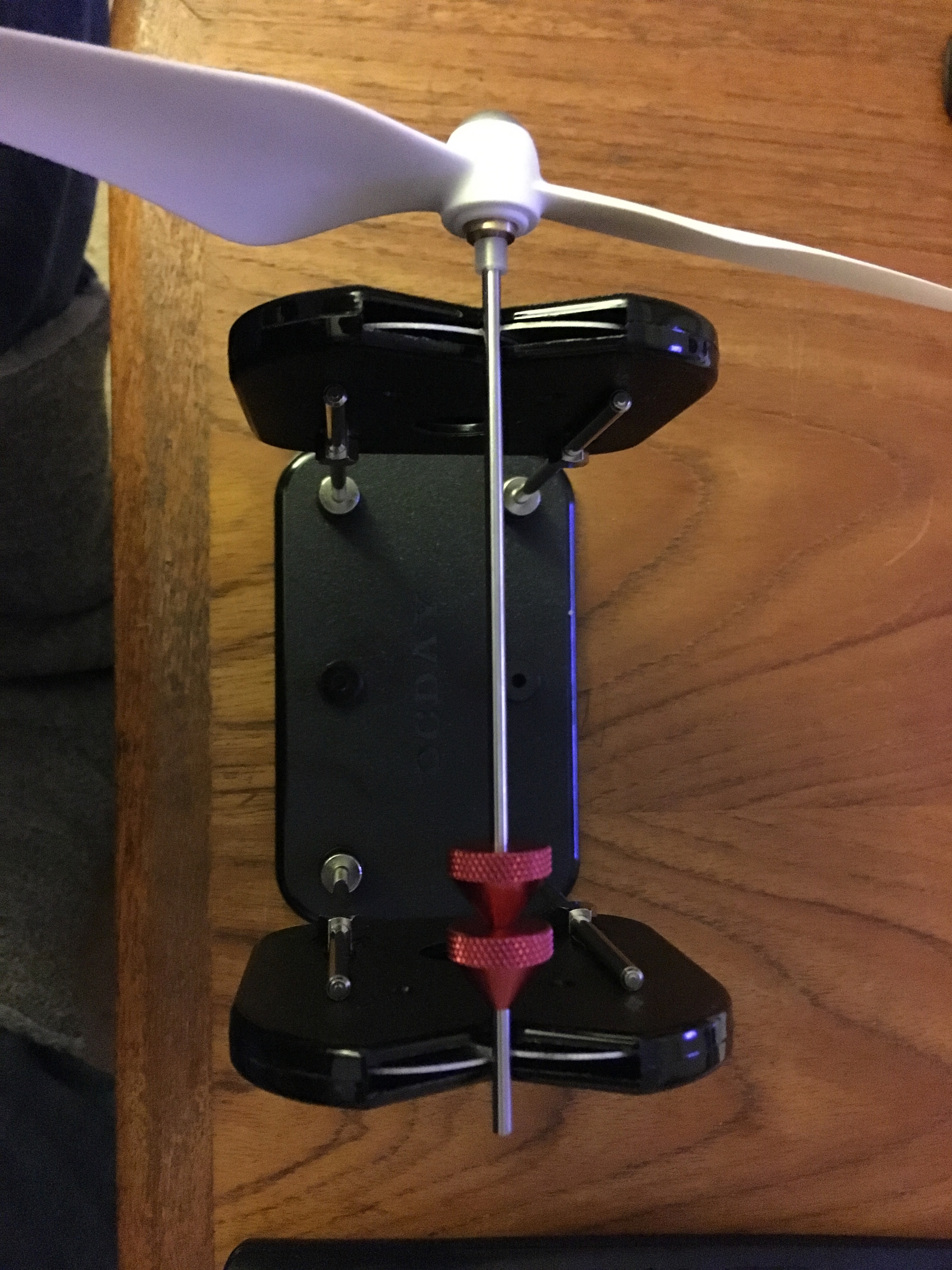

I have a Tru Spin pro balancer from DuBro but don't have the 6mm left/right thread shaft for the Phantom blades and am wondering if it's worth the £20 investment.

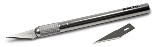

A quick hack is to use the handle of a common x-acto knife if you have one. It fits perfectly in a P3 prop hub. Remove the blade of course, insert the handle into the hub. It will stop before the threads. I've used one for 4 years now, though as @sar104 said I also stopped worrying about it when over time I repeatedly found DJI props to very well balanced.

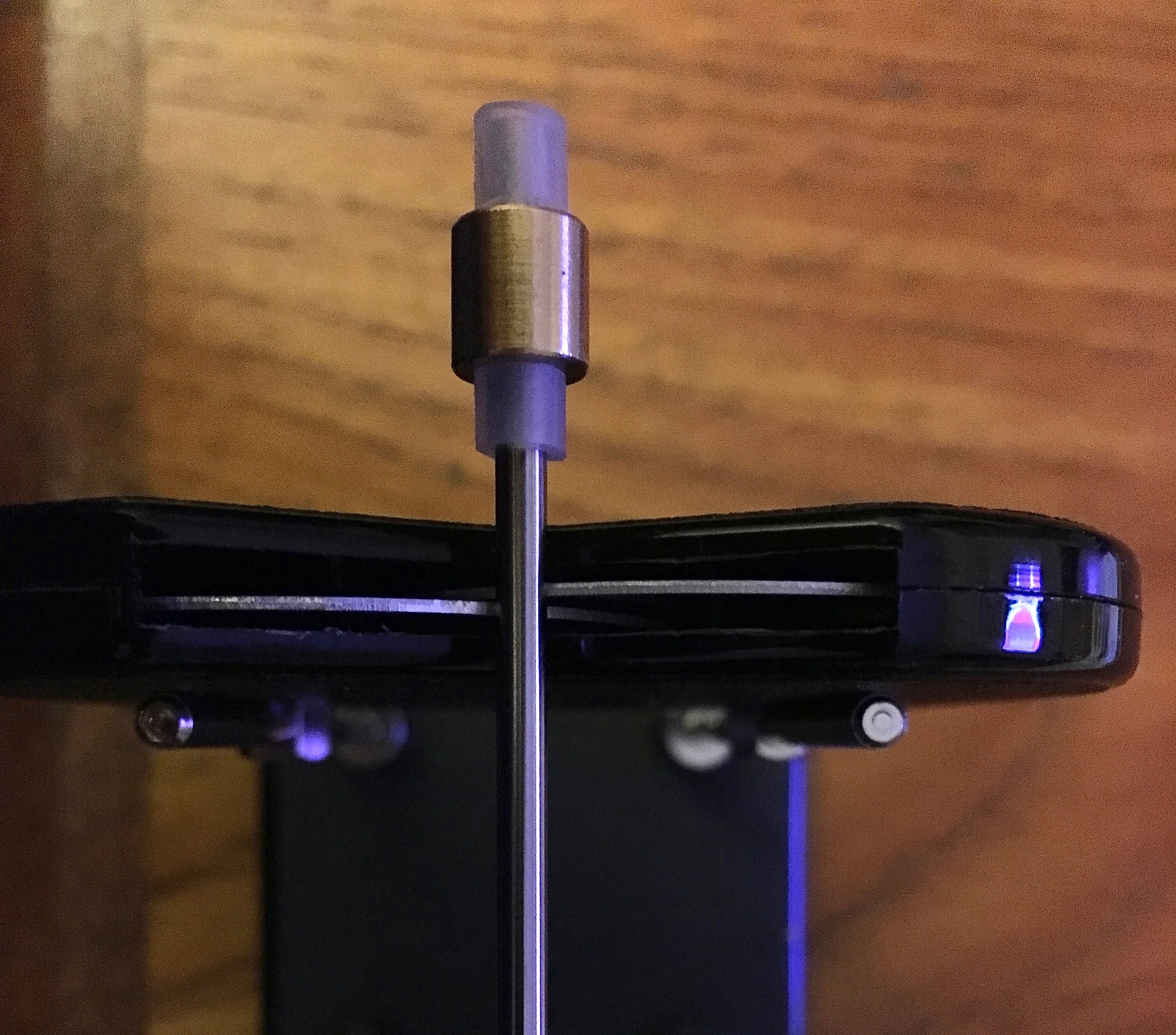

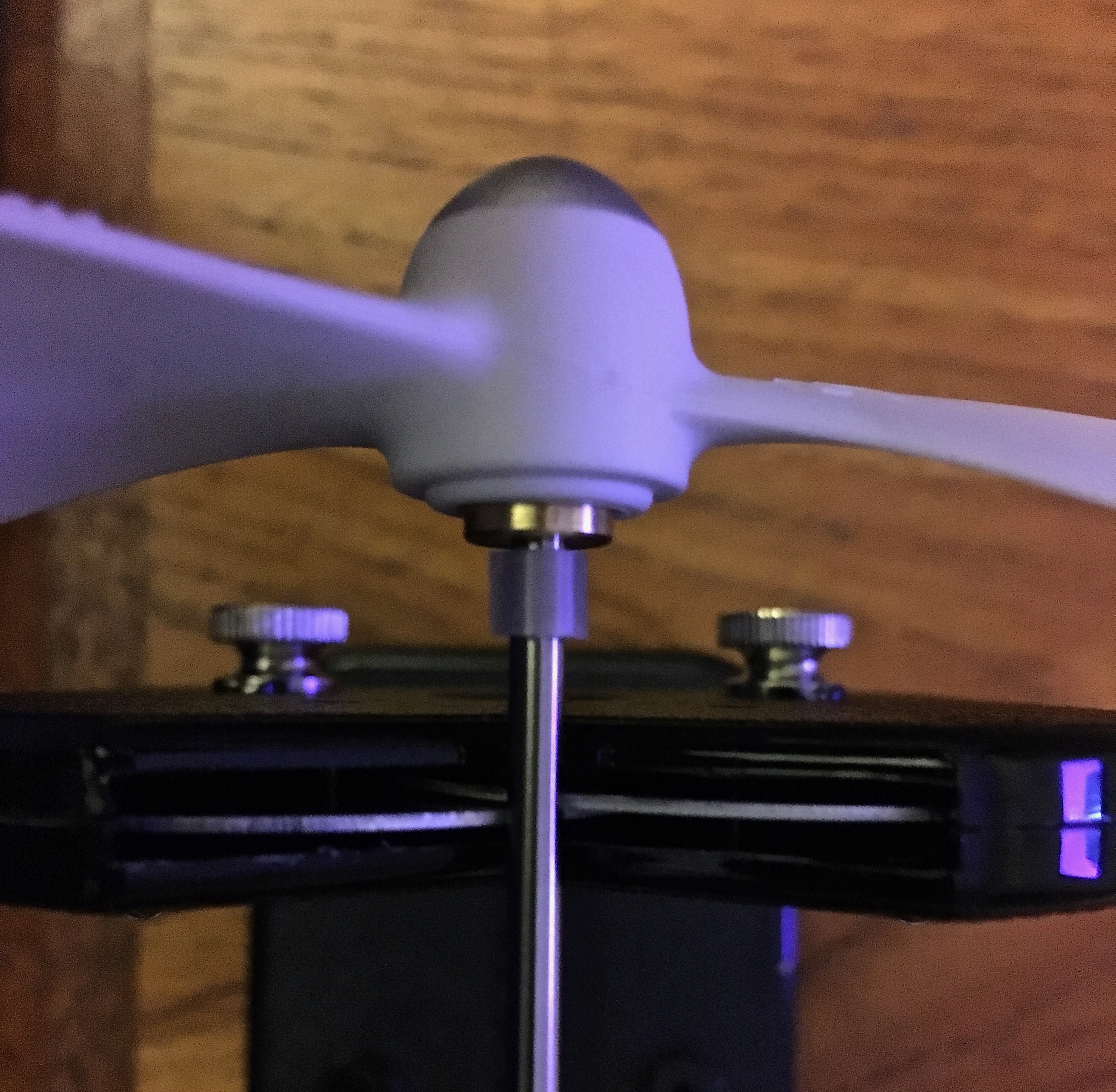

I use the O-Day balancer which is a direct copy of the Du-Bro and just as good but lot cheaper price.
There is no need on the Du-Bro or O-Day to use a special shaft and especially 20 quid price !!!
The O-Day and I know Du-Bro did supply it or started to supply similar ... a brass smooth tube that slides on to the long shaft and this is a press fit into a P3 hub. There is also a silicon tube piece that slides on behind it to keep it in place on the shaft ...

I found nearly all of my (8) P3 props were out of balance brand new - easy enough to fix (I have a balancer threaded at each end).
With my P4 props I've only had one prop from 12 that needed balancing out of the box.
About half of my P3 props were always out of balance by just a bit. For my P4s and beyond, I've stopped checking the balance. I don't think the small imperfections I found will ever make a huge impact when flying.

THAT I like and didn't think of! Yep, on the DuBro Try Spin one of the brass collars fits exactly into the unthreaded part of the prop and the little plastic retainer actually screws into the thread, so job done!

Yes is the simple answer. Maybe not by much - but because I prefer to have balanced props on ALL my models - I check and adjust.
But again I answer - Yes ... at least 10 out of my 12 with at least 4 of them more than the others.
Saved you 20 quid ... and now you can balance all your props ....
