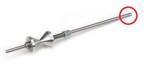

    The P3 and P4 prop balancing rods are different sizes. If you have the Du-Bro 499 prop balancer, the P4 props will fit onto the included rod. If you have a different prop balancer, you can use any of the following prop balancing rods:

    Thanks msinger for your reply. Yes I have the Du-Bro 499. I have one question though if there's any chance you can help me? The balancing rod is not a threaded rod. How do you attach the Phantom 4 prop to the rod? Thanks again for your help.

    Just slide the center of the prop hub onto the end of the rod.

    Now just to confirm, the Du-Bro 499 will work with the P4 props without needing an additional shaft correct?

    The 499 prop balancer comes with the shaft you need to balance the P4 props.
