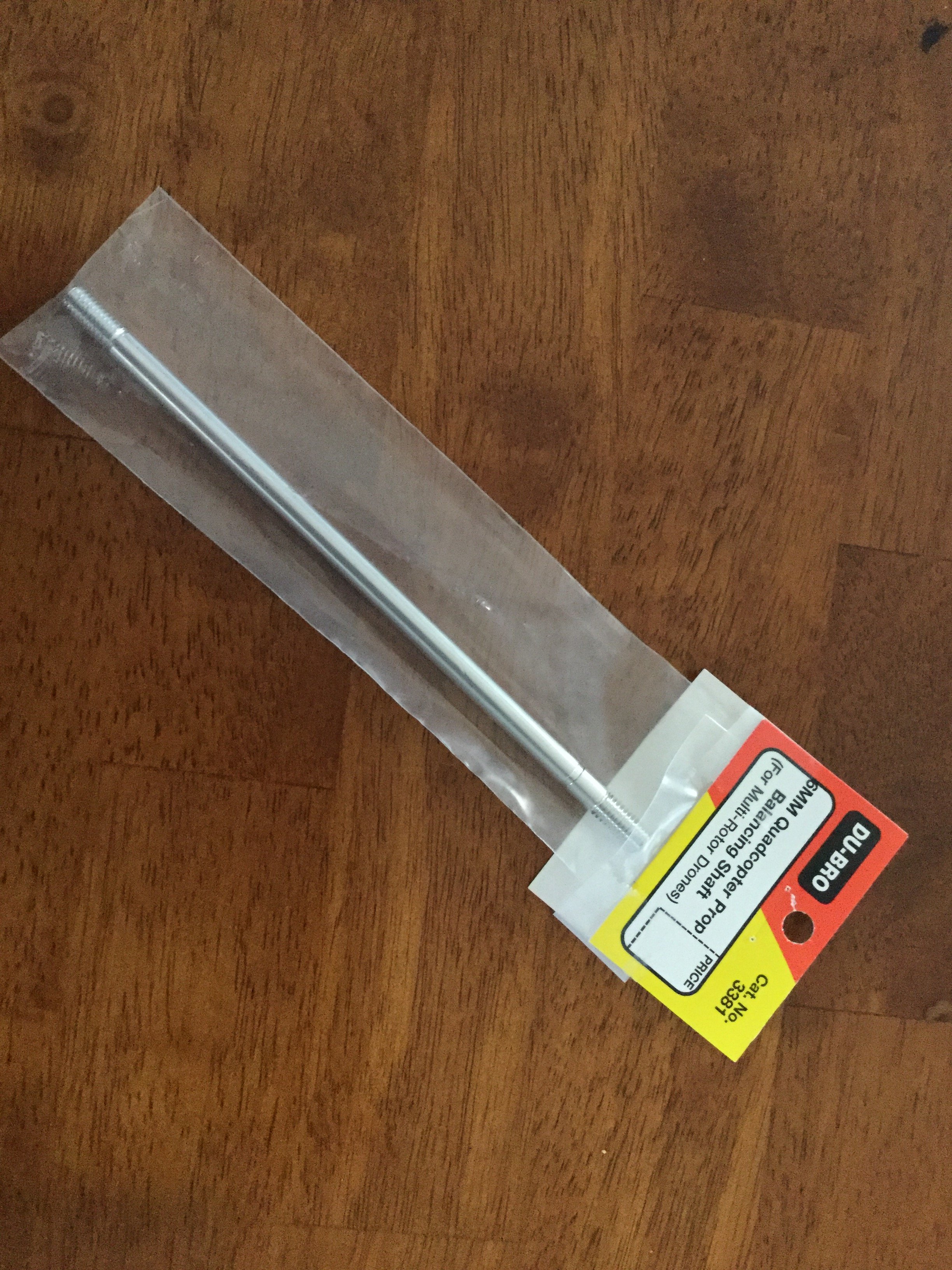

I have an extra Dubro Prop Balancing rod if someone can use it. Opened only for photos & fit. All A ok..

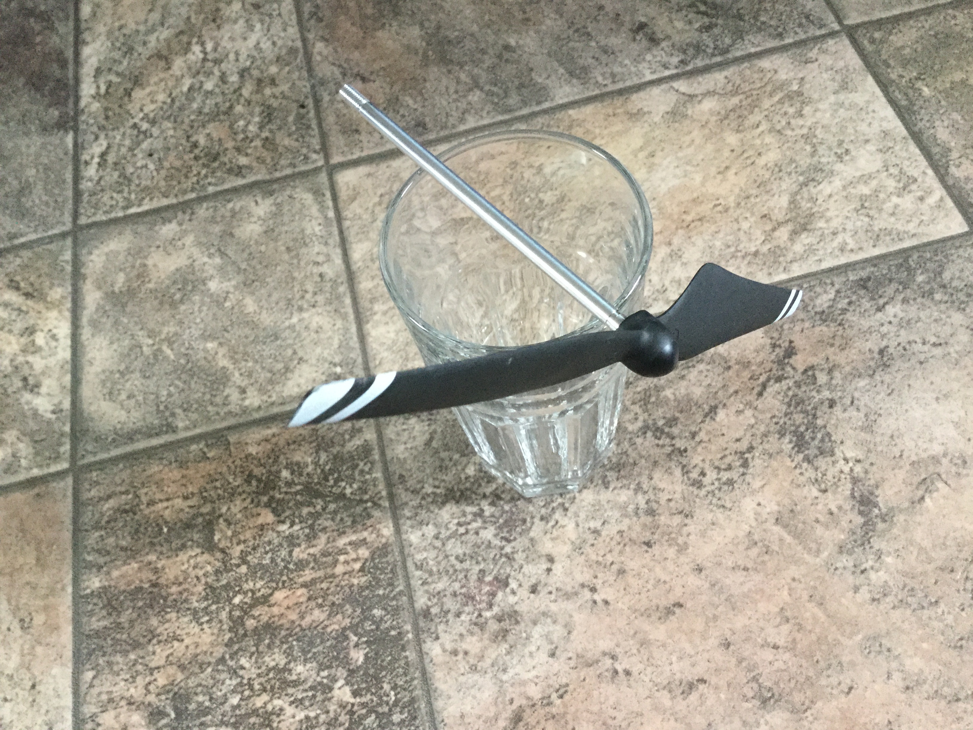

I’ve heard of the drinking glass as a base used.
How’s $8.00 shipped sound. PayPal..USA

Sorry, that's not "balancing"!
Actually if you use a cross point screwdriver ... commonly termed Phillips ... as long as the working end is small - it does work. The point will find the centre / apex of the hub. Before I got my O-Day - its how I did closed hub props like DJI.
With correct end - its actually very accurate.

I personally feel using a sharp point in the middle of the hub or anything that does not screw into the threads is prone to inaccuracies since the props attach to the shaft of the AC's motors using the threads. I tried a few methods and got very wild results.
My DU-BRO came with the dual threaded shaft.

The only props to come into my workshop which I've never balanced are the new DJI props. They'd have to be dismantled for balancing. Only because I originally purchased one of those rods for balancing DJI props I'm considering mounting a couple of hobby knife blades with stops on each end to stop the rod from dropping off the blades. There are a few problems with using a rod to balance, at least the one I purchased from Amazon has them. It's way too light and unless the prop is almost touching the first rest the darned thing topples. So if you're thinking of buying one avoid the lightweight aluminium type. In my opinion the heavier the better. I'm considering extending the standard thread on one end to the center and weigh it down with nuts.
For the simple reason the rod is not designed to be placed freely on top of runners. It is designed to be placed through the Du-Bro slots and rotate on the thin metal plates that should be able to rotate freely. If the plates do not rotate freely - which is rare - but can happen ... then simply dismantle the assembly and clean up so they do.
The Du-Bro and ODay machines are recognised as one of the best universal balancers on the market .... strange that.
