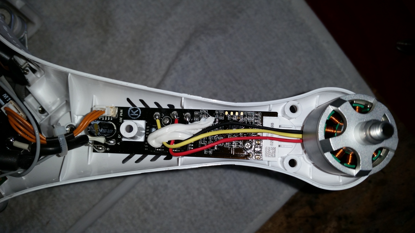

here's a picture of mine from the factory.
Really, that glue job is from the Factory? What a sloppy job they did, if anything they should have added a dab to each of the contacts to the ESC. I think that adds xtra weight, ( may not be much ) but IMO that is terrible. This is the Vision + ? I have the Vision+ and I have no glue blobbed on like that....
Really, that glue job id from the Factory? What a sloppy job they did, if anything they should have added a dab to each of the contacts to the ESC. I think that adds xtra weight, ( may not be much ) but IMO that is terrible. This is the Vision + ? I have the Vision+ and I have no glue blobbed on like that....
They started doing it after they realized they had a problem with their design. Mine came back with a strip of heat shrink wrapped around the ESC. DJI innovation - LMAO.
Reactions: SOLARFLARIN
No kidding, I have the Vision+ v 3.0, my wires are connected by solder only, nothing securing the wires. It's a good idea, because now I'm gonna secure my motor leads as well, but man DJI 's QC department need a refresher course or something....
Yup,
Phantom 2 Vision Plus V3 model PV331serial number starts with PH645
haha and I picked the best picture out of 4 haha
Yeahs it's sloppy but it's factory so I'm ok with it. I also separated the 3 motor wires so they do not touch each other or anything else.
