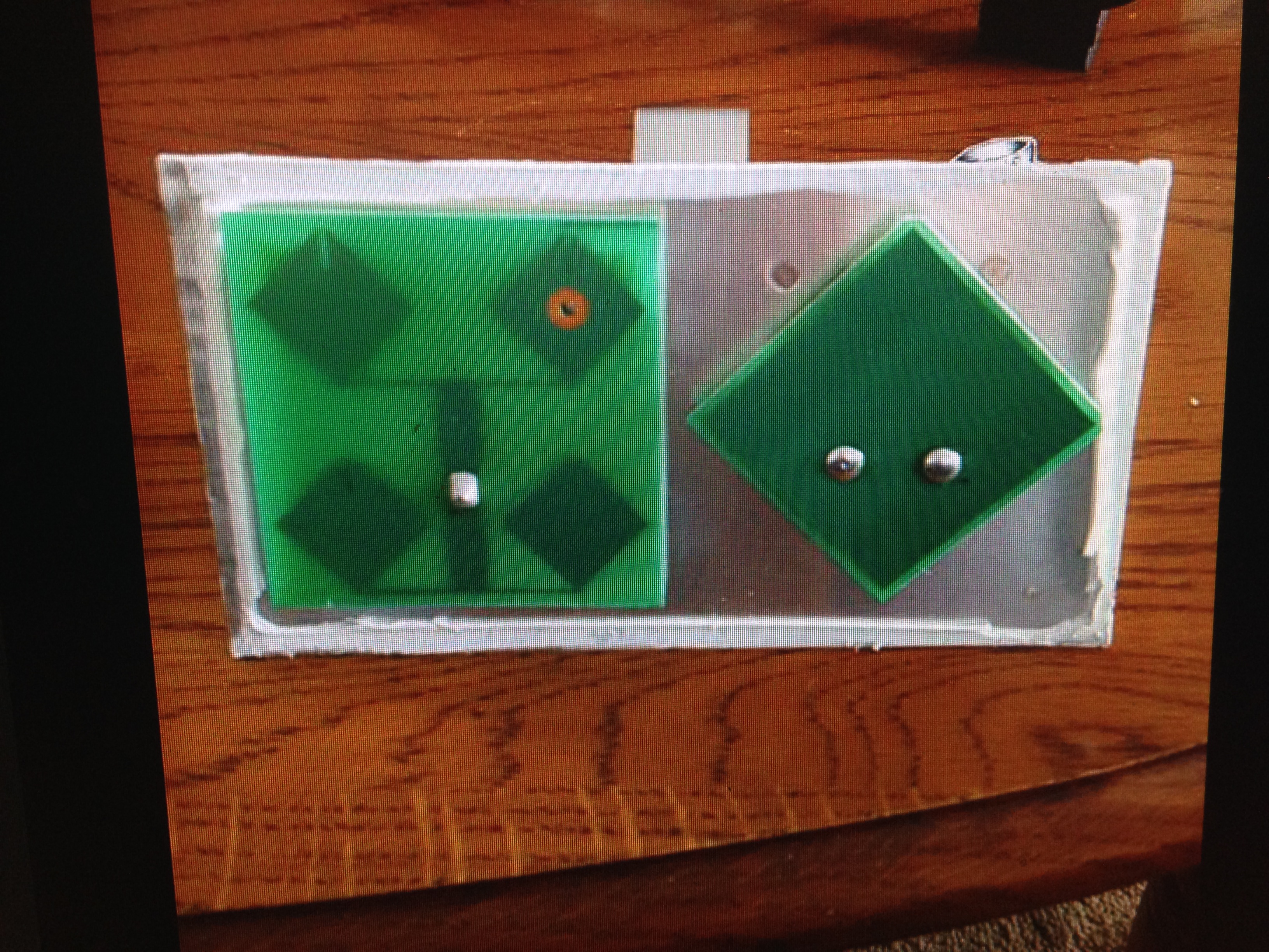

Dirk, judging by the placement of the components and solder connections, that's mine, for sure. Thanks!
Thats interesting. Its identical to the p3s one except the 2.4ghz panel is flipped vertically. Their panels are versatile.

I loved my DBS too, until the dbs mod became loose and I lost distance from the 5.8ghz. I think its a great mod, but there is a problem with it. I think everyone should know about this, before they try to tightening it on. I got 16,000ft with the DBS mod at the beach.

Edit: There are a number of connections. What exactly came loose?

For me, the port 1 & port 2 came loose. Port 3 was solid and never have me any problems.
Do you guys think ITELITE wills till give me a replacement even though I hacked it all up trying to replace it? Or does anyone know if they have experimental panels I can try?
