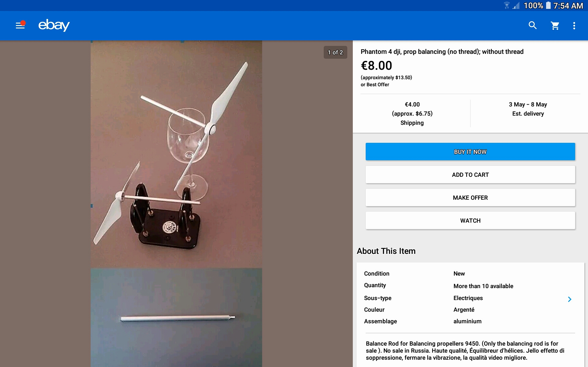

There isn’t a hole through the P4Pv2 prop. How do you balance this type? Do you have a link for one that works with P4Pv2 props?
Can get these on ebay ,,Amazon probly have to,,you could make one aswell if have straight rod
