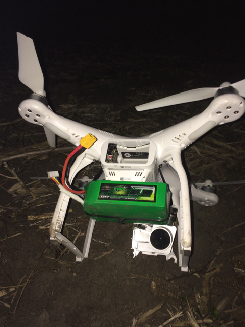

View attachment 51480[/QUOTE]
And here's a couple more that ran out of juice! I've got more of those in storage those are just the ones that are on my phone[emoji41]
Very familiar!
Dropbox - crashes
