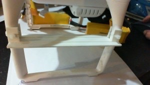

How is everyone mounting there external batts?...does anyone use the CF mount/tray that goes in between the landing gear and bird??
I've used those, but theyre really bulkier than you even need. Now I just tape them on because they sit right in between the legs in a very aerodynamic way and the tape weighs nothing. If you don't like to just tape it on Tom at Midwest came up with a real clever design, a little lander that goes in between the legs that you can rest a battery on
Reactions: GadgetGuy
I've used those, but theyre really bulkier than you even need. Now I just tape them on because they sit right in between the legs in a very aerodynamic way and the tape weighs nothing. If you don't like to just tape it on Tom at Midwest came up with a real clever design, a little lander that goes in between the legs that you can rest a battery onView attachment 54541
See Post 22 in this thread (it's on Page 2) for photos of DB's awesome tape set up! :cool:
Ok tape it is!!
