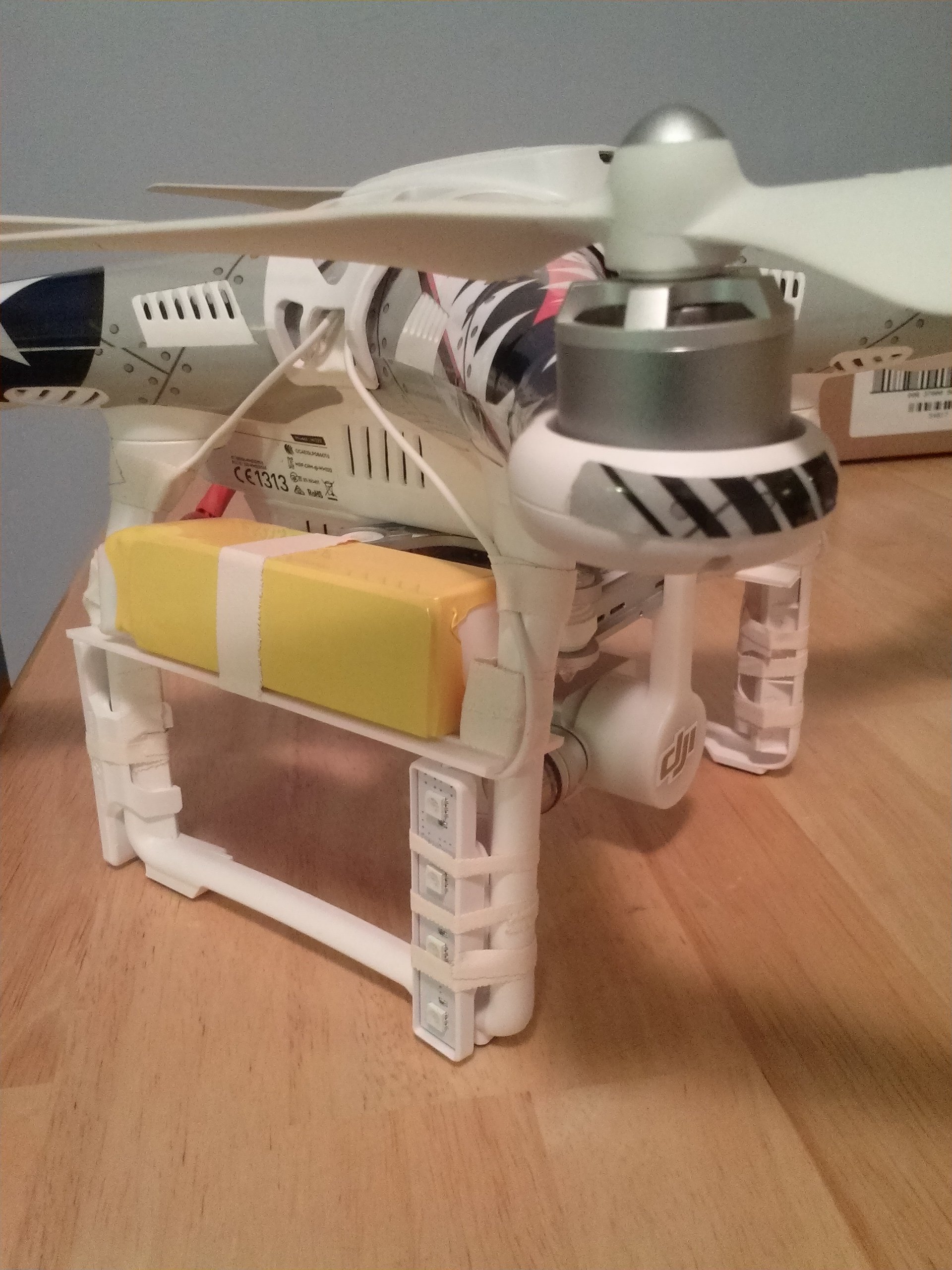

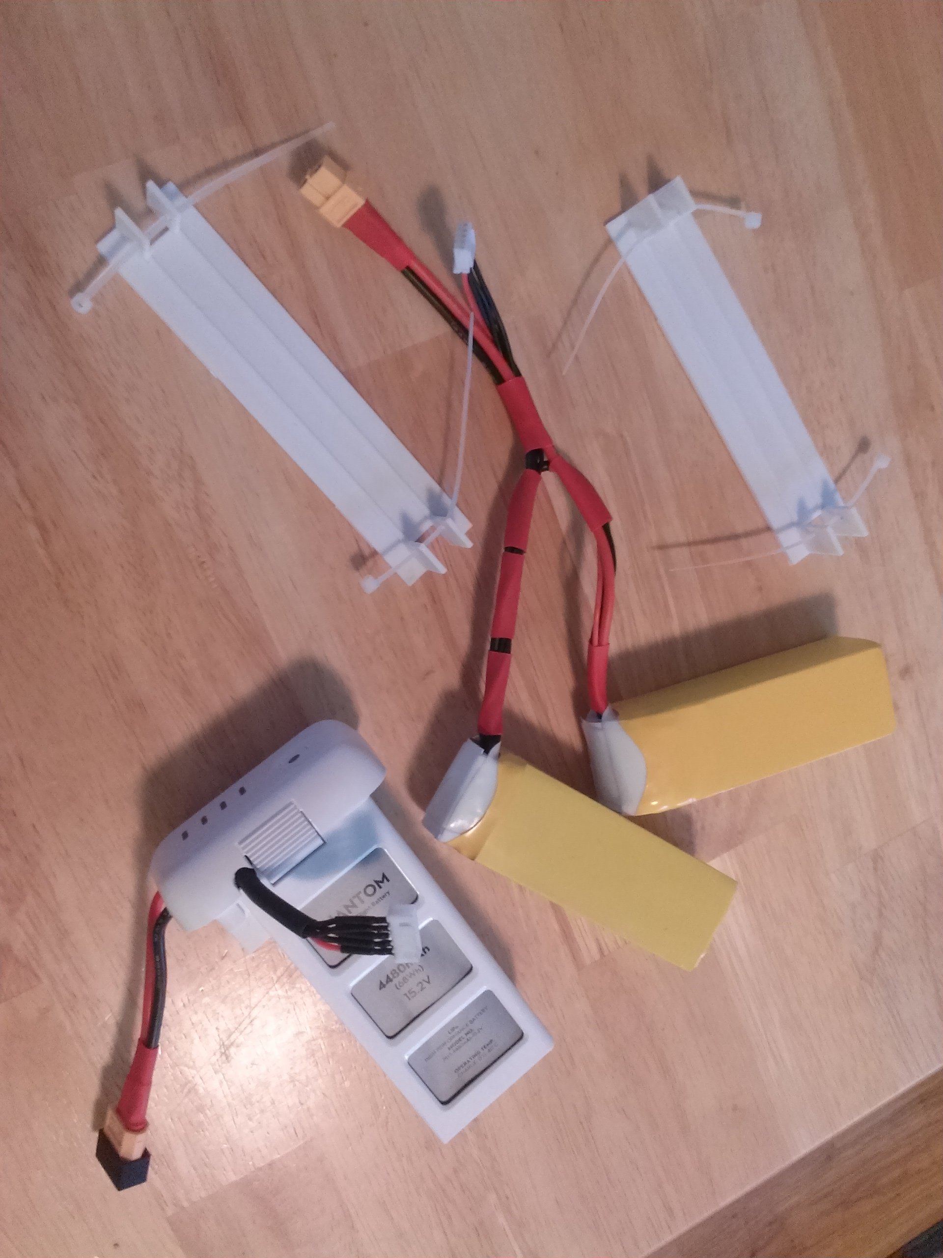

Well, this just arrived! Don't think I'll get a chance to fly it this weekend. Looking forward to this though. I'm really surprised how heavy the splits are! That's a lot of extra weight that I guess the extra juice makes up for. This should be very interesting to see how it goes!

I just received my package this morning, and finished charging the set....
@dirtybum am I supposed to connect the XT connecter as well as the balance connectors during flight?
We've found that the BALANCE connector is only necessary for charging but you can plug it in any way during flight just to tidy up loose ends. Good luck guys keep us posted

I just got a pair in the mail today from Tom, they look just like the ones in your picture, but I aint complainin , they look badass!

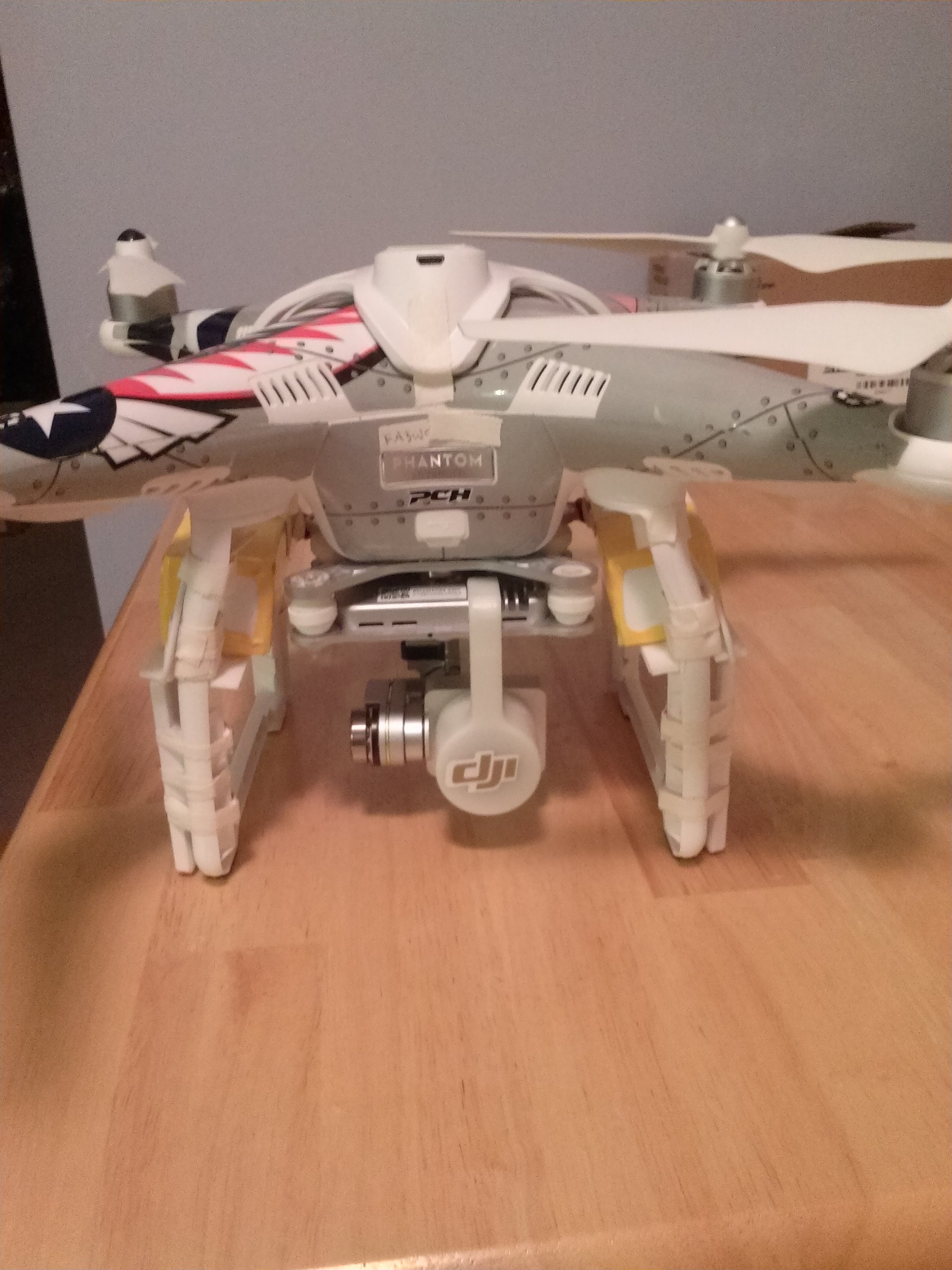

Well at least I got this together the way I want it. It is possible to keep the polar pro led kit on the bird as well, which is cool. I gotta say though man, the extra batteries make the bird seriously heavy. I mean like, heavy. How the heck does this thing fly?! I'm actually concerned about the extra stress on the motors to keep this thing airborne, which has to be a lot. These motors can't be rated to haul this much weight. How could it not shorten their life span? I guess I'll try a flight and see. Having it work out would be great. But all the extra weight makes me more than concerned.
Interesting pics , what's mounted and wired to the upper shell ?
That's the module for the light kit.
Again, we aren't looking for perfect flying characteristics necessary for flying like a crazy monkey. We just need a stable gimbal for photography and FPV. None of the battery mod weight impacts the video stability, and after over 100 flights of 25-30 minures with an extra 500g of externals attached, it hasn't had any noticeable impact on the aircraft. The original W323 P3P rocks! :cool:
I'm gonna take that heavily into consideration because you have the prolonged experience. I'm completely new to it. Picking up the bird and feeling that weight is quite something. Might get a first flight in tomorrow.
It's just a little noisier and once it's underway, it flies fine! It's probably a little sluggish by comparison, but, for video, like the extra weight of a heavy camera body, that keeps everything steadier!
