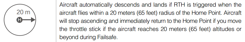

As I have seen in other posts, she lands in place if within 66' at the time. This is undocumented and sickening.
This is documented a few places in the Phantom manual, but it's commonly overlooked. For example:

My mistake. Undocumented is the wrong terminology. I feel that when initiating RTH, the software should give option to RTH or land in place.

I'm still confused. The section you quoted says that it will not RTH if flying within 20 m of HP. It was outside of 20 M of HP but not controller. How can I view/ upload the log for better understanding of what happened?
