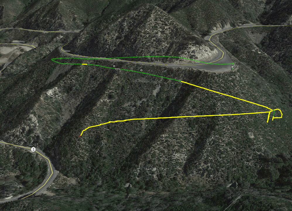

Hi, I was wondering if any of you who are good at analyzing data might be able to tell me roughly where my Phantom 3 Pro landed last week. After 41 mostly uneventful flights, I made a horrible mistake, which I've since learned never to repeat...hindsight is 20-20. At any rate, I was in Angeles National Forest last Saturday after flying my drone successfully most of the afternoon, was down to 18% on my last battery. As my friend and I were heading down the mountain, we saw this amazing sunset and stopped to take some photos of it in a scenic parking area on the edge of a remote canyon. I hoped to get just a few seconds of video with the drone, wrongly thinking that the RTH feature would automatically return it once the battery got too low.
However, the device didn't attempt to return to home. Instead, it went into auto landing mode. I tried to activate the Return to Home feature on the app, but it didn't give me that option. Failing that, I tried to make the drone land close to where the road looped around approximately 315 feet below the launching location, so we would be able to get to it on foot, as much of the canyon is rocky and inaccessible. The drone began spinning around in circles uncontrollably at this point, dropping at about 10 feet per second and then it lost connection with the RC. At this time, it was traveling about 6.5 miles per hour. Its last reading before losing contact indicated it was at an elevation of -147 feet. The starting elevation in the parking area was 4337.3 feet. The elevation at the foot of the canyon was 4022.3 feet. So the drone must have been about 168 feet in the air over the canyon when the log and video communication stopped working. I watched the drone land in an area close to the road. My friend and I raced down to that location and tried to locate the drone using the "Find My Drone" feature, but we were unable to find it. It landed near a dry creek bed in an area covered with dense vegetation.

Phantoms (and other DJI drones) don't attempt to return home when the battery reaches the critically low level (like in this case). They immediately start auto landing to attempt to get the aircraft to the ground before the battery shuts off. That auto landing cannot be cancelled.
The aircraft was only spinning in circles when you were commanding it to do so by moving the left stick to the right -- like this:
If you drag the green circle across the timeline in your log (below the map), you can see the left stick was in that position each time the aircraft started spinning.

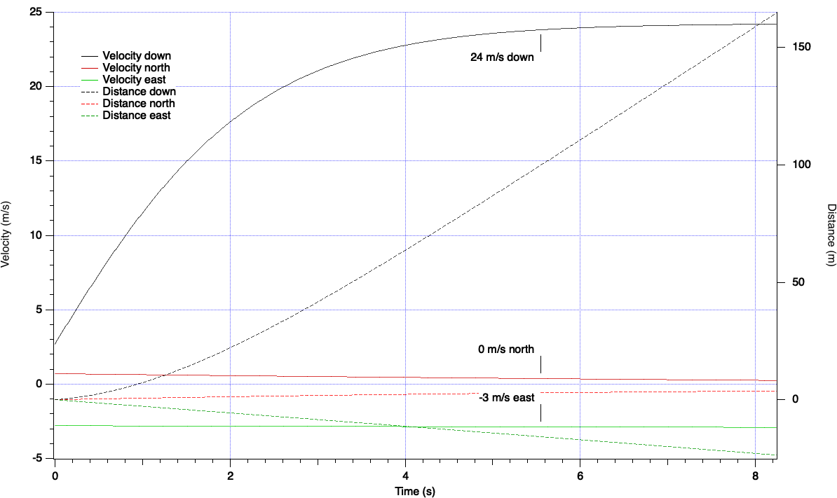

Since the aircraft was too high to be blocked by any obstacles, the battery most likely shut off mid-flight and the aircraft dropped to the ground (instead of landing).

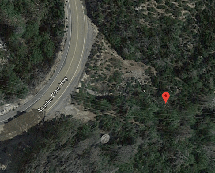

I've gone back several times since then to look for it, searching for hours each time in an area full of bees, biting flies, poison ivy, and most likely a few rattlesnakes, but it's nowhere to be found. The good news is that it's a relatively small area.
The log shows the aircraft was last at 34.26090162, -118.11482415. It of course won't be at that exact spot since it was moving slowly and dropped to the ground. But, you should be able to find it if you start searching from that point.

You missed the warning message at 1:41.2, that told you: Critically Low Power. Aircraft Landing
The drone was 385 feet from the roadway near you and 47 ft higher than the launch point.
Instead of bringing the drone back, you flew it 1650 feet further on a winding path with some very confused and extreme joystick inputs that also caused the spinning you observed.

I did see it come down and disappear from view near that road and it seemed to be descending more slowly than free fall.
I'm wondering if it might have traveled to the side of the hill into that green clump of shrubbery at the top of the second photo, or if, given the last recorded speed of 6.5 mph, it could have made it across the road.

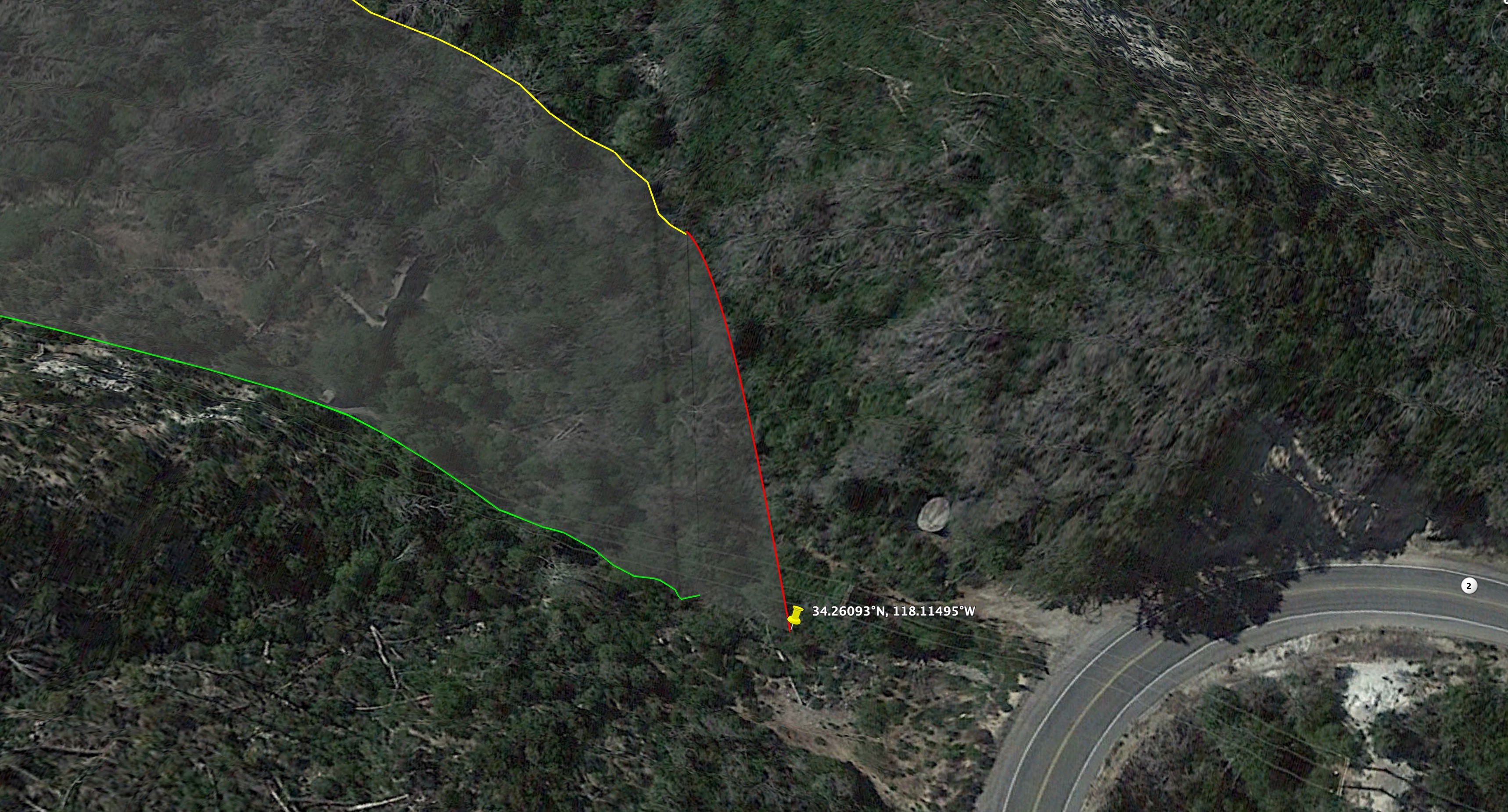

The disconnect was a shutdown, not just loss of signal. Winds are always difficult to model in steep canyons, but based on the initial flight data, the wind was down canyon out of the NE, and in the 5 - 10 mph range. With that estimate, and based on last recorded velocity and position, the descent track should be approximately as shown below:
Thank you, sar104! I appreciate your making the effort to get the wind conditions and showing me this image. I don't know how to get the angles of these maps like you guys are doing. It's interesting that it shut down, as opposed to just losing signal, as I was reading about other cases where the battery was still able to land the drone safely even at 0%. As I mentioned, I combed that area for 6 hours today, and even went up those adjacent hillsides to see if it ended up there, but nothing. I was so disappointed, and sure it was largely my fault, but this evening, I got some great news from DJI: their data analysis showed that (despite my wonky operation of the controls, low-battery flight, and panicked decision-making), that this was a warranty case, and they have offered to provide me with a replacement quad absolutely free! I told them they will have a customer for life.
Thank you, sar104! I appreciate your making the effort to get the wind conditions and showing me this image. I don't know how to get the angles of these maps like you guys are doing. It's interesting that it shut down, as opposed to just losing signal, as I was reading about other cases where the battery was still able to land the drone safely even at 0%. As I mentioned, I combed that area for 6 hours today, and even went up those adjacent hillsides to see if it ended up there, but nothing. I was so disappointed, and sure it was largely my fault, but this evening, I got some great news from DJI: their data analysis showed that (despite my wonky operation of the controls and panicked decision-making), that this was a warranty case, and they have offered to provide me with a replacement quad absolutely free! I told them they will have a customer for life.

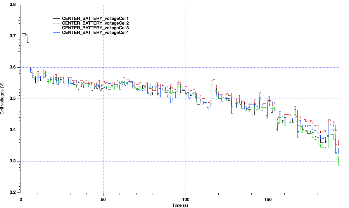

The battery percentage is only an estimate. If you look at the cell voltages you can see that they were collapsing fast. Cell 3 likely dropped below 3.2 V, triggering the shutdown.
