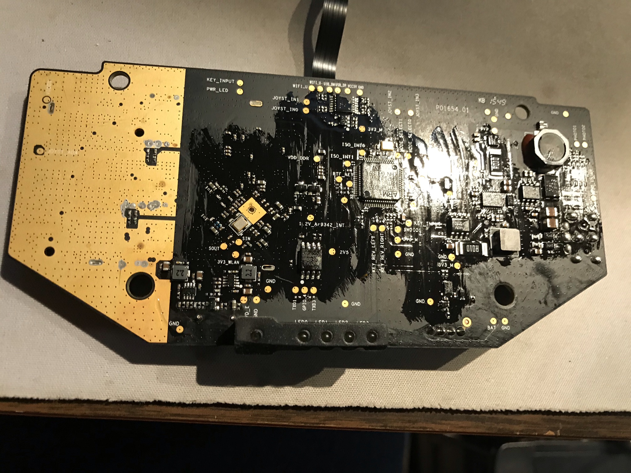

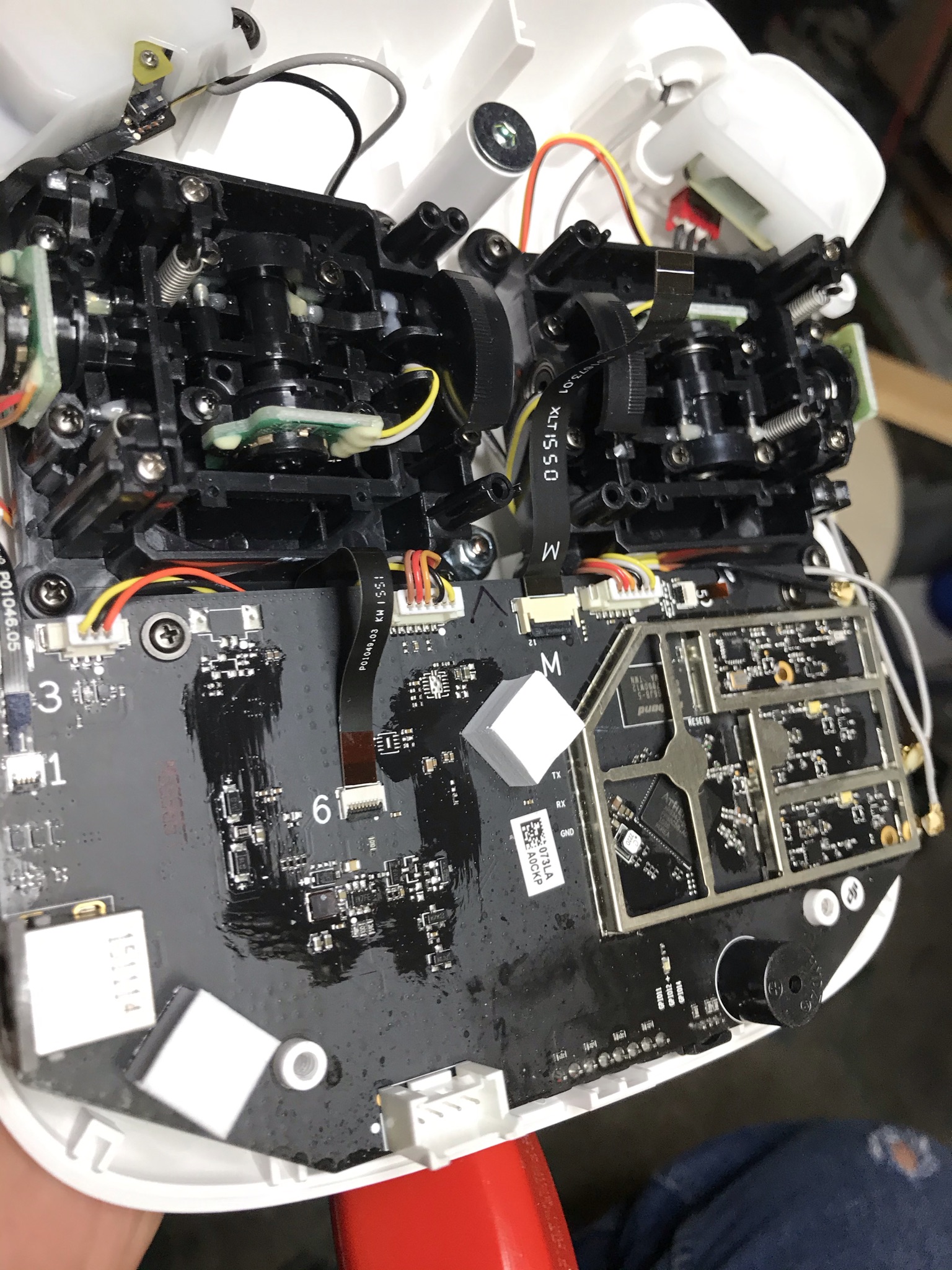

I have looked through all the threads and found nothing on this.
I have two remotes, one generates NO wifi SSID at all, the other will sometimes generate a wifi SSID, but it then goes away. Sometimes it stays around long enough to connect but never long enough to actually do anything in the DJI GO app.
These are both Phantom 3 4K remote controllers GL358WB which as far as I can tell is the only RC compatible with the Phantom 3 4K model.
This RC uses wifi to connect to your phone or tablet for the DJI GO app connection, not a USB cable.
I have two GL358WB remote controls... the one that came with my P3 4K and another I picked up when my original got flakey. As I mentioned the original sometimes shows up in my list of wifi networks on my tablet or phone or whatever device I use to look for wifi networks... but it never stays around long.
The other is no wifi all the time.
The original links to the AC (aircraft) and flies fine. So the basic RC functions are fine. I just cannot use DJI GO to control and monitor and see live video.
I have looked at the printed circuit board (PCB) inside the controller but cannot see any damage or issues, even under a microscope.
I have looked online everywhere for any schematics or info that might help me repair the board.
I haven't seen anyone post anything that indicates any known flaws like solder issues or antenna issues or whatever.
I have brought the phone/tablet VERY close in case it was an antenna issue. Close enough to the RC PCB with the RF shielding cover off that even without an antenna I should see the signal.
Open to any hints about where to get info or where to get replacement boards or anything anyone has that might help repair these two RC units.
