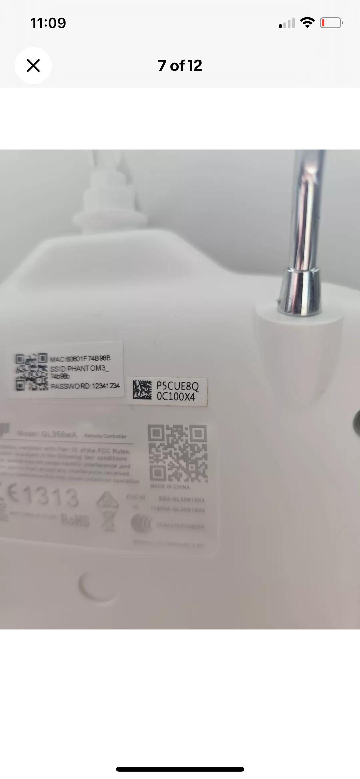

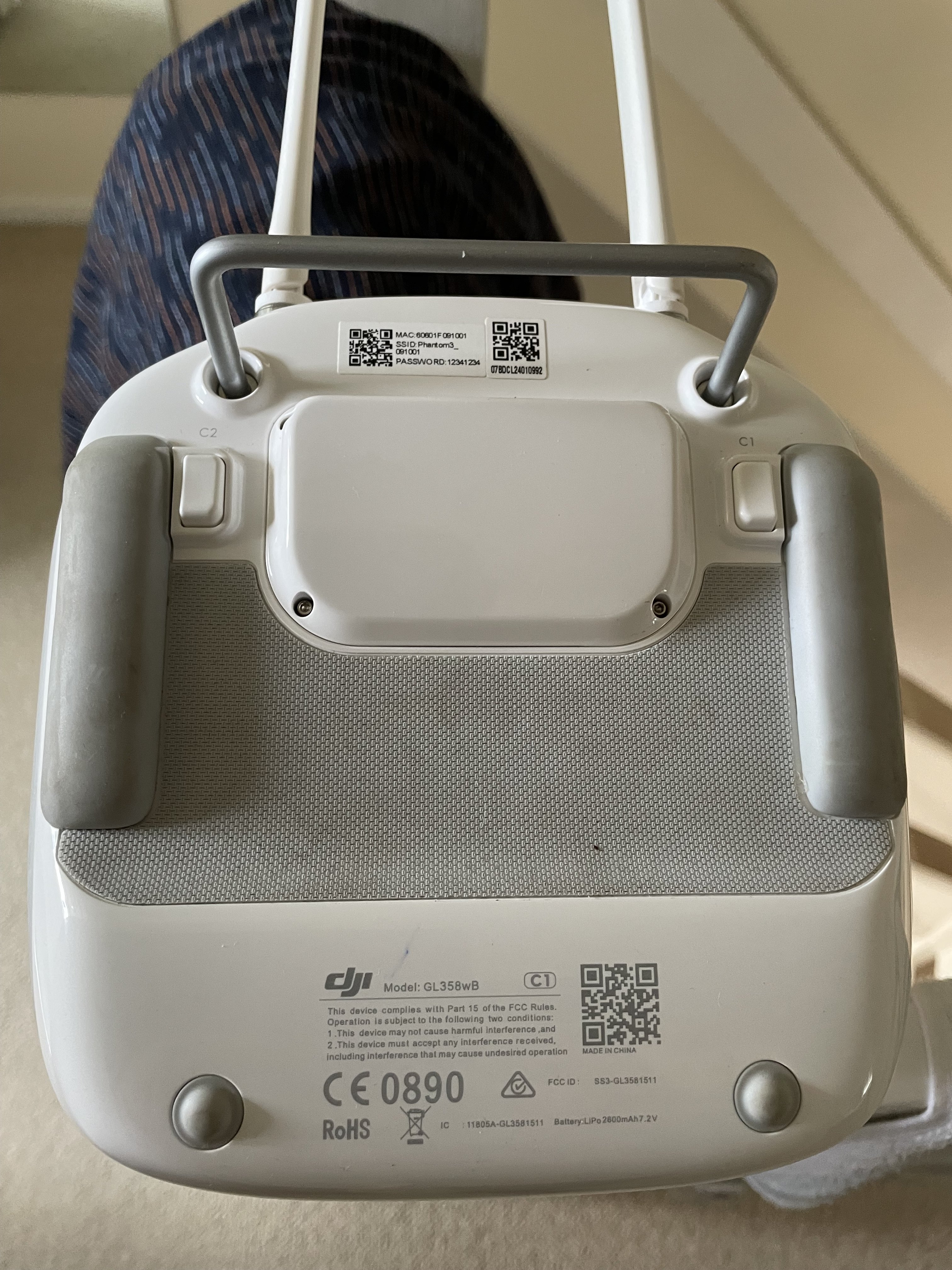

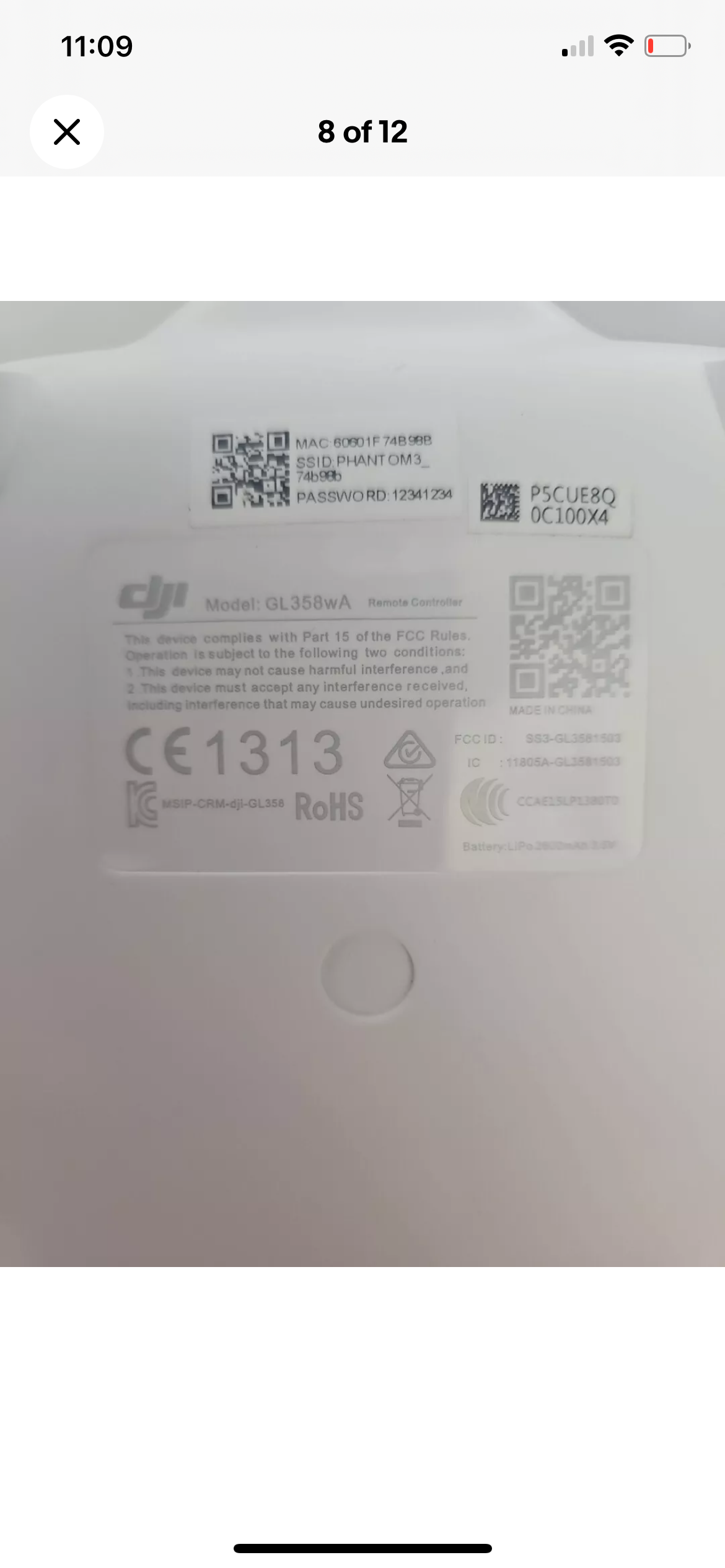

I am referring to the model numbers on the back of the controllers. The one I have has two antenna, the one I found on Ebay has a single antenna (as for a Phantom 3 Standard). My question remains would a single antenna controller control a Phantom 3 4K given that USB wire and a WiFi connection is required when using the twin antenna controller.
Photos 2 and 3 Screenshots from Ebay of a single antenna controller with the model number GL358WB and Photo 1 my twin antenna controller also with the model number GL358WB.

Above, you stated the model number is the same. However, from your screenshots, you can see the models are actually GL358WA and GL358WB.
GL358WA is for the Phantom 3 Standard.
