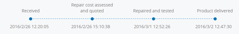

Update:
So far I am very surprised by how Quickly DJI has responded. Here are the sequence of events so far:
Now we will see how long it takes them to ship it back.
Well that was fast.... I don't have the Phantom yet but it is already on it's way, Tracking number provided. Very impressed with DJI, only a 1 week turnaround which was unexpected after all the horror stories I've heard:
